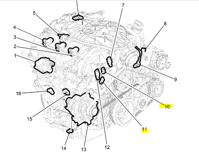

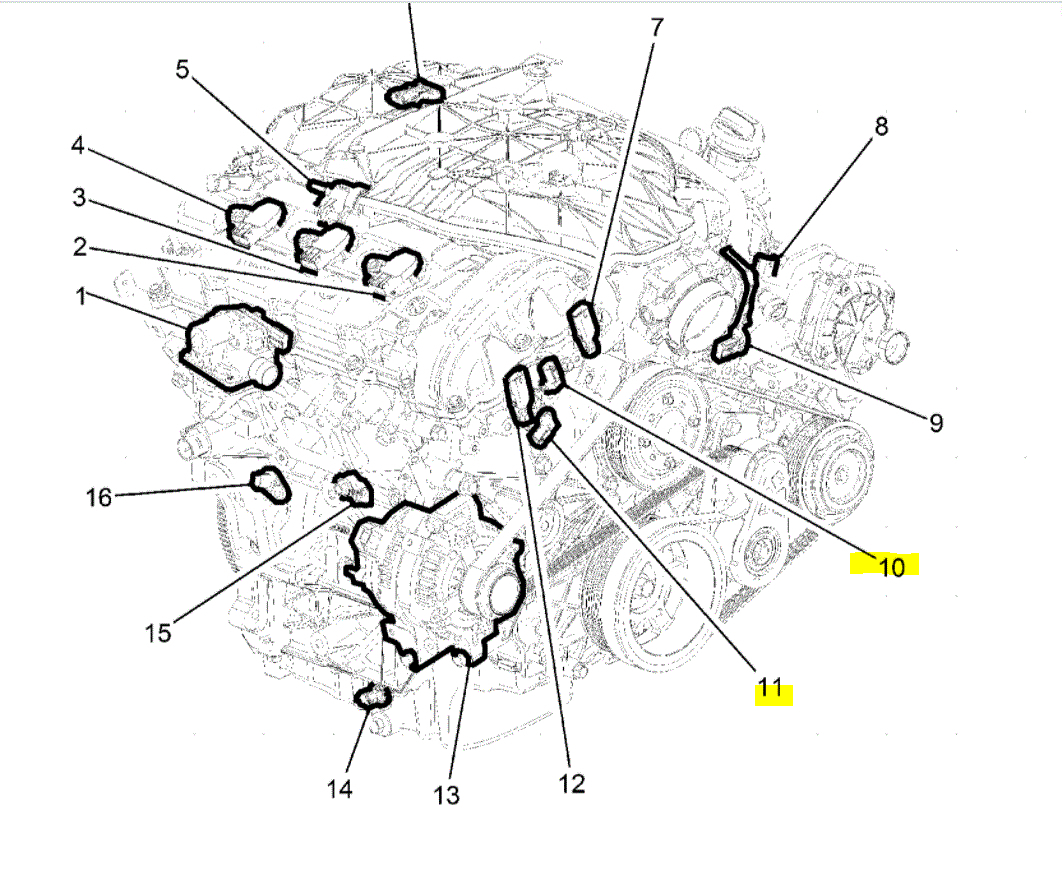

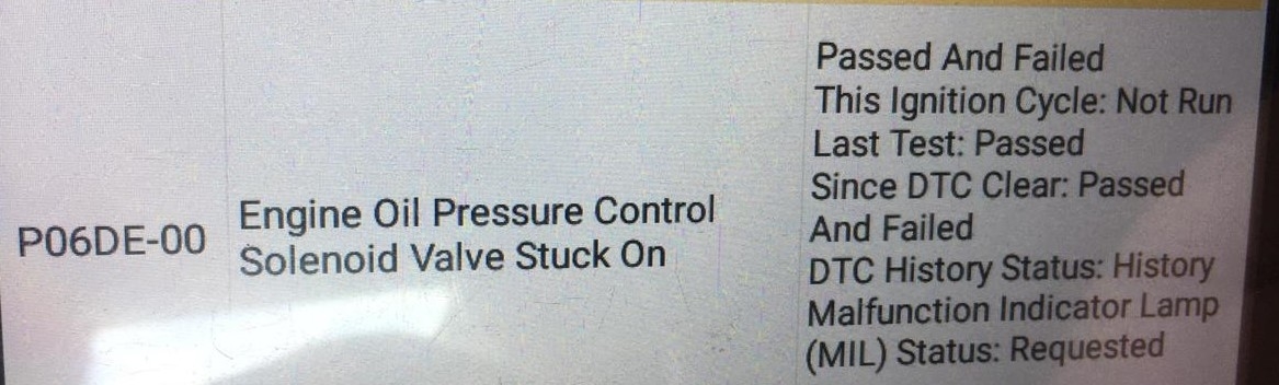

hello Joe, i have the same car too, 2013 ATS Cadillac 2.5. I am having same issue "Engine Power reduce" light came on i scanned it and it is giving me codes P06DE. how do i fix it? i Googled around it saying Engine Oil Pressure Control Circuit Stuck On... any idea how to fix this?
Mar 10, 2021 at 12:12 AM
  • 110,244 POSTS
The code indicates the pressure control valve is stuck on. It could be a mechanical issue or electrical. When the engine is running, is there any ticking or knocking coming from the engine? If there isn't I need you to check the connector highlighted in the attached pic.
Let me know if the oil light stays on with the engine running too, the number of miles on the engine, and if the oil has been changed on a regular basis.
