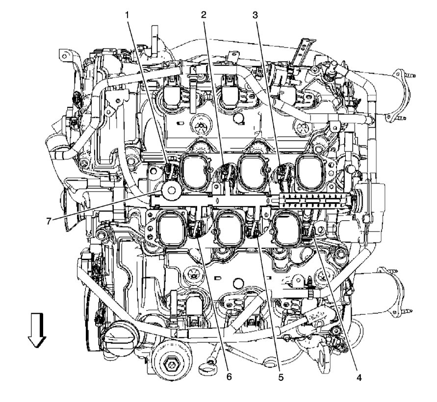

Engine lost power and can't accelerate more than 40 miles. i have the check engine light on codes:
P0091
P0113
P0355
P2228
May 28, 2019 at 8:25 AM
  • 55,433 POSTS
Lets solve the first code and the rest should go away, if not you may have a bad PCM. The first code is code the fuel pressure sensor, lets replace it and clear the codes here is the location #7.
Part#
Sensor 12618108 $107.51
How to clear codes video:
https://youtu.be/ahK_eucFi-k
