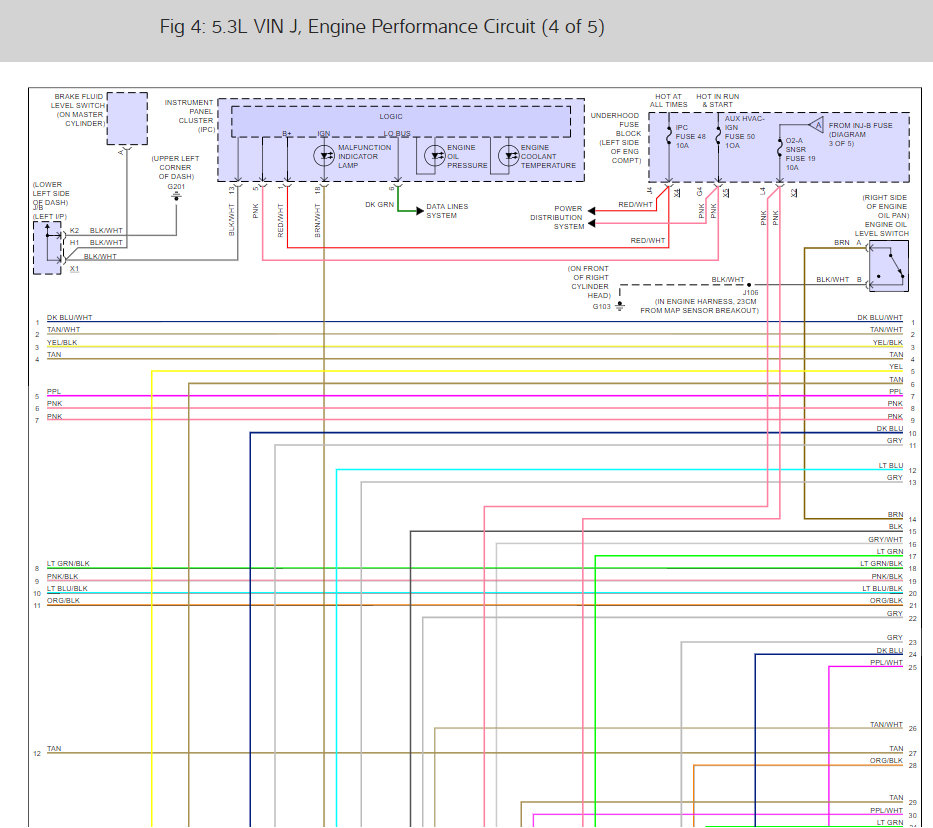

Truck went into engine power reduced while driving down the road. Truck cranks and runs, but no throttle. Changed throttle body, no help. changed accelerator sensor, no help.

Yes truck was scanned. I do not have the exact codes. But the mechanic said it was saying throttle position sensor. But that was all replaced. so far throttle body replaced, accelerator sensor,computer (PCM). When I turn the key on I lose dash lights, but not dome lights. I have not replaced battery, but I have kept it on charge.

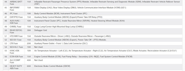

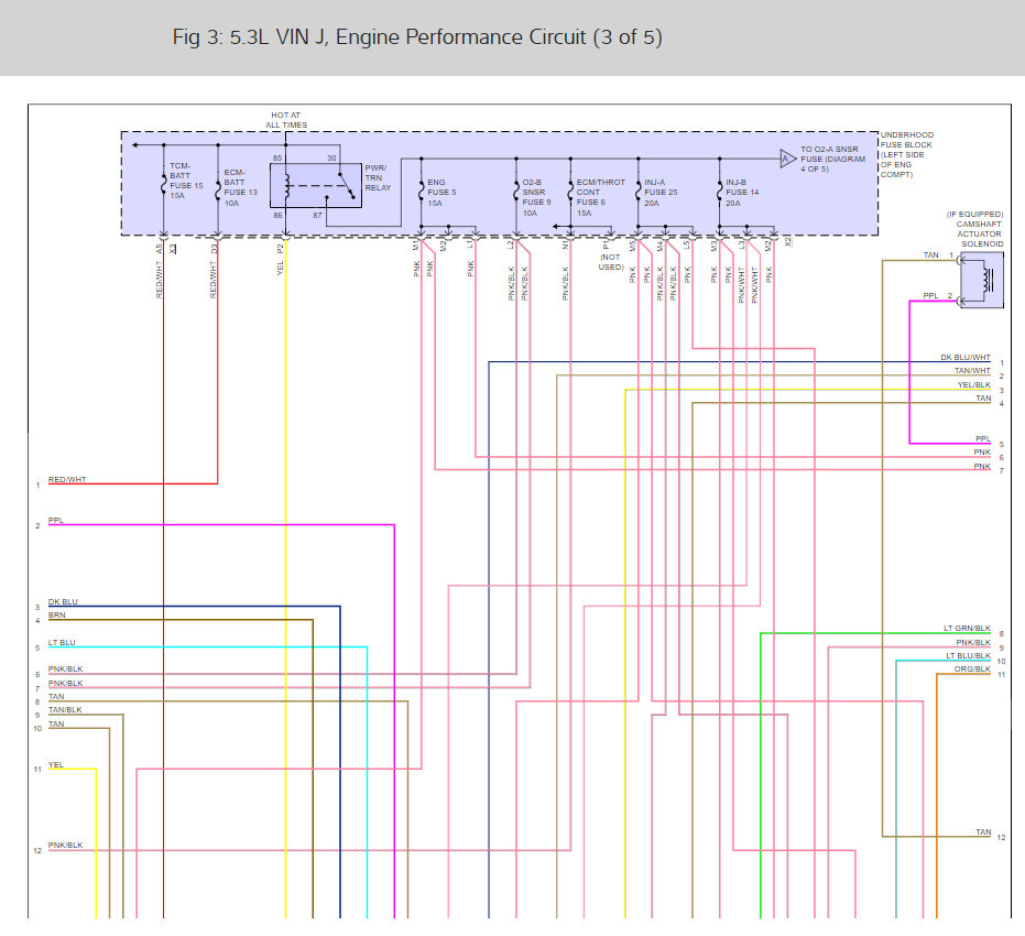

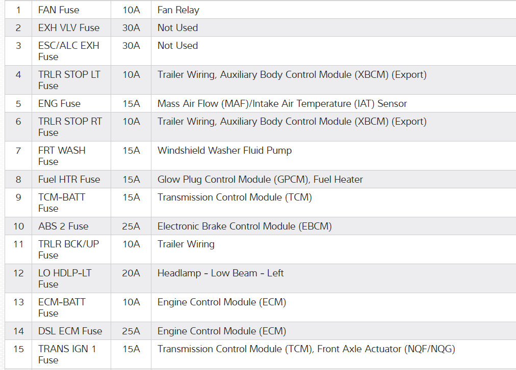

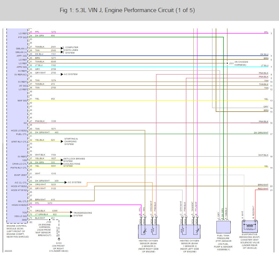

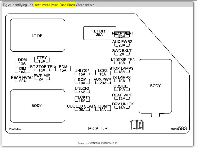

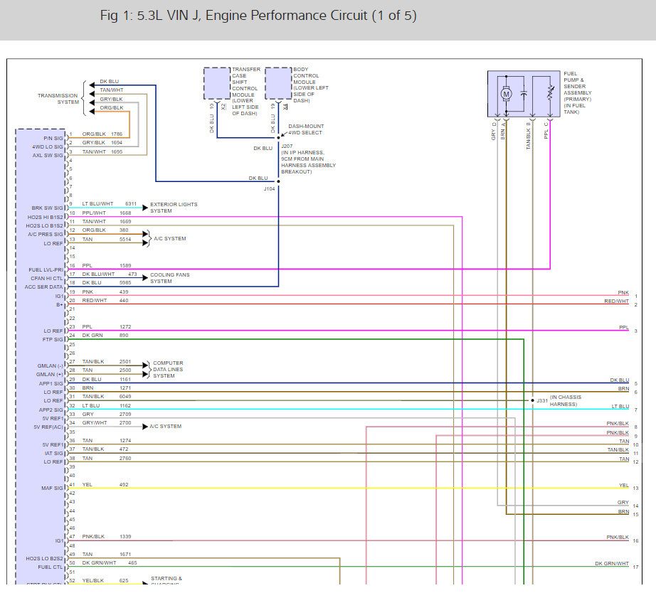

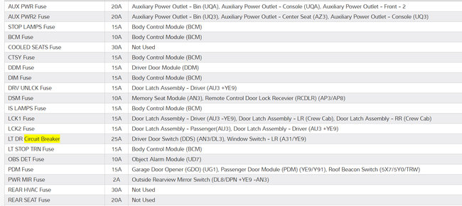

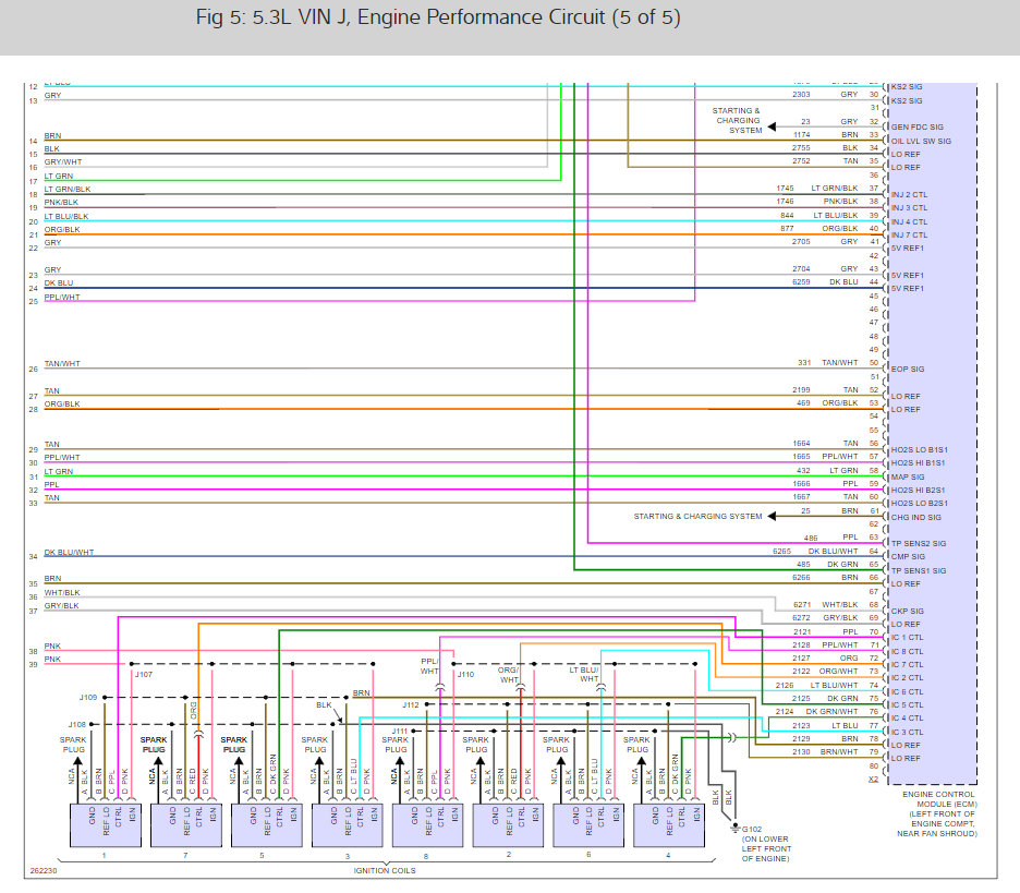

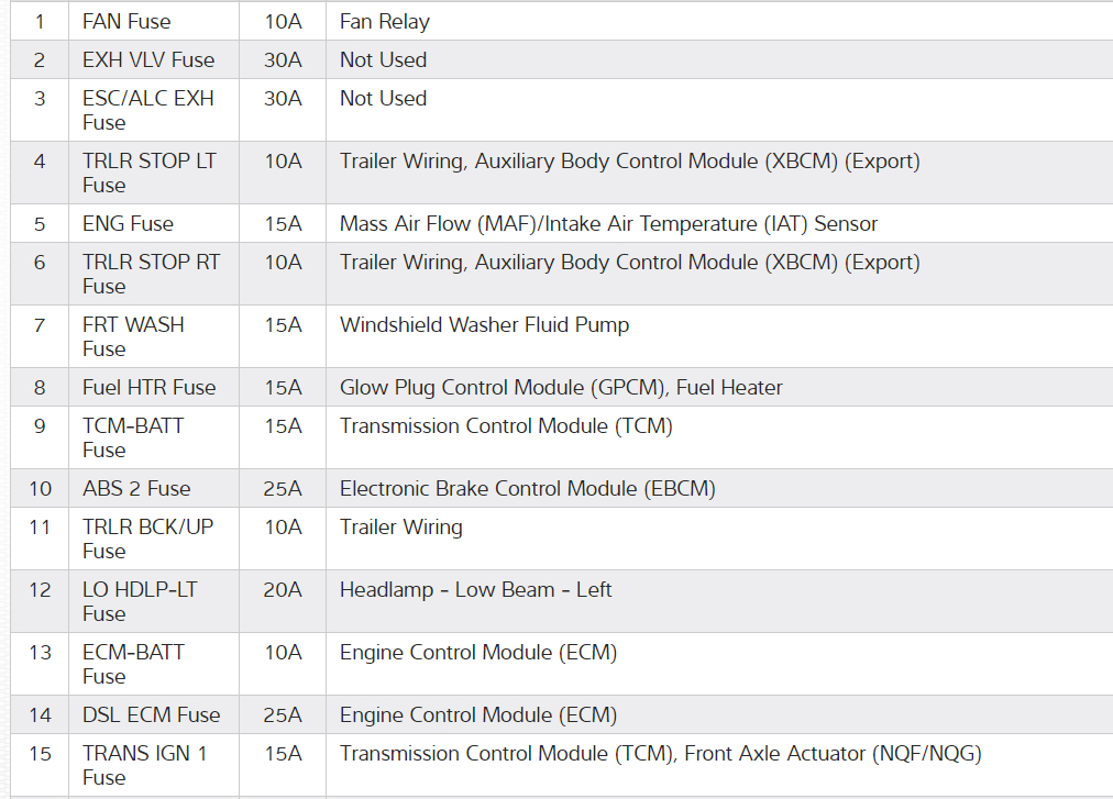

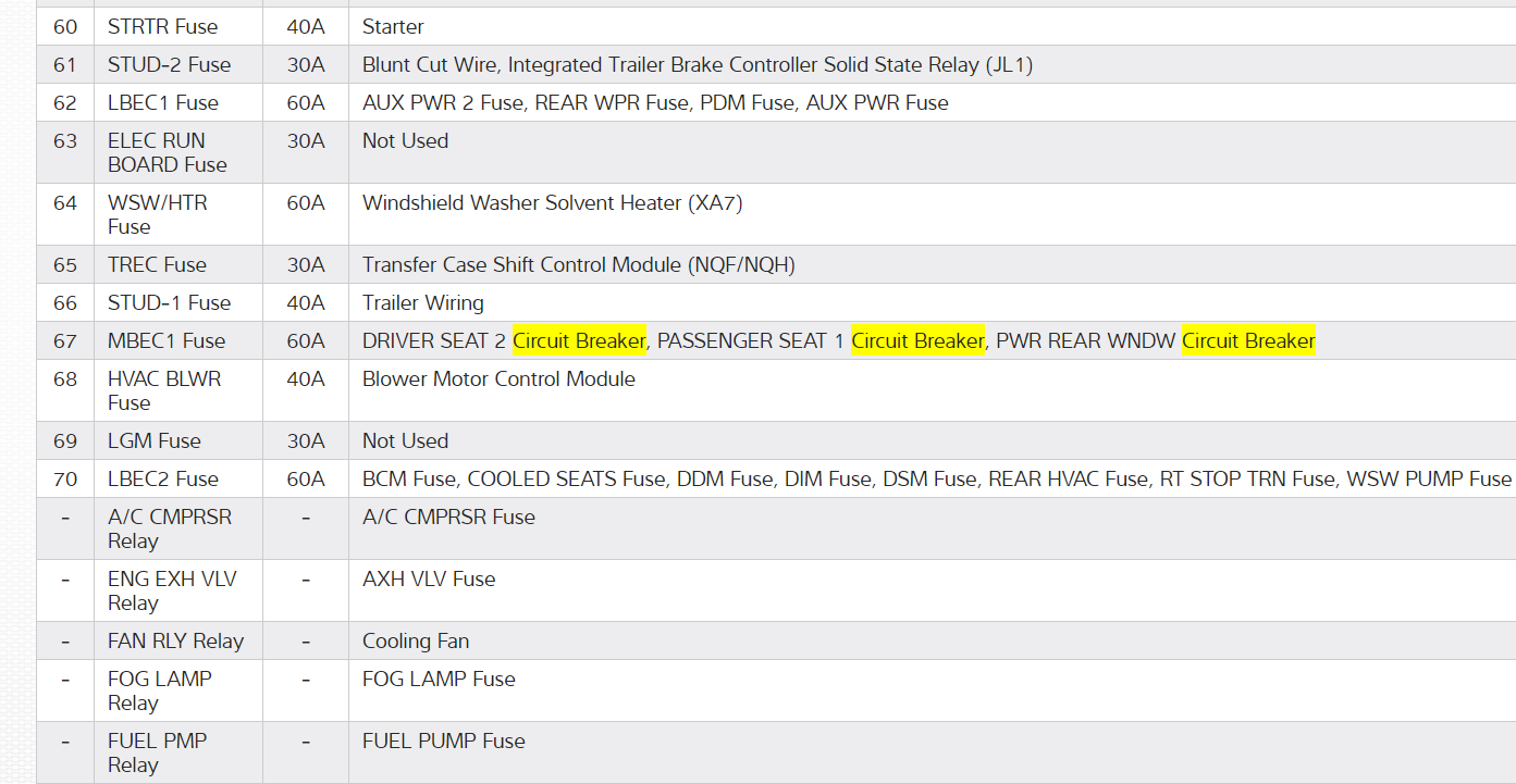

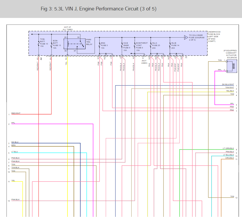

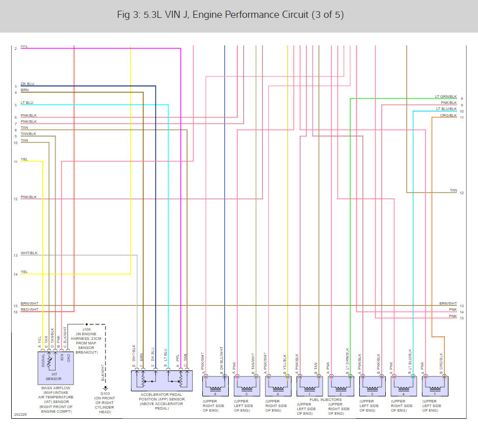

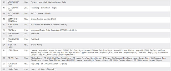

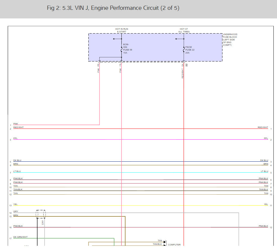

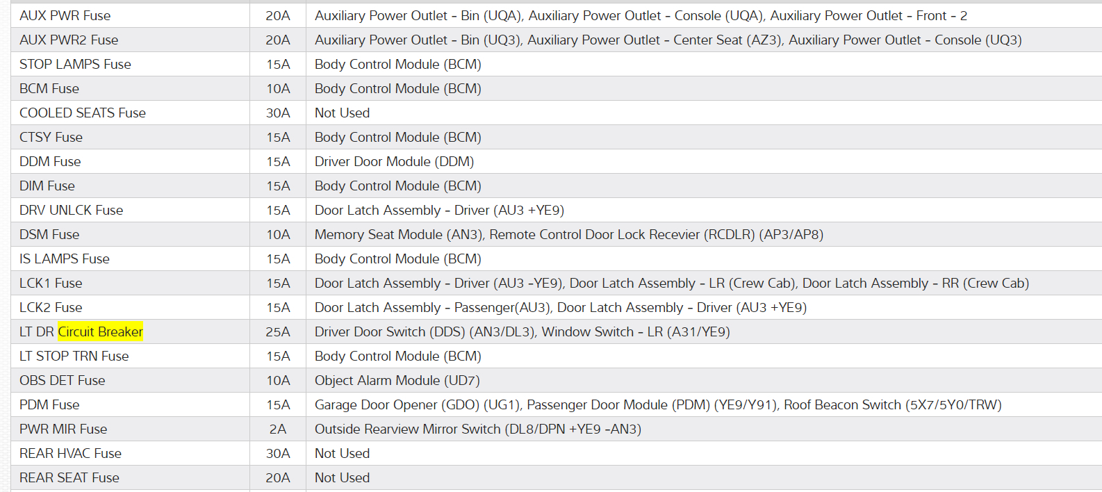

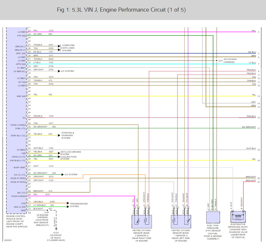

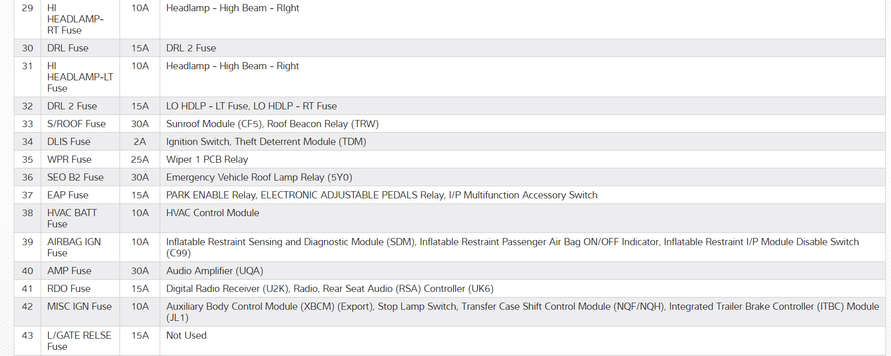

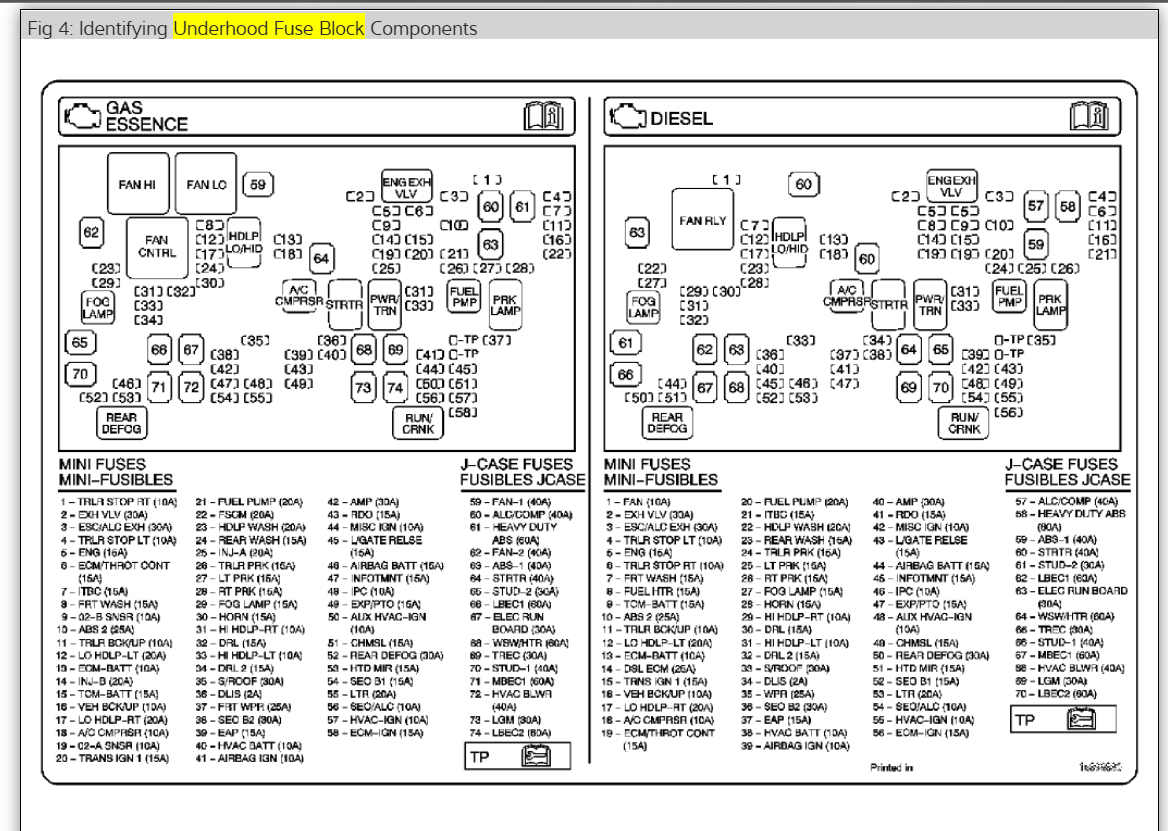

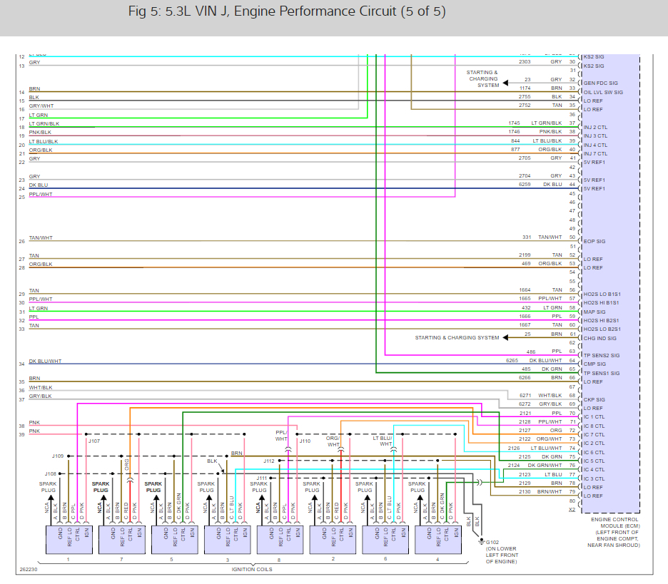

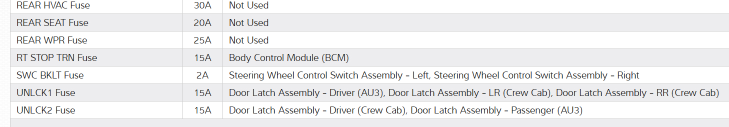

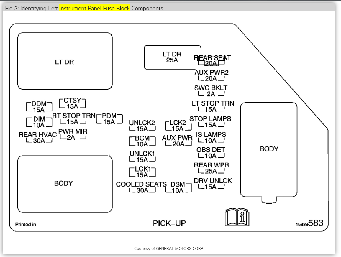

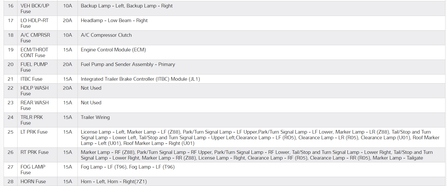

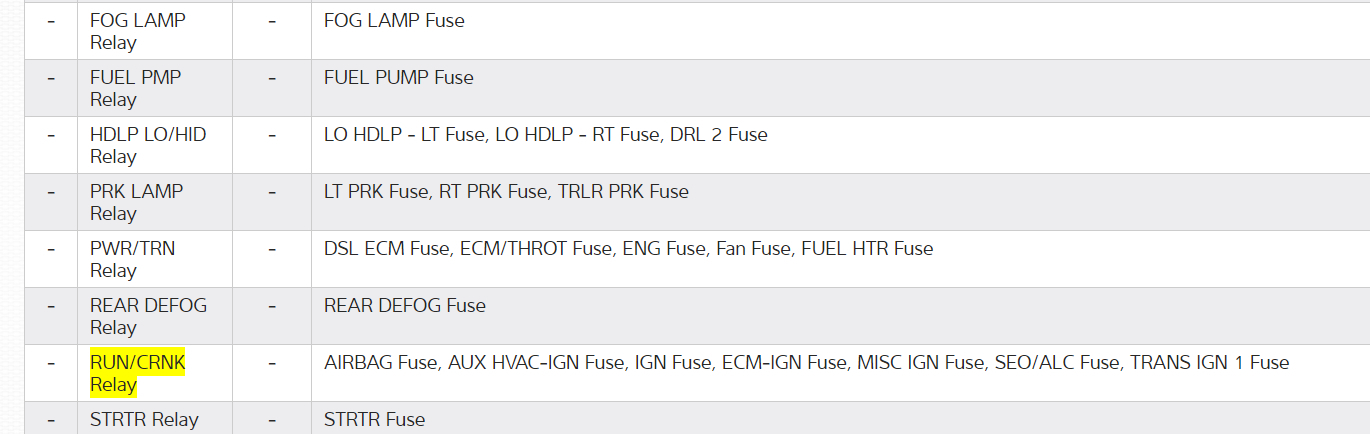

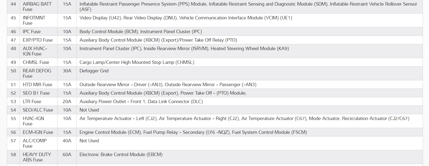

It sounds like you have lost a power feed into the PCM which there are 11 fuses and one PWR/TRN relay that need to have power when the car is on.
Here are two guides to help us do some simple testing:
and
(Check out the fuse panel engine wiring diagrams below)
Please run some tests and get back to us.

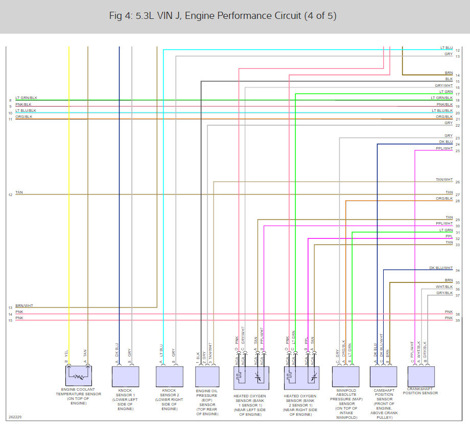

Thanks for the help guys. It turned out to be a bad oil pressure switch. It Is not easy to get to, but at least it is running.
