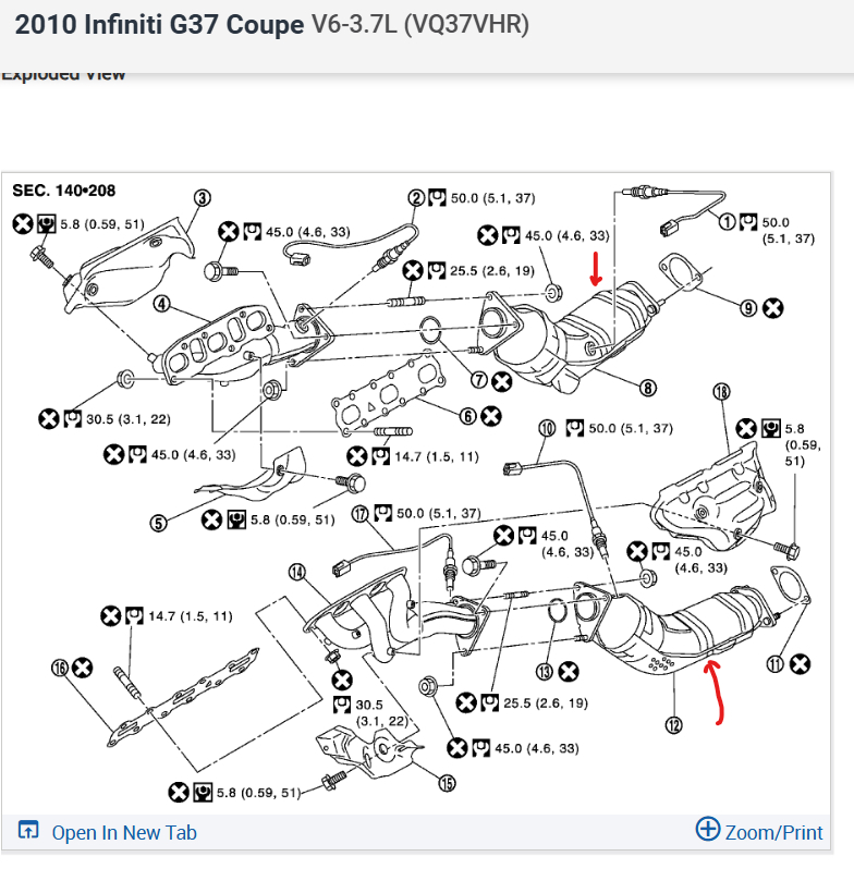

This happens when one of the catalytic converters gets clogged, the engine has skipped time, or the MAP sensor or fuel pump is bad. Let's run the codes for clues of what the problem can be, so we can go from there. Here are two guides, please go over them and get back to me.
and
https://www.2carpros.com/articles/engine-has-low-power-output
You might what to use a rubber mallet and tap the exhaust system to see if you can hear anything rattling inside just behind the cats. Check out the images (below).
