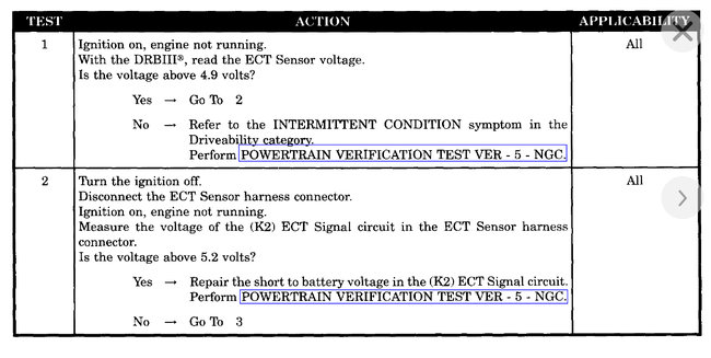

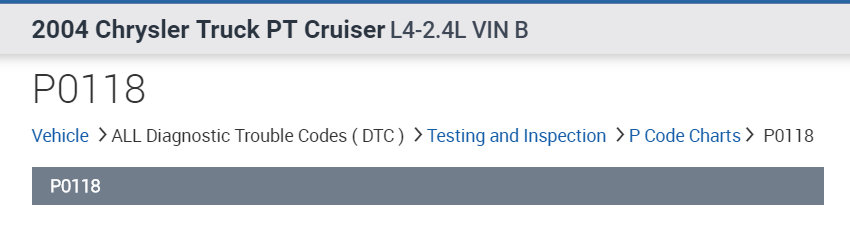

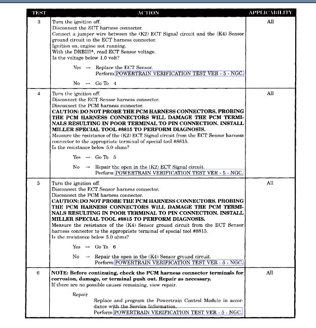

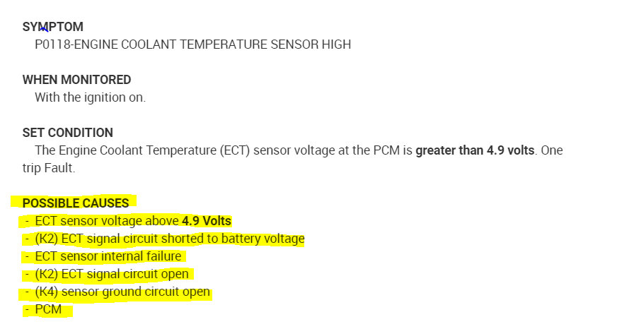

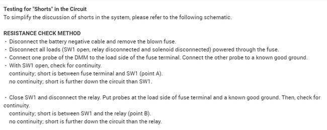

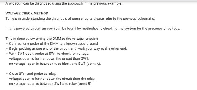

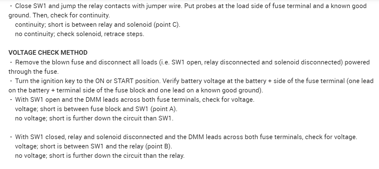

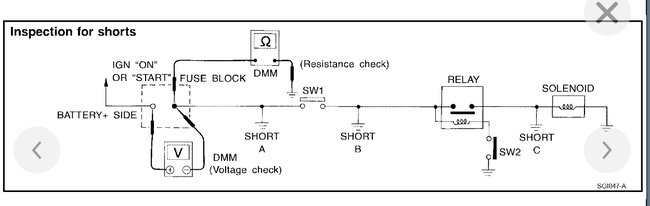

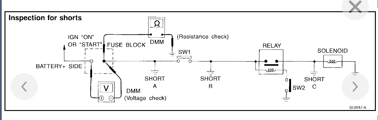

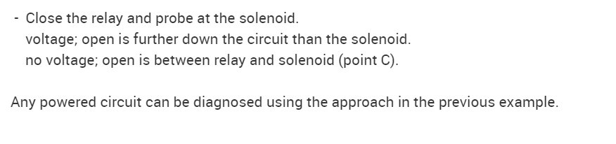

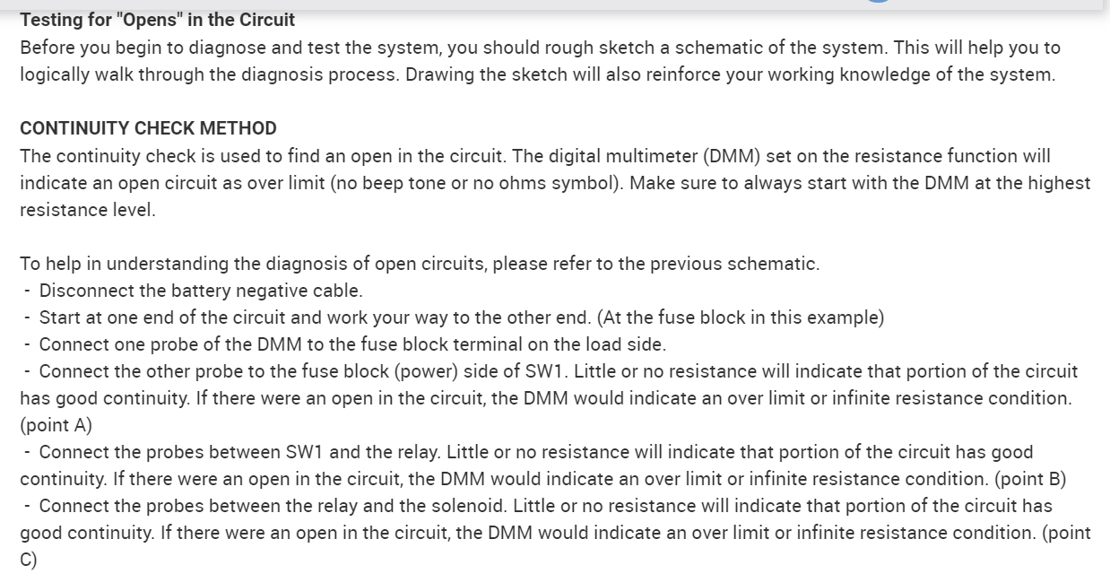

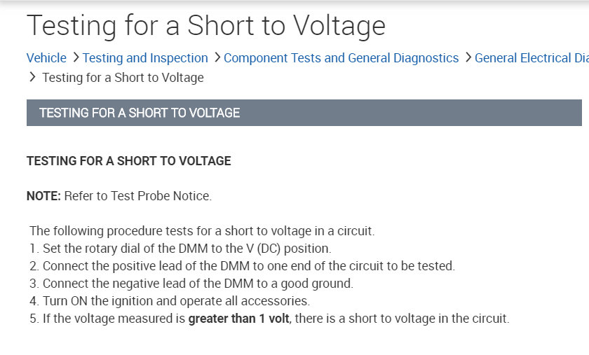

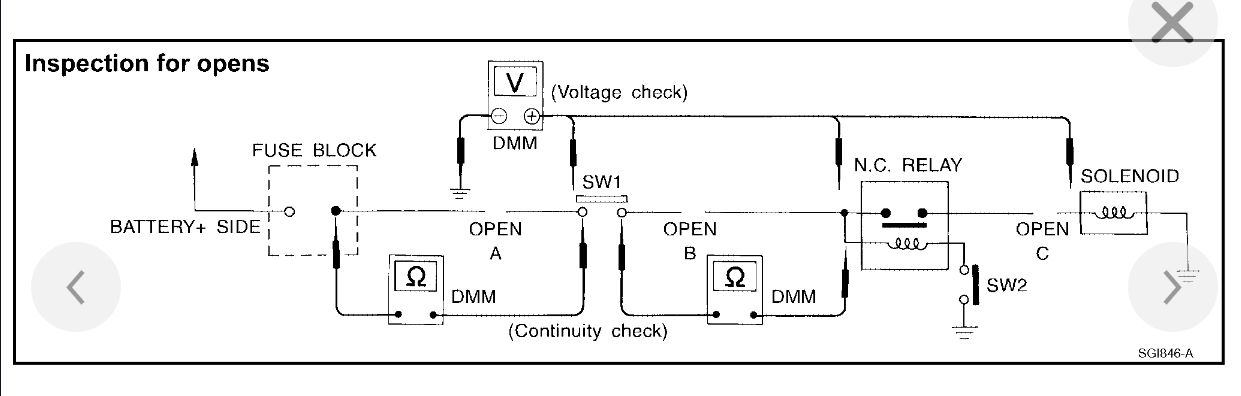

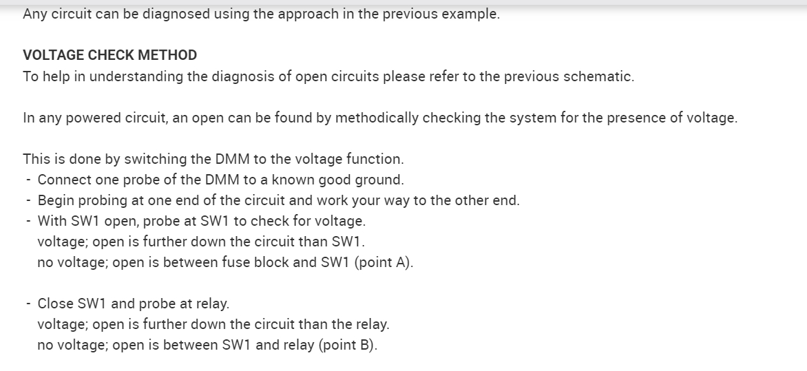

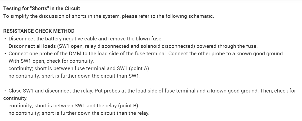

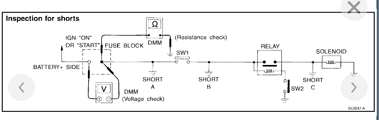

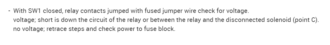

You will need to recheck codes P032 and P038. The format for Direct Trouble Codes (DTC)(s) is a letter followed by four numbers. Also, I show no listing for DTCs P0400 or P0502 in either one of our reference guides, but I have included the factory diagnostic troubleshooting guide for DTC P0118 in the diagrams down below. You will need to use a digital multi-meter for these tests. Here is a link describing how to use one if you are unsure on how to do it:
I have also included guides on how to find a short to ground, a short to power and an open in an automotive electrical circuit for you in the diagrams down below for you as well. Please go through these guides and get back to us with what you are able to find out.
Thanks,
Alex
