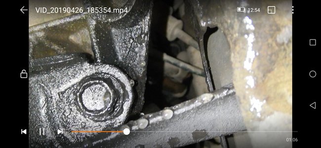

WODMAY
  • 13 POSTS
This is the water leakage sample taken from below the car.. The leakage starts after driving car for fifteen minutes until then the car behaves totally normal.
Apr 28, 2019 at 5:26 PM
It sounds like the engine is actually overheating and then the leak is a result of the boil over caused by the overheat. It is unlikely that the leak that doesn't take place right away could trick the sensor into thinking it is hotter then it is. Any time you are boiling over coolant, it is because there is excessive heat and the coolant expands to the point that it pushes out the weakest point which is usually the radiator cap/over flow bottle. If there is a leak in a pipe then this could be the weakest point so I would start with identifying excatly where the coolant is coming from when it overheats and repairing it if it is a broken component. Then drive the vehicle again, and see if it still overheats.
My opinion based on this info is it sounds like you have two issues. Maybe a pipe of some hose that is leaking and then an engine that is overheating. Even if you fix the leak, you may still have the overheat issue.
Keep me posted on what you find. I am interested to see what this root cause is. Thanks
Apr 29, 2019 at 4:04 AM
