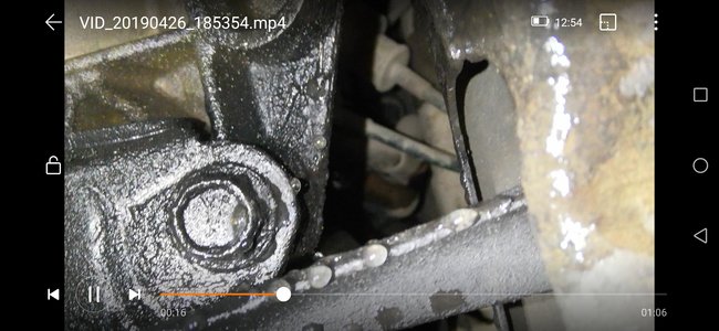

This is the water leakage sample taken from below the car. The leakage starts after driving car for fifteen minutes until then the car behaves totally normal.

It sounds like the engine is actually overheating and then the leak is a result of the boil over caused by the overheat. It is unlikely that the leak that doesn't take place right away could trick the sensor into thinking it is hotter then it is. Any time you are boiling over coolant, it is because there is excessive heat and the coolant expands to the point that it pushes out the weakest point which is usually the radiator cap/over flow bottle. If there is a leak in a pipe then this could be the weakest point so I would start with identifying excatly where the coolant is coming from when it overheats and repairing it if it is a broken component. Then drive the vehicle again, and see if it still overheats.
My opinion based on this info is it sounds like you have two issues. Maybe a pipe of some hose that is leaking and then an engine that is overheating. Even if you fix the leak, you may still have the overheat issue.
Keep me posted on what you find. I am interested to see what this root cause is. Thanks

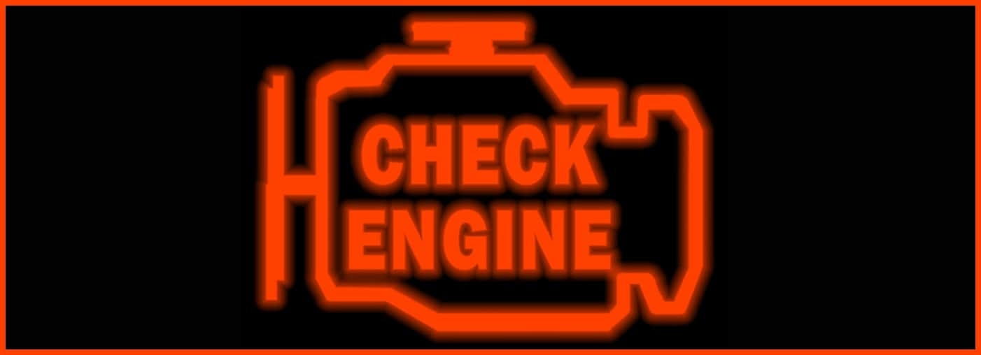

Can you get a picture of the light that comes on after driving? That will help make sure we are on the same page.
As for the fan running all the time, that may be a default when there is a problem with the wiring or sensor. If it can't determine whether to turn it on or not, it will just turn it on to be safe.

This one first lights up.

This following the first on.
Sunday, May 5th, 2019 AT 2:39 AM
Okay. If the car is not actually overheating any more (or never was) but these are the lights that are coming on, then the PCM thinks it is overheating. In my mind, that is only a temp sensor.
This would mean it could be the sensor, wiring, or the module. See below for info on the sensor and how to test wiring. Then a video that is a little long winded but shows how to test a temp sensor. If you want just jump to 6:30 minute mark.
