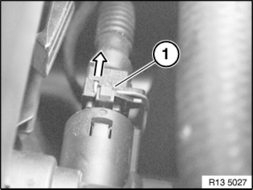

There is plenty of coolant with no leaks. I bled the system so the water pump is working but my fan only seems to come on when the AC is working. So the fan is working, but is there some sensor somewhere that tells the fan to come on when the engine gets hot? If so, where and what is it? Or can it be something else? Can the thermostat have something to do with this? Any suggestions?

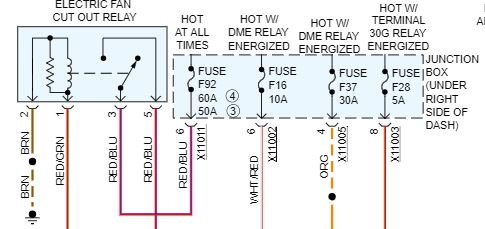

Also, here are a couple things you could check if you feel it is a fan issue. Check fuses F92 and F28. See attached picture 1. Also, in the same location is the electric fan cut-out relay. If there is another relay with the same part number, switch them to see if it makes a difference. Or, here are the directions for checking a relay.

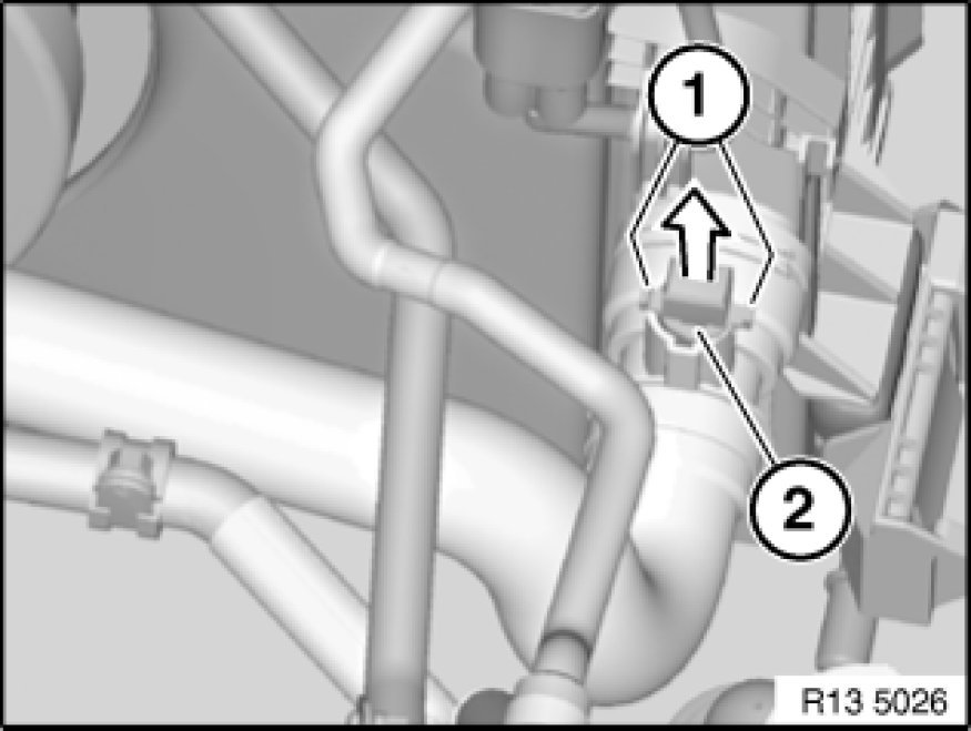

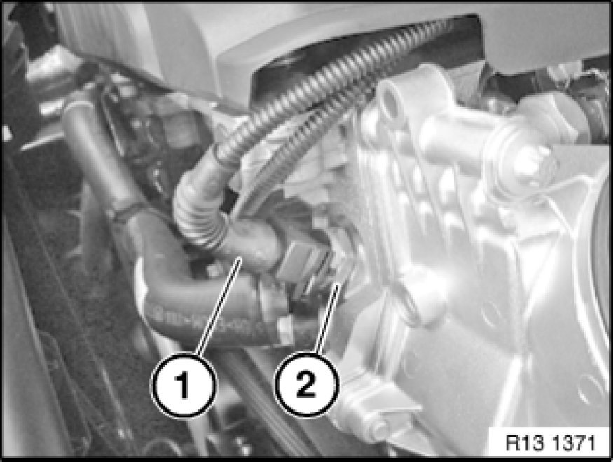

Also, check the radiator output temperature sensor's connection for corrosion. Picture 2 and 3 shows its location. Also, check the temp sensor on the right side/front of the cylinder head. Make sure wiring is in good condition with no corrosion. Picture 4 shows its location.
