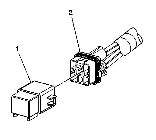

Our vehicle is overheating and the fans are not coming on. Replaced them today and it still happens. The new fans are not working either. We also replaced the thermostat and temperature coolant sensor last year.

Hi and thanks for using 2CarPros.com. It sounds like you may have a problem with the fan relays. Here is an overview of what they do. It may seem confusing, but I want you to understand their functions.

Now, the proper way to check the relays is to use a scanner and prompt them on to see if they send power to the fans. However, chances are you don't have a scanner which can do that. So, here are general directions of how to check a relay.
Here are directions for removal and replacement:

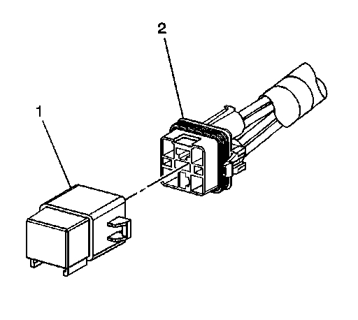

RELAY REPLACEMENT (ATTACHED TO WIRE HARNESS)
REMOVAL PROCEDURE
Locate the relay.
Remove any fasteners which hold the relay in place.
Remove any connector position assurance (CPA) devices or secondary locks.
IMPORTANT: Use care when removing a relay in a wiring harness when the relay is secured by fasteners or tape.
Separate the relay (1) from the wire harness connector (2).
INSTALLATION PROCEDURE
Connect the relay (1) to the wire harness connector (2).
Install any connector position assurance (CPA) devices or secondary locks.
Install the relay using any fasteners or tape that originally held the relay in place.
The relay box on your vehicle is located under the hood in the power distribution box. Open the lid and there will be a list of components and relays. Locate the cooling fan relays and test them.
