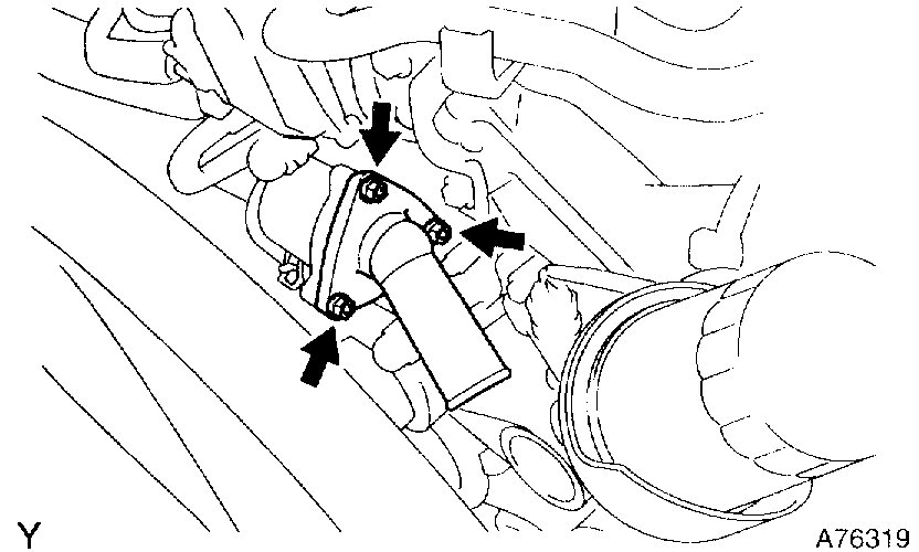

Here are directions specific to your vehicle. The attached pic correlates with the directions.
Hint: if the thermostat was not installed, cooling efficiency would be harmed. If the engine should tend to overheat, do not remove the thermostat.
1. Drain engine coolant
2. Remove v-bank cover
3. Disconnect radiator outlet, no.2 hose clamp or clip
Pic 1
4. Remove water inlet w/thermostat
a. Remove the 3 nuts, water inlet with thermostat and gasket.
5. Install water inlet with thermostat
a. Install a new gasket to the water inlet with thermostat.
b. Install the water inlet w/ thermostat with the 3 nuts.
torque: 9.0 nm (92 kgf-cm, 80 inch lbs.)
6. Connect radiator outlet, no.2 hose clamp or clip
7. Add engine coolant
8. Check for engine coolant leaks
9. Install v-bank cover
a. Install the V-bank cover with the 2 nuts.
Torque: 7.5 Nm (76 kgf-cm, 66 inch lbs.)

Okay, then the first thing I would recommend is replacing the thermostat. I asked that question because at highway speeds, the airflow doesn't require the fan to do anything. Since it overheats when moving, I would replace the thermostat. The is the cheapest thing to try and the most likely problem.
Let me know if I can help or if you have other questions.
