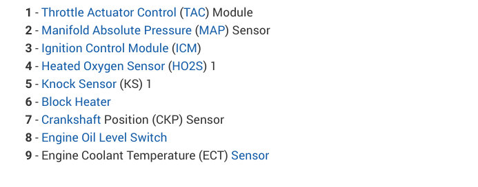

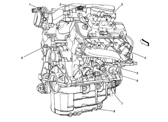

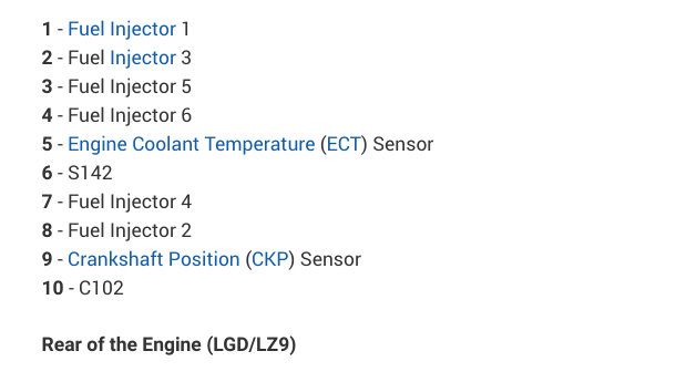

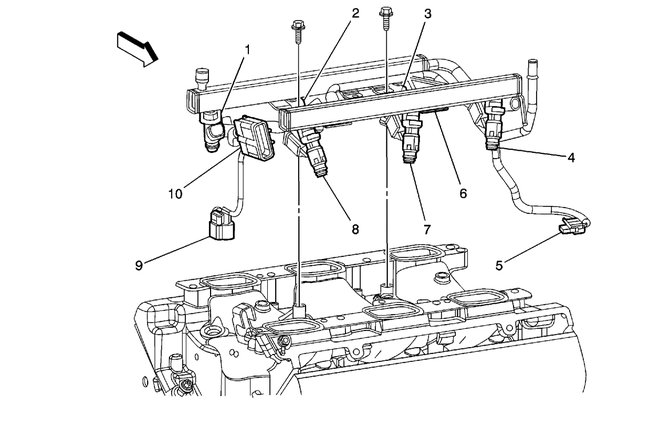

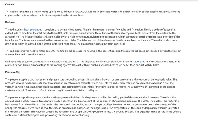

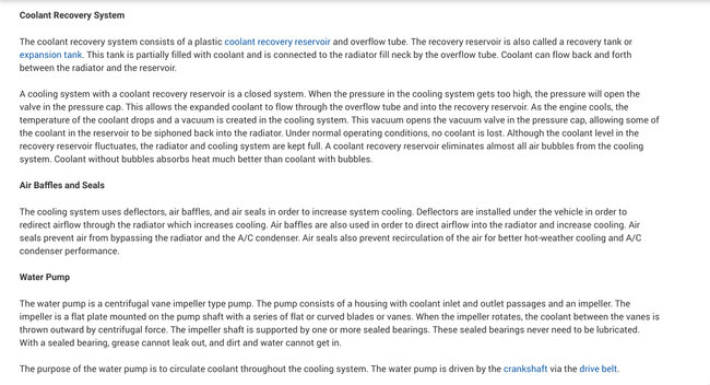

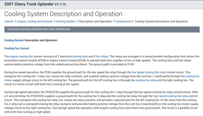

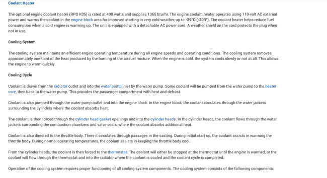

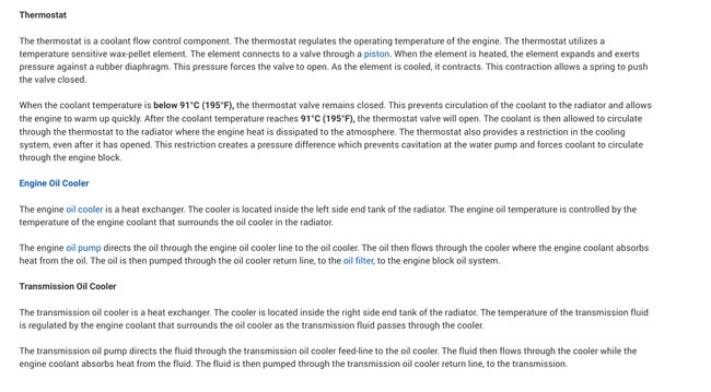

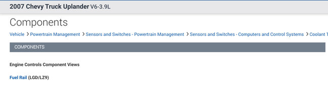

This could possibly be an air pocket that is trapped in your vehicle's cooling system that is not allowing the coolant to circulate. In order to fix this, drain the coolant and the refill from the highest point possible on the cooling system. The coolant will fill the bottom of the cooling system and fill up pushing the air out of the top is it fills. In the diagrams down below I have included the locations of the Engine Coolant Temperature[ECT] sensor and switch[Computer/Gauge] respectively, as well as a description from the vehicle manufacturer of how the cooling system on your vehicle works. Please go through these guides and get back to us with how everything turns out.
Check out the diagrams (Below). Please let us know what you find.

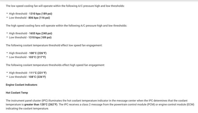

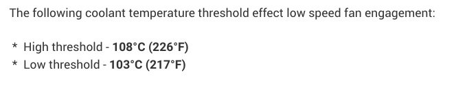

As per your reply I got the following interesting threshold related for the cooling fans:
Fans low speed engagement 103/108 C
Fans high speed engagement 108/111 C
I was expecting less temperatures for these settings and now after fixing water pump, thermostat, and temperature sensor I would like to know what actual temperatures are corresponding to one hash/division after gauge center, and some times little more, at which my cooling fans are starting now.
May be one division after gauge center is corresponding to only 103 C which is considered normal to start fans at, as per your valuable information?!

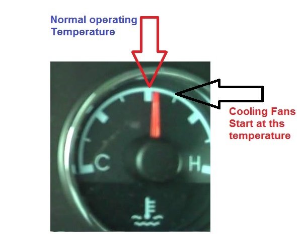

MAMRO
Dear Alex,
Thank you again. Today I managed to get infrared thermometer and while engine at idling, I made the temperature measurement at which fans are started and dash gauge is reading one division after gauge center. I found this temperature is approx 105 C (measured at engine metal part to which upper radiator hose is connected and 97 C measured at upper hose body close to engine (see photo 1). I think the first could represent coolant temperature more accurately. Comparing these values to ones provided thankfully from your side (see attached photo 2) can we conclude no overheating is experienced at idling.

SCGRANTURISMO
  • 4,897 POSTS
Hello again,
We are glad to hear it. It is always better to be safe than sorry.
