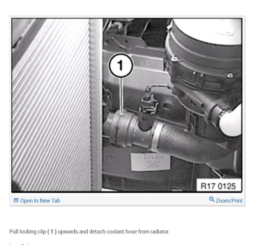

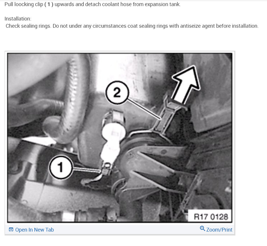

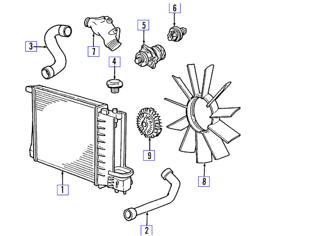

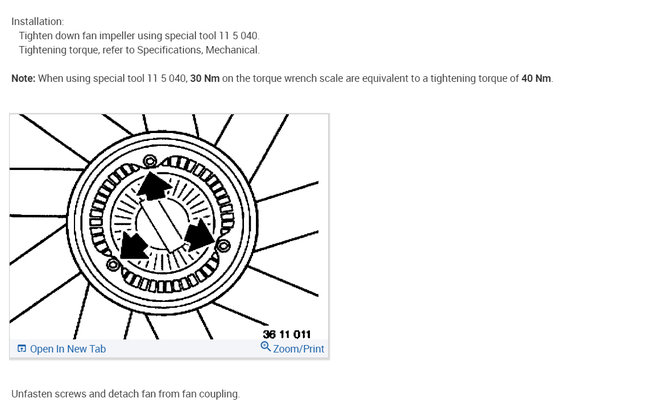

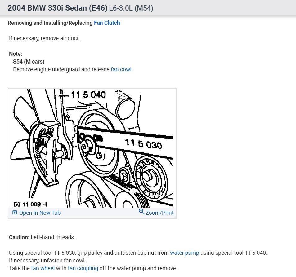

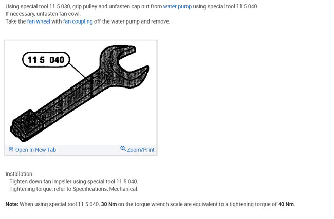

It sounds like the fan clutch is not working, do you hear the fan kick in when the engine is hot? If not, I would replace the fan clutch with a high-quality replacement. Here are the instructions on how to change the part out in the images below.
This guide may help as well:
https://www.2carpros.com/articles/engine-overheating-or-running-hot
Check out the diagrams (below). Please let us know what happens. Also check the front of the radiator to make sure a plastic bag is not stuck.

Hello Ken, the Fan has already been replaced....

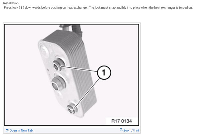

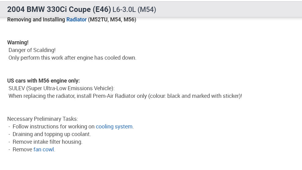

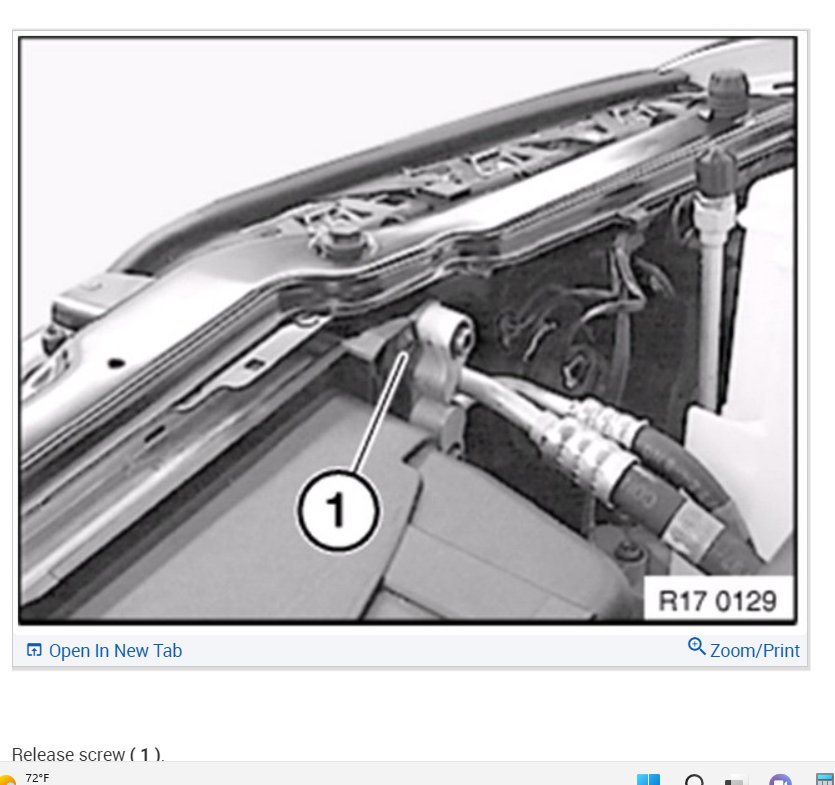

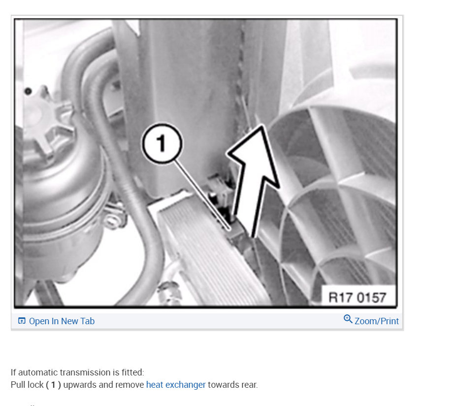

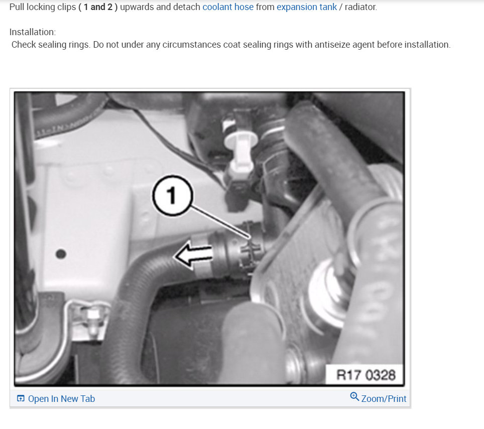

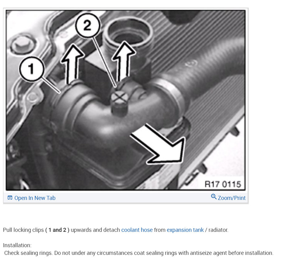

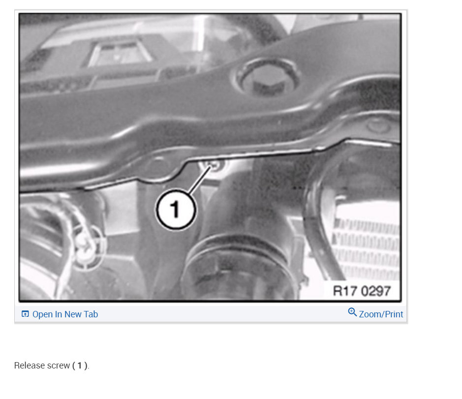

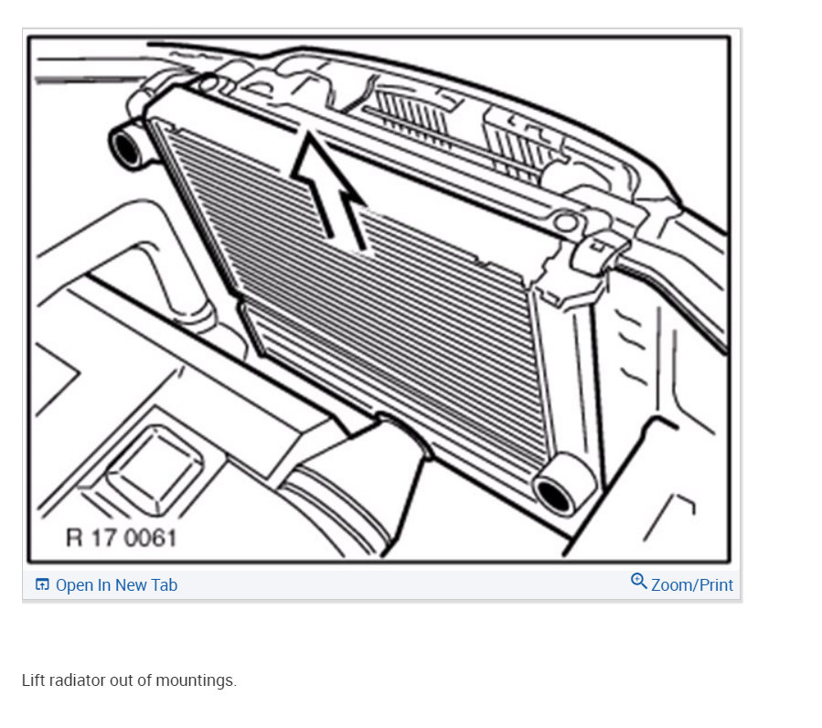

It sounds like the radiator is plugged either internally or externally (dirt) check out the guide in the above post, also we should check for a blown head gasket. This guide will help with that, and I have included how to change the radiator in the diagrams below:
