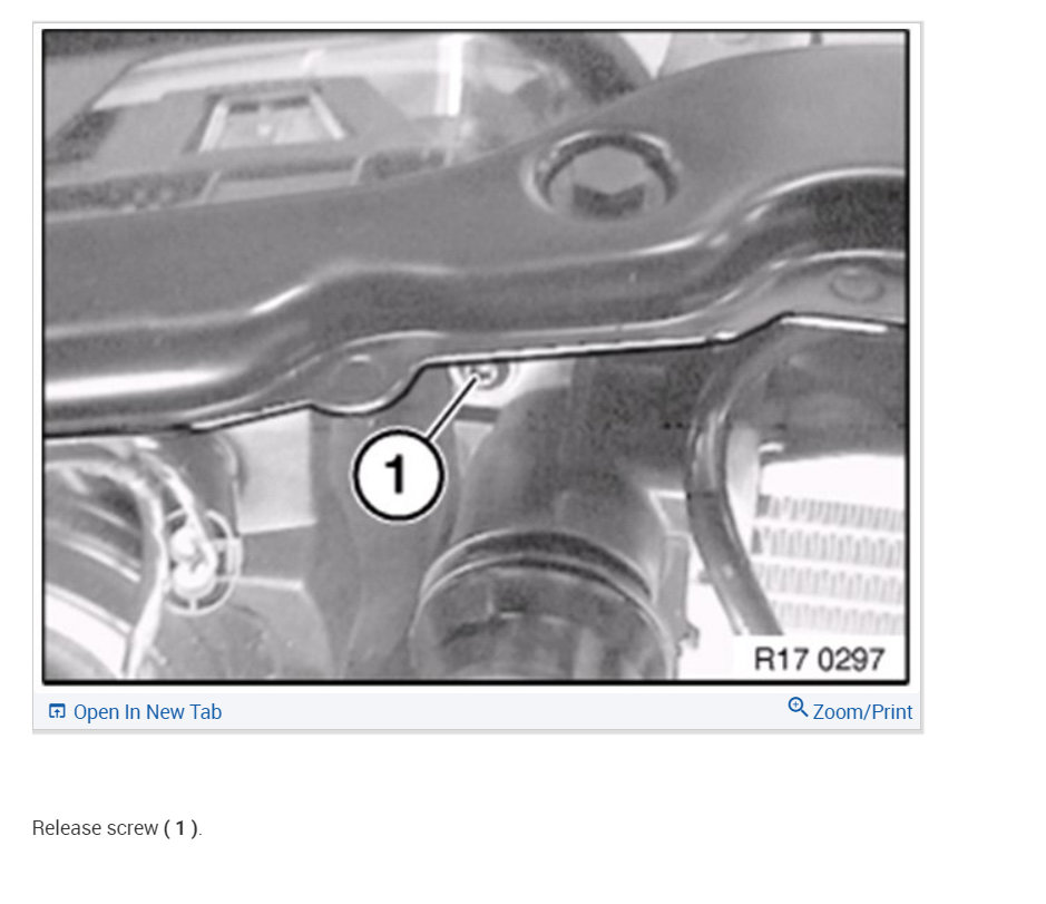

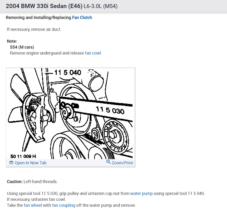

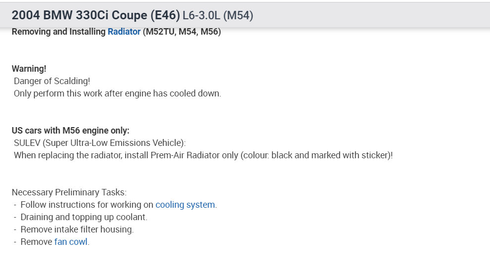

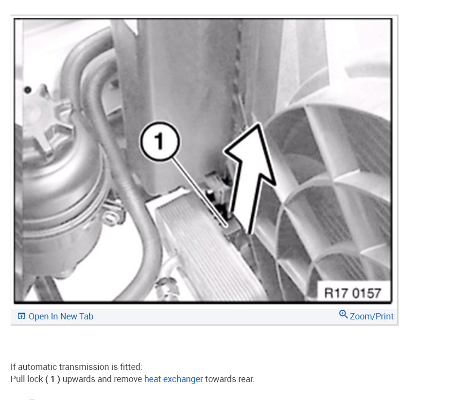

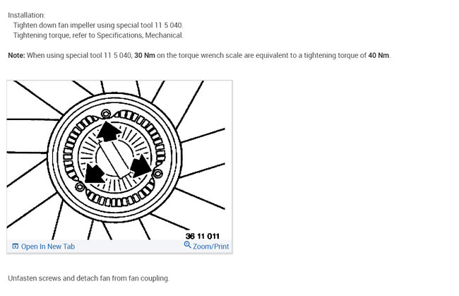

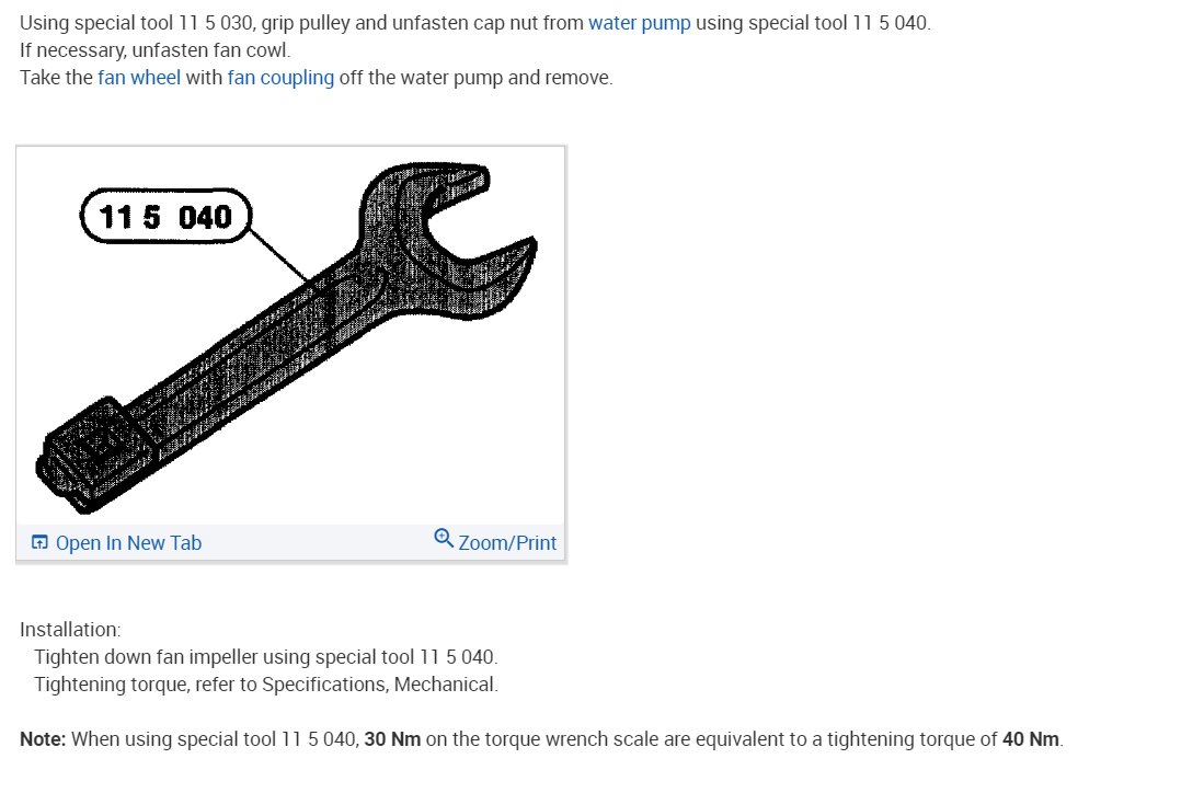

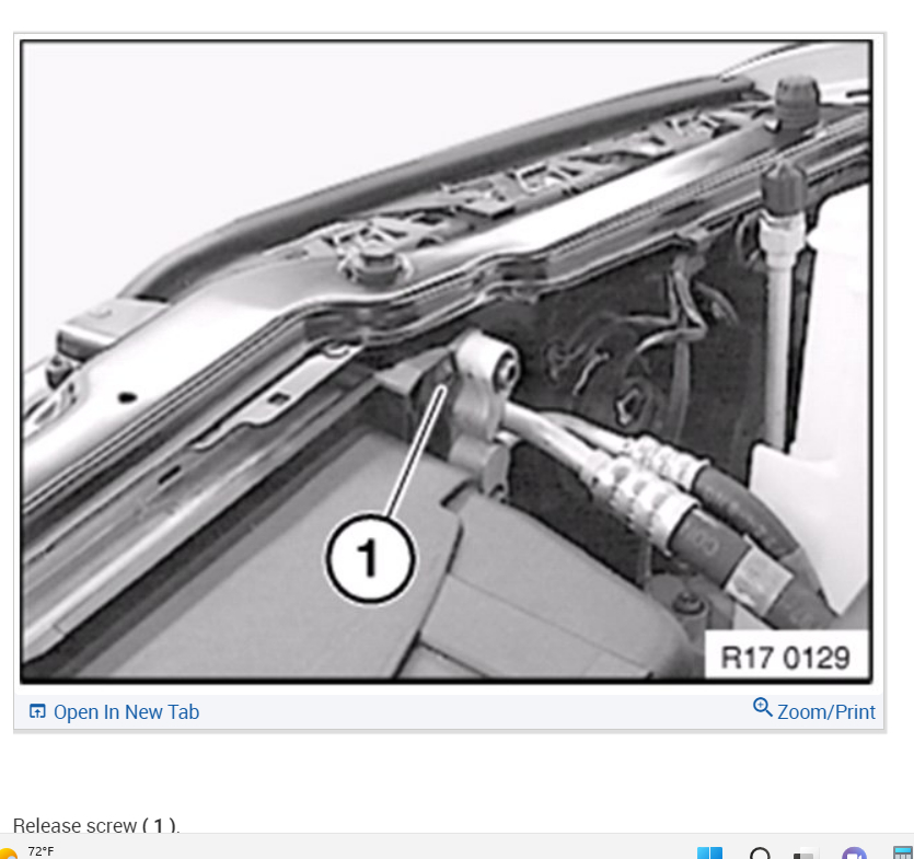

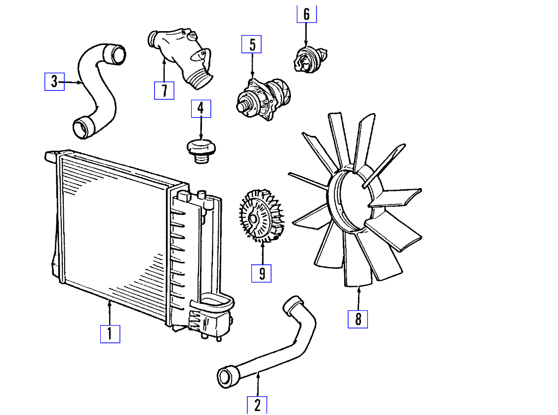

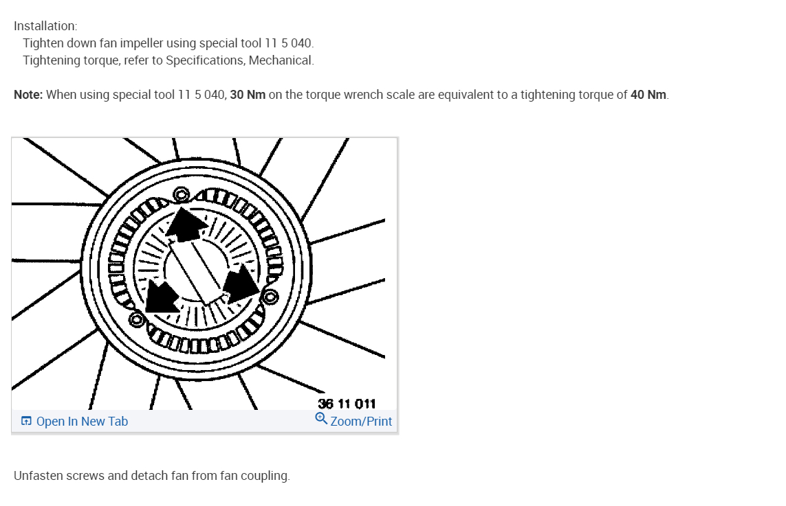

It sounds like the fan clutch is not working, do you hear the fan kick in when the engine is hot? If not, I would replace the fan clutch with a high-quality replacement. Here are the instructions on how to change the part out in the images below.
This guide may help as well:
https://www.2carpros.com/articles/engine-overheating-or-running-hot
Check out the diagrams (below). Please let us know what happens. Also check the front of the radiator to make sure a plastic bag is not stuck.

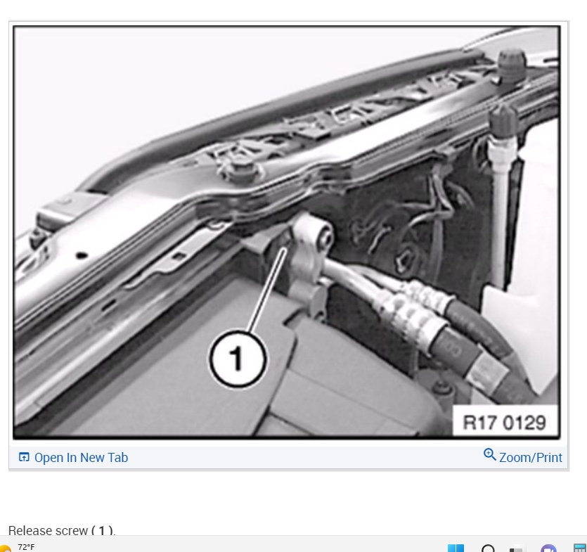

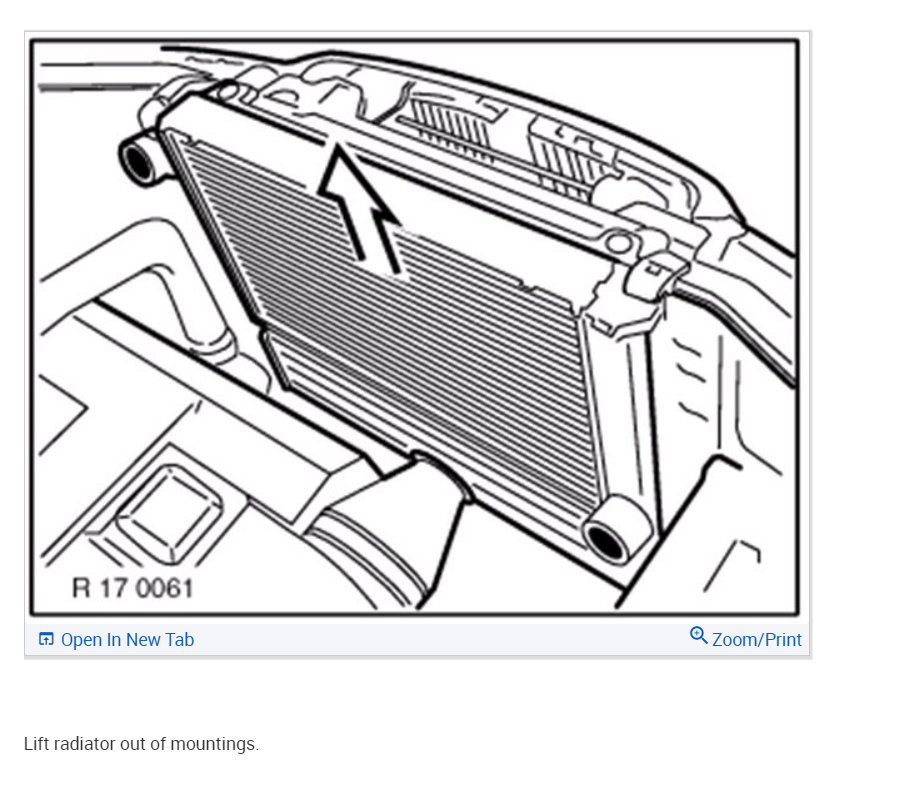

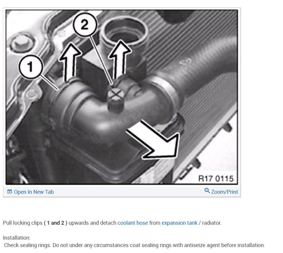

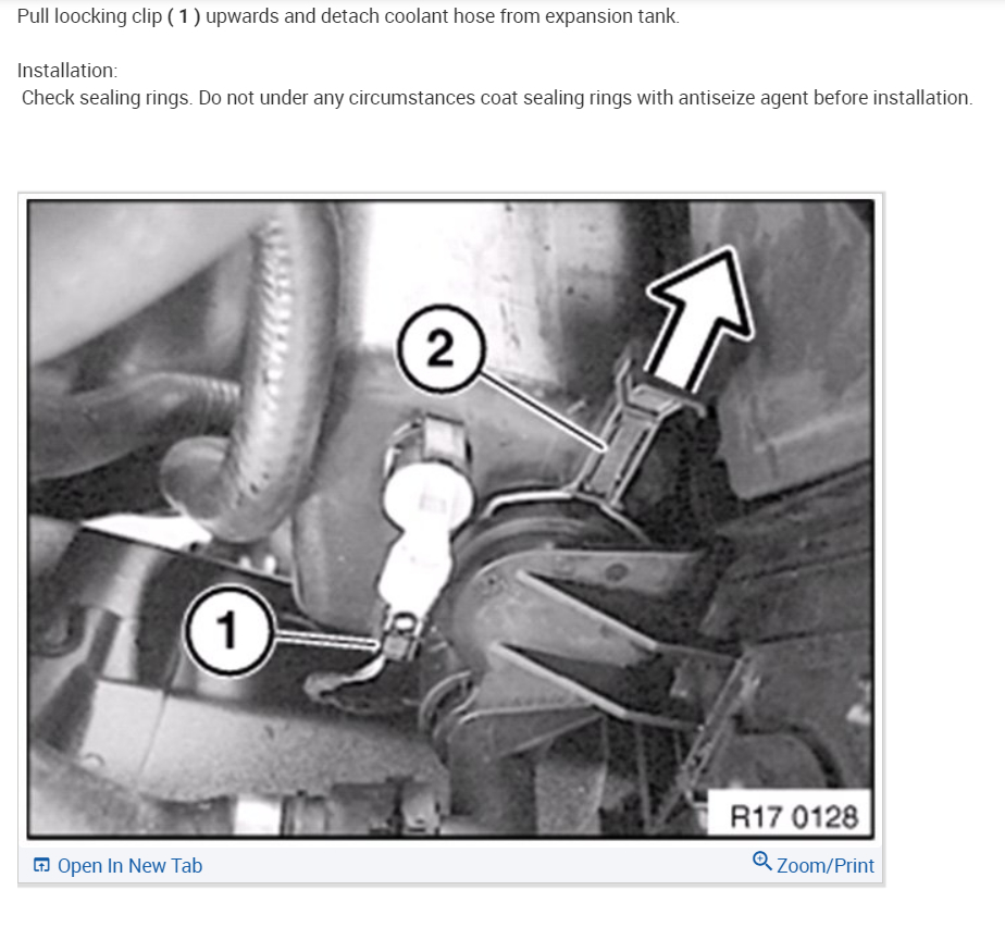

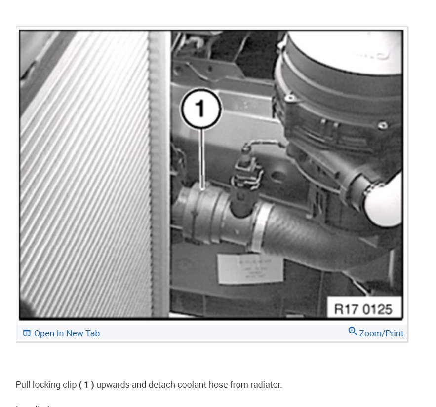

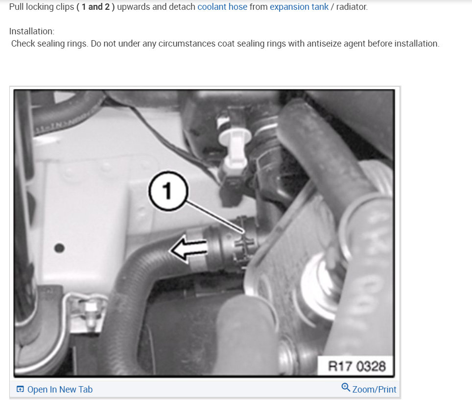

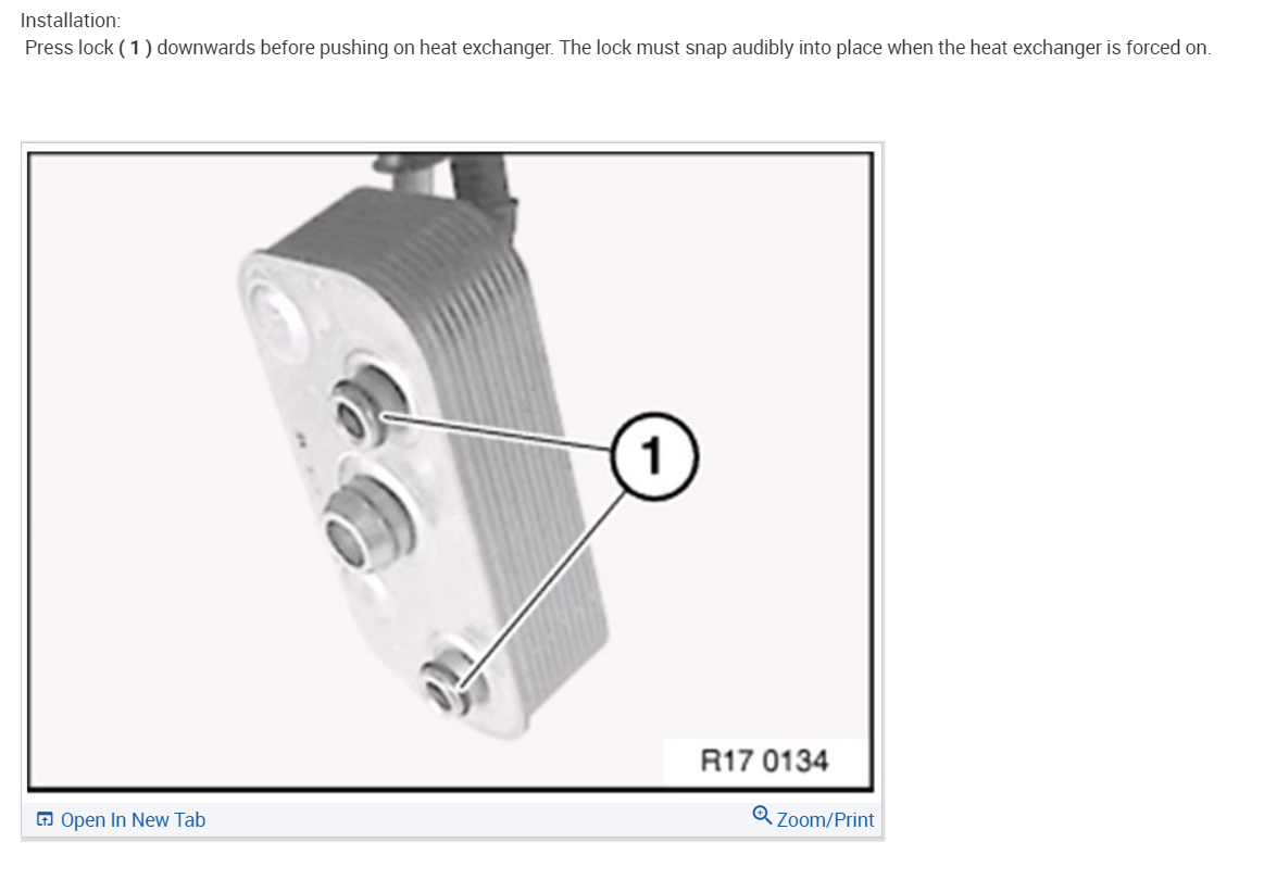

It sounds like the radiator is plugged either internally or externally (dirt) check out the guide in the above post, also we should check for a blown head gasket. This guide will help with that, and I have included how to change the radiator in the diagrams below:
