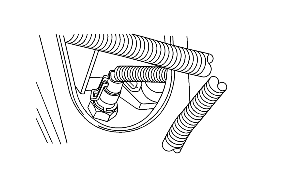

Good morning,
This could be from either the thermostat being wide open or the temperature sender unit.
If the sender unit failed, it would make sense since the A/C stopped working. When no signal is sent to the ECM, it goes into a protect mode.
https://www.2carpros.com/articles/engine-overheating-or-running-hot
https://www.2carpros.com/articles/symptoms-of-an-overheating-engine
Engine Coolant Temperature Sensor Replacement
Removal Procedure
1. Relieve the coolant system pressure.
Warning: Refer to Battery Disconnect Warning (See: Battery > Technician Safety Information > Battery Disconnect Warning).
2. Disconnect the negative battery cable.
3. Drain the coolant below the engine coolant temperature (ECT) sensor level.
4. Disconnect the ECT sensor connector.
Caution: Use care when handling the coolant sensor. Damage to the coolant sensor will affect the operation of the fuel control system.
