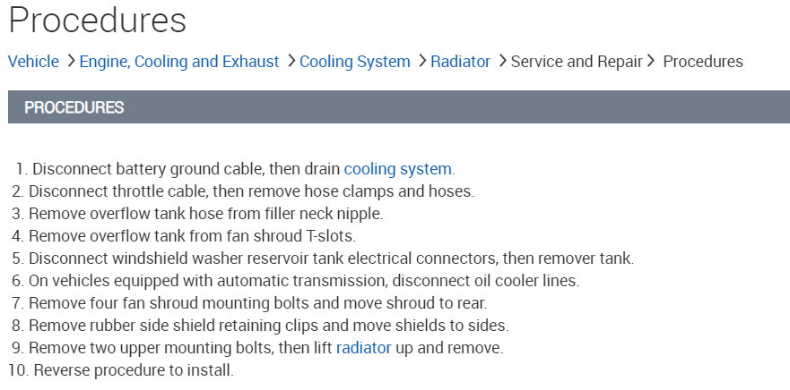

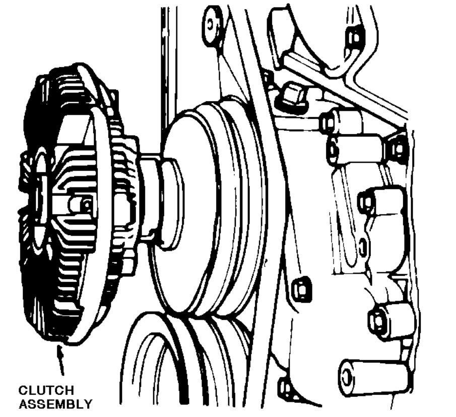

When the engine is overheating, can you hear the clutch fan kick in? If not, the clutch fan needs to be replaced and if so, I would replace the radiator because of internal blockage, you may have external blockage of the radiator fins as well, please go over this guide:
https://www.2carpros.com/articles/engine-overheating-or-running-hot
Here is a generic guide to help you step by step with instructions in the diagrams below to show you how on your car:
https://www.2carpros.com/articles/fan-clutch-removal
and this video as well:
https://youtu.be/N_-MLVlBHk8
https://www.2carpros.com/articles/how-to-replace-a-car-radiator
Check out the images (below). Please let us know how it goes.

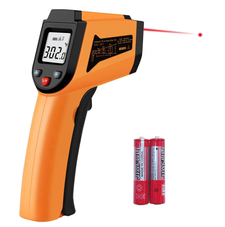

If you have an Infared thermometer, (see image), take measurements at both sides of the thermostat to see if it is opening. I am sure it is because you just changed it, but best to check just in case, even new parts can have issues.
If you don't have one you can get one either at your local auto parts store or hardware store.
If that checks out, use the thermometer and take readings on one side of the radiator and then the other. If there really isn't much of a difference in readings, then the radiator might have a clogged or restricted passage(s) causing coolant to not flow properly and cool the engine.
An efficient radiator will drop the temperature of the coolant approximately 20 degrees Fahrenheit from one side to the other.

Yes, use an inferred thermometer and take readings on one side of the radiator and then the other.
Here is a link to one I found on Amazon:
https://www.amazon.com/Klein-Tools-IR1-Thermometer-Non-Contact/dp/B0873T6SGR/ref=asc_df_B0873T6SGR?tag=bingshoppinga-20&linkCode=df0&hvadid=80814196436472&hvnetw=o&hvqmt=e&hvbmt=be&hvdev=c&hvlocint=&hvlocphy=&hvtargid=pla-4584413745308907&psc=1
You can also get one at a hardware store or auto parts store.
The black particles you are seeing sound like corrosion which will block the radiator internally.
