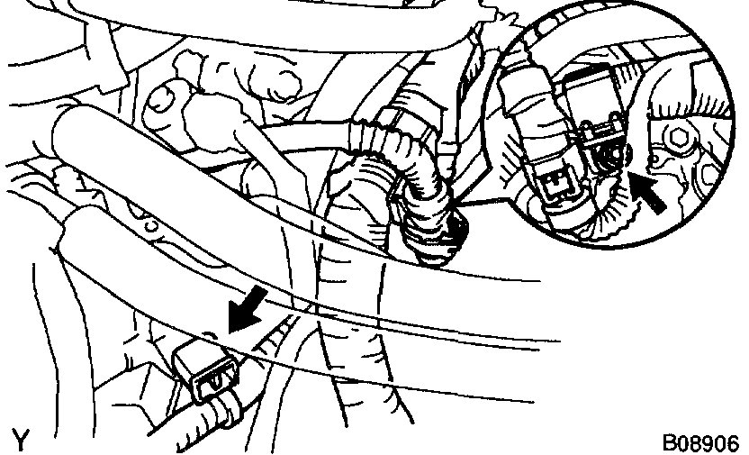

Here are directions specific to this vehicle for checking and replacing the thermostat. The attached pics correlate with the directions.

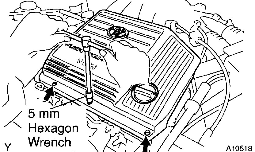

2. REMOVE V-BANK COVER
a. Using a 5 mm hexagon wrench, remove the 3 cap nuts.
b. Loosen the V-bank cover fastener counterclockwise.
c. Remove the V-bank cover.

5. DISCONNECT HEATER HOSES
6. DISCONNECT NO.2 ECT SWITCH CONNECTOR
pic 2

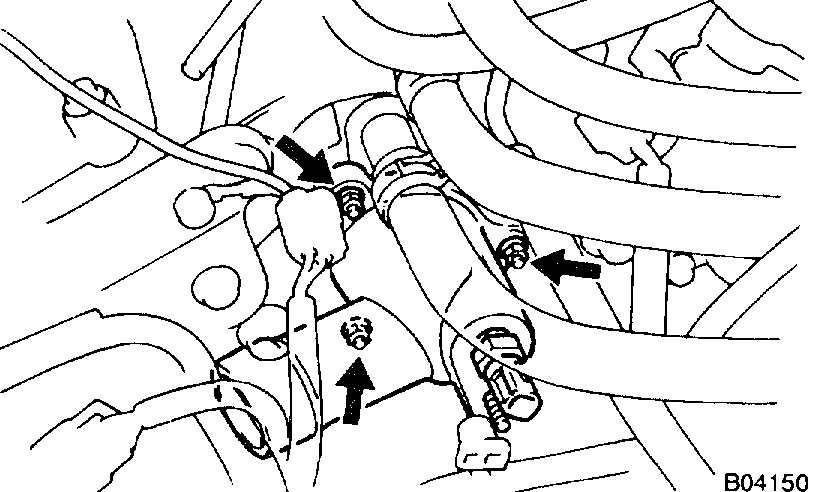

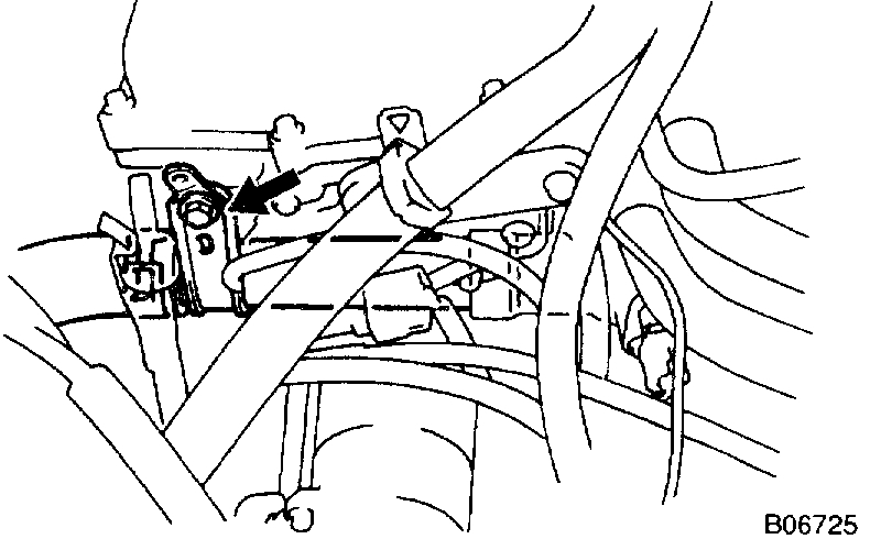

7. DISCONNECT ENGINE WIRE PROTECTOR FROM WATER INLET AND RH CYLINDER HEAD
Remove the nut and disconnect the clamp, and disconnect the engine wire protector from the water inlet and cylinder head.
pic 3

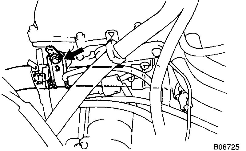

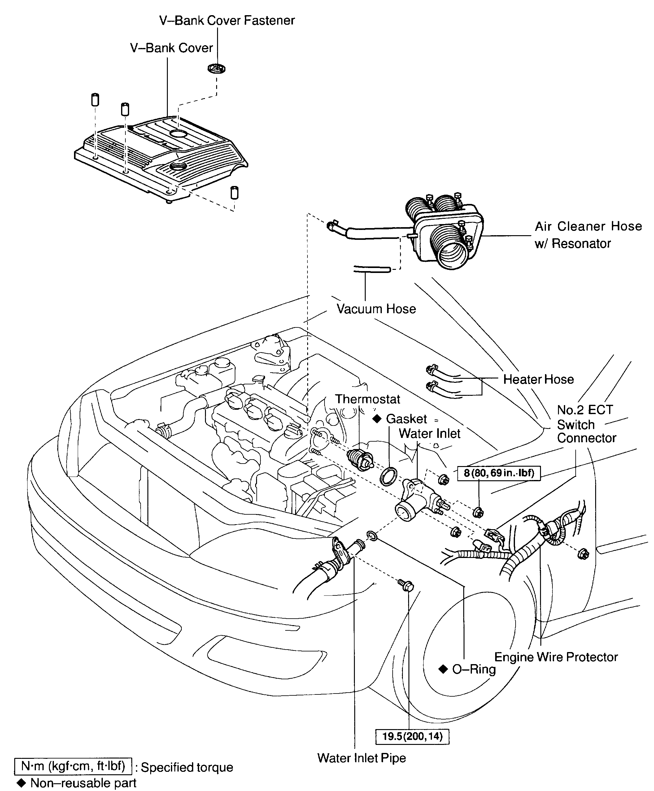

8. DISCONNECT WATER INLET PIPE FROM WATER INLET AND LH CYLINDER HEAD
a. Remove the bolt, and disconnect the inlet pipe from the water inlet.
b. Remove the O-ring from the inlet pipe.
pic 4
9. REMOVE WATER INLET AND THERMOSTAT
a. Remove the 3 nuts, water inlet and thermostat.
b. Remove the gasket from the thermostat.

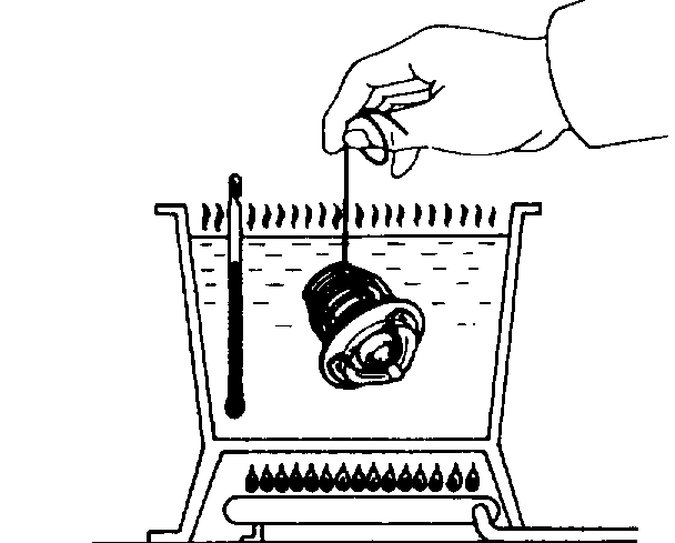

INSPECTION
INSPECT THERMOSTAT
pic 5

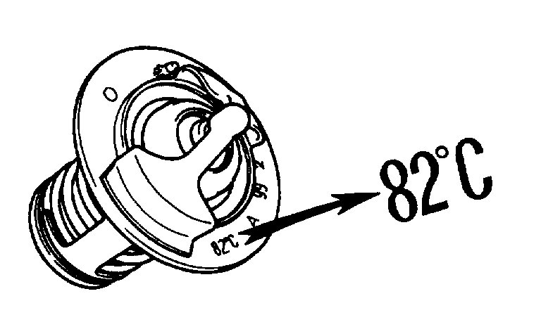

HINT: The thermostat is numbered with the valve opening temperature.
pic 6

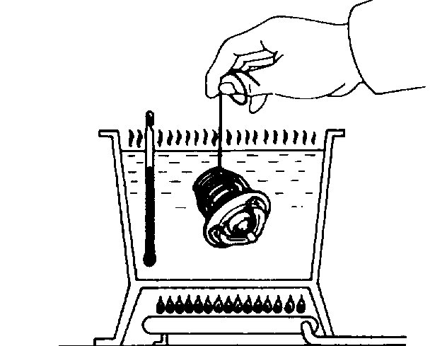

a. Immerse the thermostat in water and gradually heat the water.
b. Check the valve opening temperature.
Valve opening temperature: 80 - 84°C (176 - 183°F)
If the valve opening temperature is not as specified, replace the thermostat.

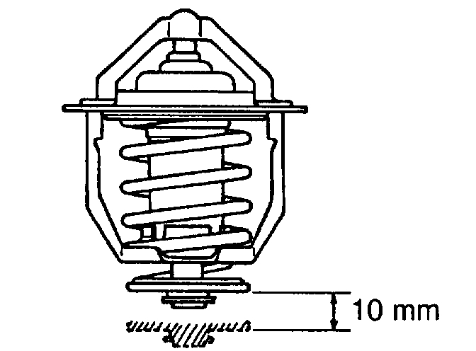

c. Check the valve lift.
Valve lift: 10.0 mm (0.394 inch) or more at 95°C (203°F)
If the valve lift is not as specified, replace the thermostat.

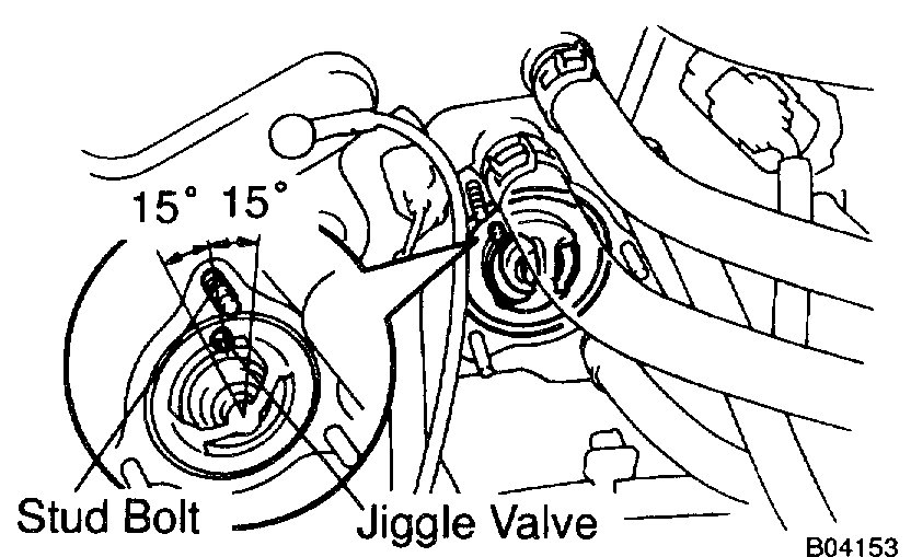

b. Align the thermostat jiggle valve with the upper stud bolt, and insert the thermostat in the water inlet housing.
HINT: The jiggle valve may be set within 15° of either side of the prescribed position.
