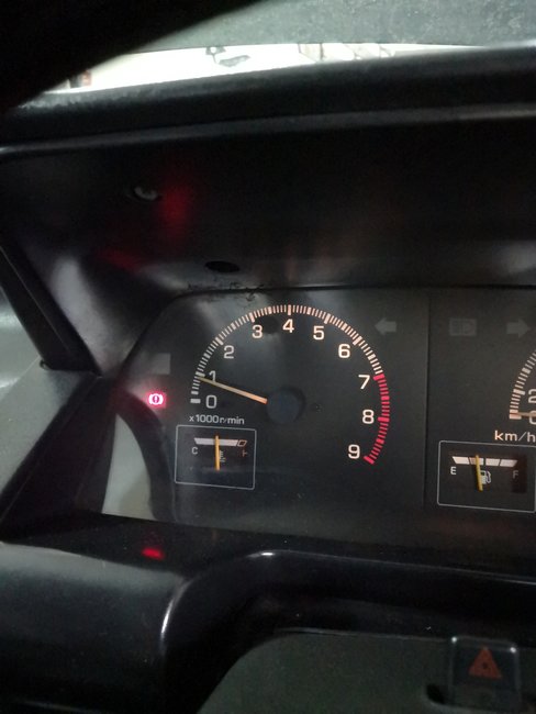

Hi, it is again. The temperature gauge stays at this level, to the middle most of the time. Is it normal? It didn't stay this high previously before the repair. The fan does kick in, but it seems a bit too late.
Feb 28, 2020 at 2:40 AM
Okay, that is normal.
Do you have the thermostat installed?
Feb 28, 2020 at 4:22 AM
BENSON YU
  • 9 POSTS
The mechanic insisted that a thermostat is not necessary. However, if the temperature keeps staying high, then he will consider, as he says that the installation of a thermostat keeps the temperature up instead of down.
Feb 28, 2020 at 5:22 AM
It is a shame that he does not understand how an engine cooling system works.
Make sure he will warranty all the head gasket work when it fails again. It is not a question of if it will fail, just when it will fail again.
