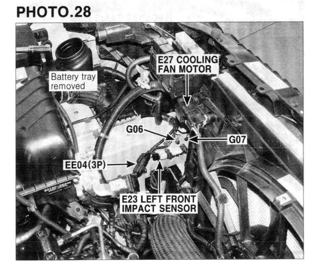

Hi. When the car is on and not moving (like at a stoplight) the temperature gauge starts rising. When I start driving, the temperature gauge comes back down.
The fluids are topped off, there are no leaks, and then when i open the hood and look while the car is running, the radiator fan is running.
Any suggestions?
Jul 4, 2022 at 11:06 PM
  • 55,859 POSTS
It is good the fan is running but can you tell me if the fan blade is in good shape? And does it seem like the fan motor is running at full speed? There is really not to much that can be wrong except for the fan motor because it is solely responsible for cooling the engine at a stop. I have seen the fan controller go bad and run the fan at half speed. Check the diagrams below.

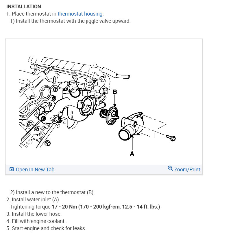

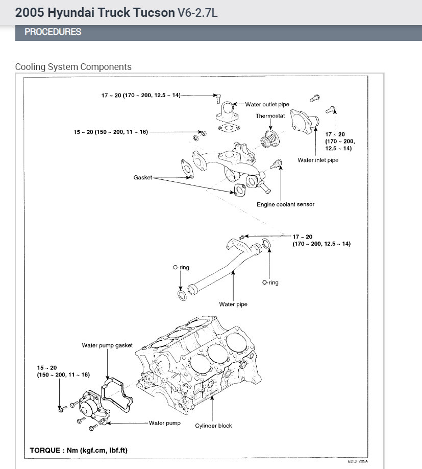

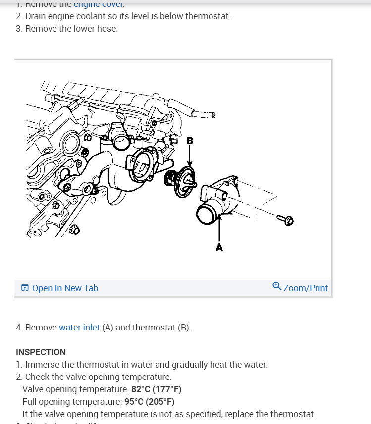

Could the thermostat be the issue?
Thanks for the help!
Jul 8, 2022 at 10:07 PM
  • 55,859 POSTS
That was going to be my next suggestion. Here is a generic guide on how to change the thermostat out with specific instructions and the diagrams below for your car:
