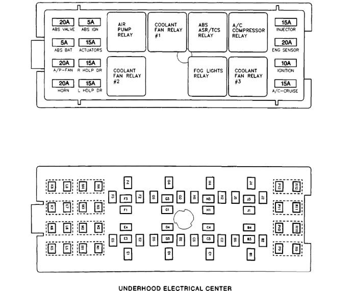

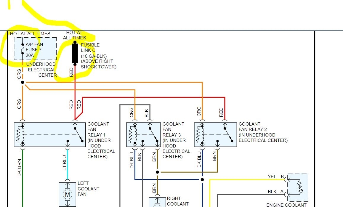

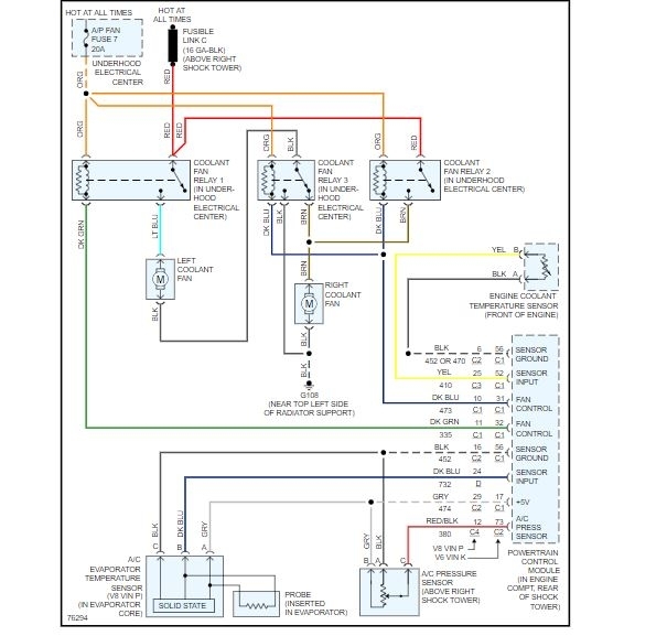

The test analyzer says to replace the cooling fan motor relay, but there are three, should I replace the three?
Saturday, May 11th, 2019 AT 12:13 PM
MECHANIC
52,797 POSTS
Good afternoon,
What tells you to replace the relay?
https://www.2carpros.com/articles/how-an-electric-cooling-fan-works
What code did you see for this?
Does the cooling fan work at all?
I attached a wiring diagram for you to view. Test for power to the relay on the red wires first to be sure there is power available.
