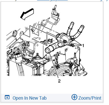

I checked cooling fan with Battery 12v ok, checked temperature sensor with Multimeter reading 2000 ohms cold and around 500 ohms hot assume this is okay. Would my problem be my thermostat?

When the A/C is on and the engine is running does the cooling fan operate? If not, this will be the problem. The fan must run while the AC is on. If it does run then I would make sure the coolant level is full, (engine cold only) and if so, check for blockage at the radiator, either internally or externally.
Here is a guide that can help:
https://www.2carpros.com/articles/engine-overheating-or-running-hot
If the engine overheats in the first 15 minutes of driving, then I would suspect the thermostat. Here is the location so you can check it out. Check out the images (below). Please let us know what happens.

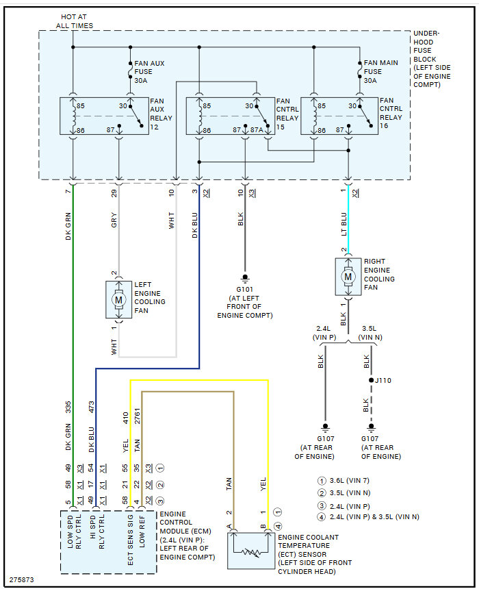

nether cooling fan was operating whether the A/C is on or off. drove car this morning for 30-minute ride check the fans while car was idling nether one was on and not overheating had aircon fuse pulled during this test ride. Why are the cooling fans off?

Yep, that will do it. The cooling fans must run with the A/C on. There are three relays and 2 fuses that run the system. Let's see if the FAN MAIN fuse and the FAN AUX fuse are good and have power to them, (key on). The fuses are in the fuse panel under the hood.

Checked both MAIN and AUX fuses under the hood both have power. did test with A/C disconnected.

You could have two fan motors that are bad, let try checking the ltblu and gray wires for power when the engine is running and the A/C on.

Checked LTBLU and Gray wire no power. Found 15amp ENG-3 fuse blown, replace it and blew again right away? What does this fuse control? Fans were tested with 12V Battery and both work just fine.

Did you check the fan circuit grounds? Here is what the ENG 3 fuse powers, nothing to do with the fans so please start a new thread for this problem.
Evaporative Emissions (EVAP) Canister Purge Solenoid Valve, Heated Oxygen Sensors (HO2S), Mass Air Flow (MAF) Intake Air Temperature (IAT) Sensor
Here is the wiring diagrams for the radiator cooling fans, I would swap the relays out one at a time to see if that is the problem. Check out the images (below). Please let us know what happens.
Apr 27, 2025 at 4:47 AM

Gotcha, Remove the electrical connector from the right fan motor and check the black wire. Let me know.

No ground to the Right fan connector, had ground to the left fan connector.

Okay, it sounds like you tested everything, so the PCM might be bad, let's run the codes to see which ones are stored.
