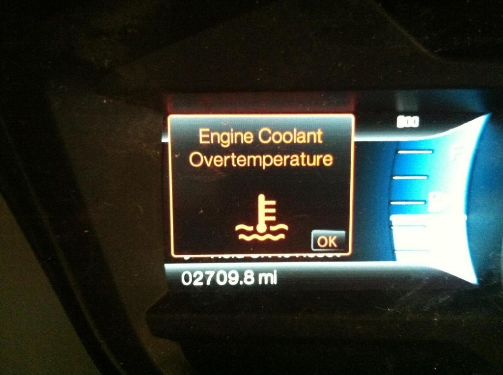

I don't have a code reader to know what the code is, and can't really drive it like it is to get it checked. I have not changed the thermostat but I will do that tonight. All I can see is the check engine light is on and on the left side of the display there is a warning up that says "Engine coolant over temperature" see attached.
Jun 19, 2020 at 12:06 AM
Okay, that light is on from the code that is set.

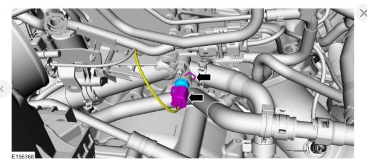

Is this the sensor you replaced?
Jun 19, 2020 at 12:09 AM

Yes, that was the sensor I replaced. sorry didn't see the picture.
Jun 19, 2020 at 12:25 AM
No worries. I just wanted to be sure of the sensor.
