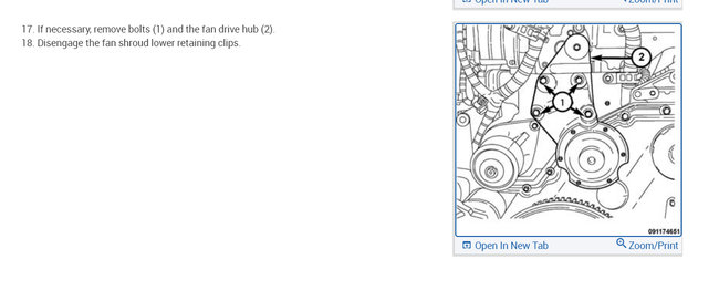

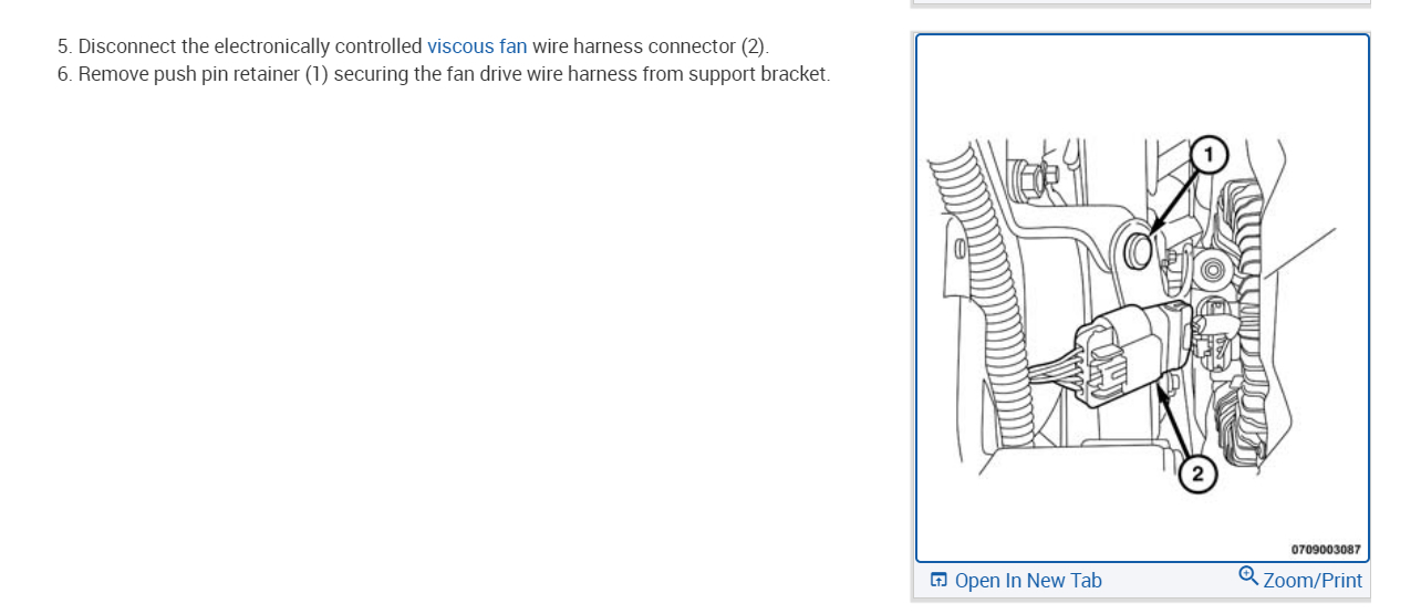

The engine is overheating when speeding up sits fine at idle and when cruise is set and on flat terrain the temperature holds steady but is still running hot. Had thermostat replaced in January and again in May. Also, in may had radiator flushed out and new coolant put in. Truck has been fine since then but about a week ago it started overheating again. Not sure what to do.

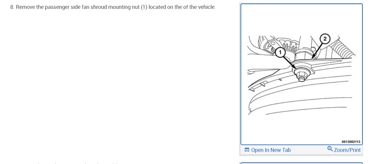

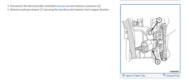

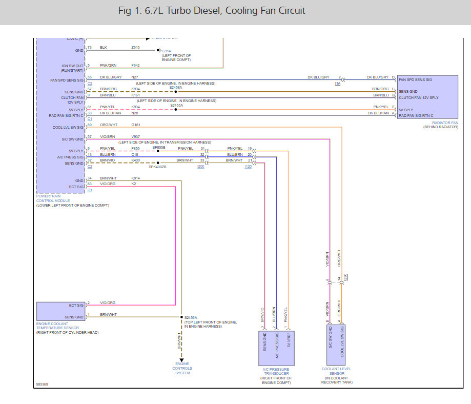

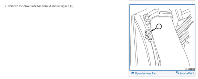

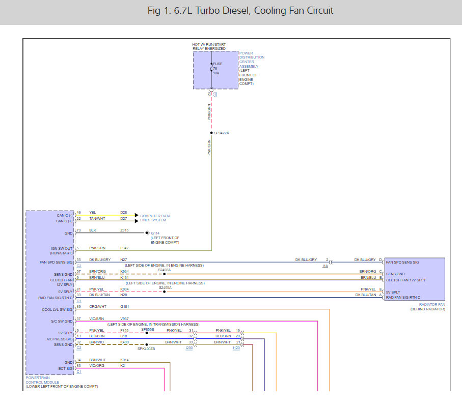

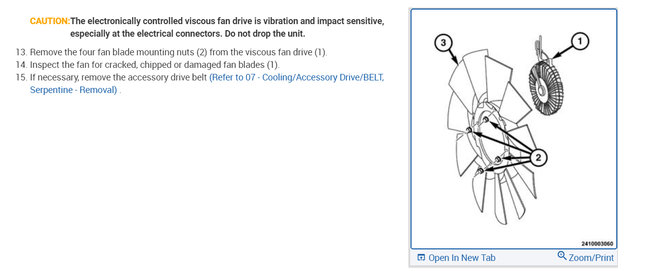

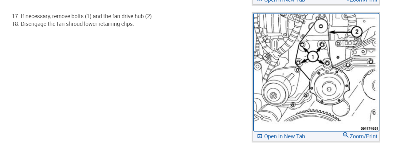

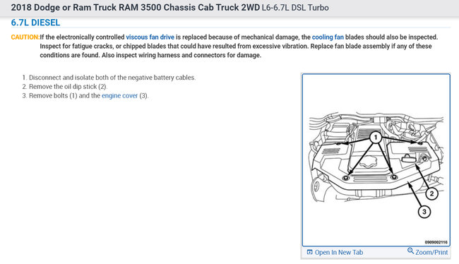

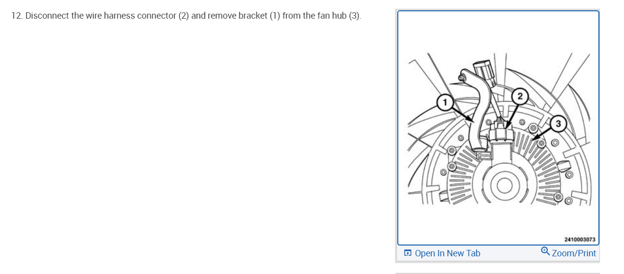

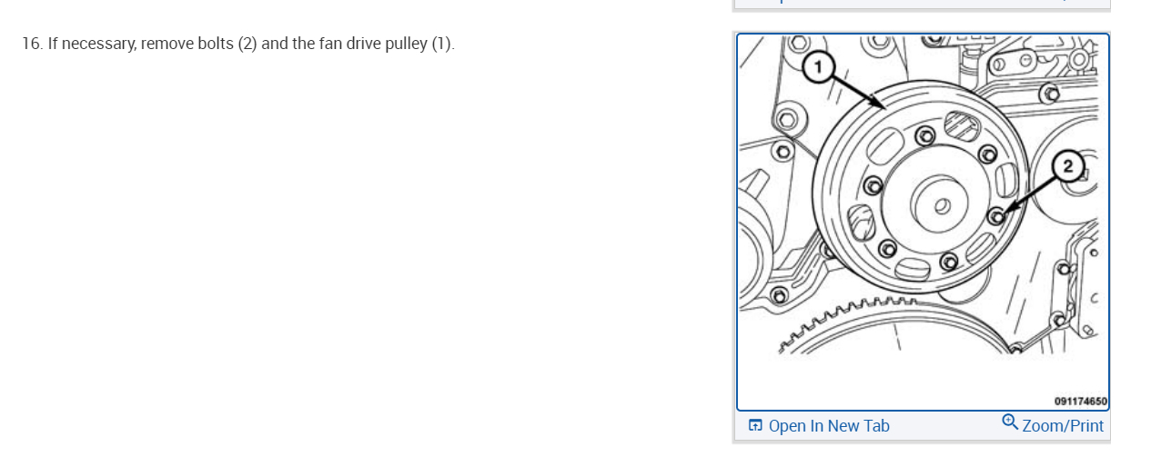

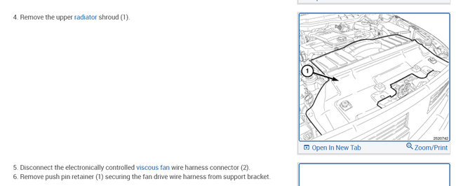

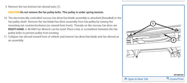

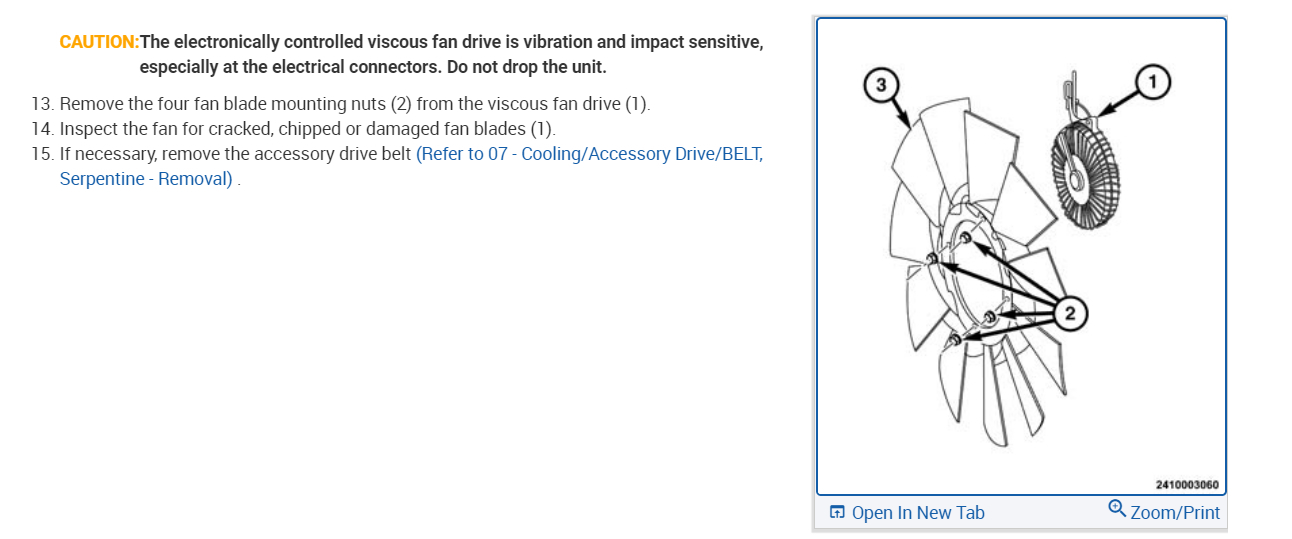

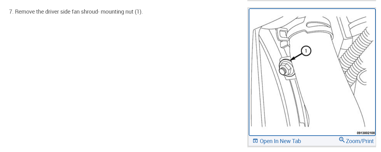

When the engine is running hot or overheating can you hear the cutch fan kick in? If not the first thing was needed to do is check fuse # 78 10-amp int he under hood fuse panel, this fuse controls the radiator electronic clutch fan, if that's okay the truck may need the electro fan clutch replaced, here are the instructions in the diagrams below plus a generic guide on what to look for when the truck is overheating.
and
https://www.2carpros.com/articles/engine-overheating-or-running-hot
I have also included the cooling fan wiring diagrams so you can see how the system works. Check out the diagrams (below). Please let us know what you find. We are interested to see what it is.
