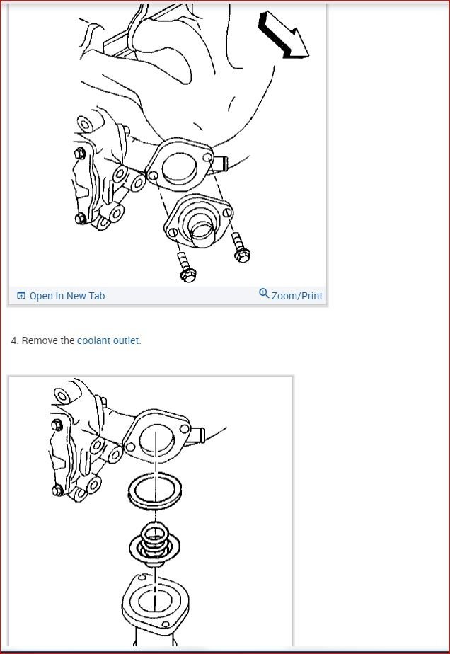

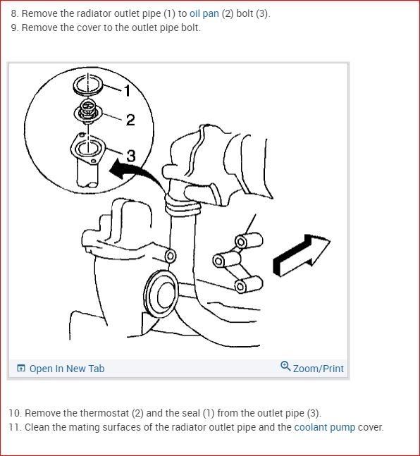

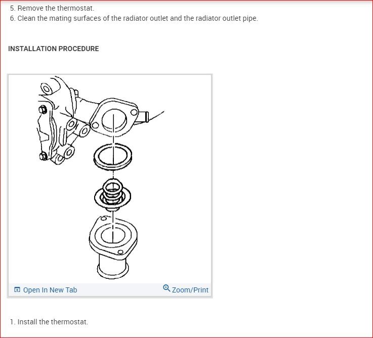

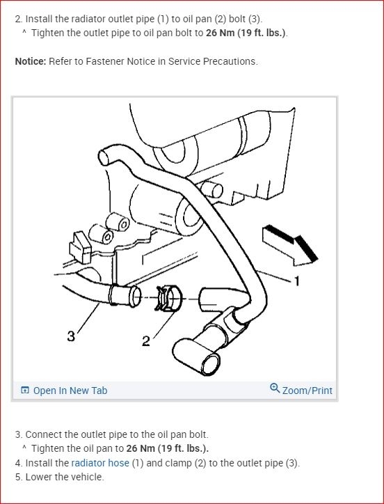

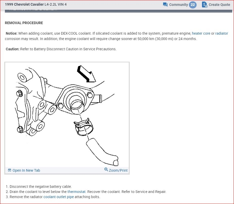

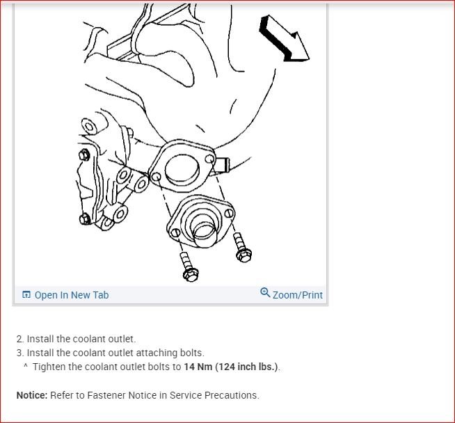

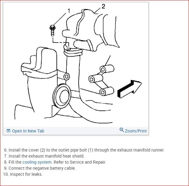

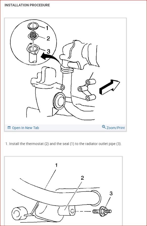

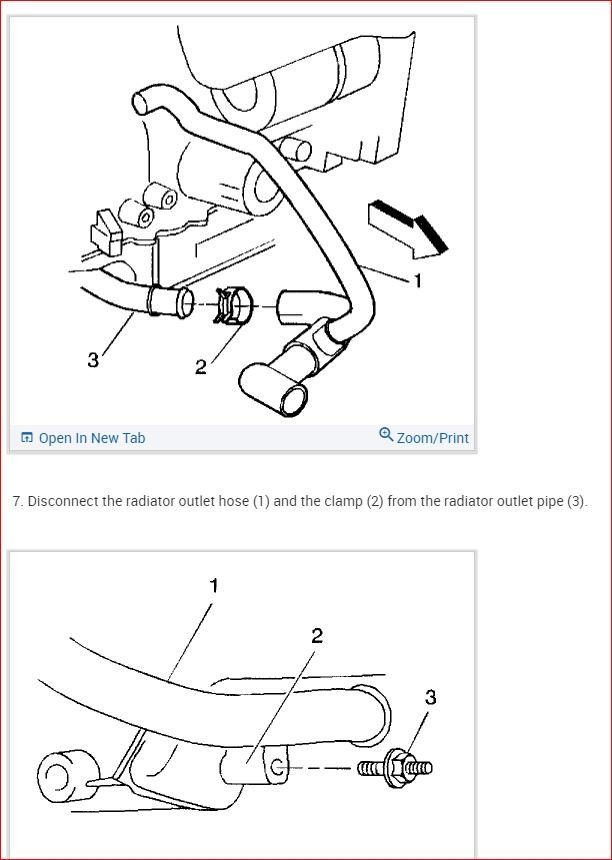

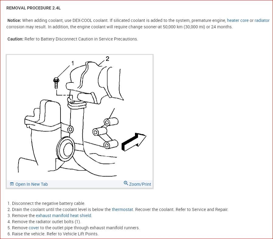

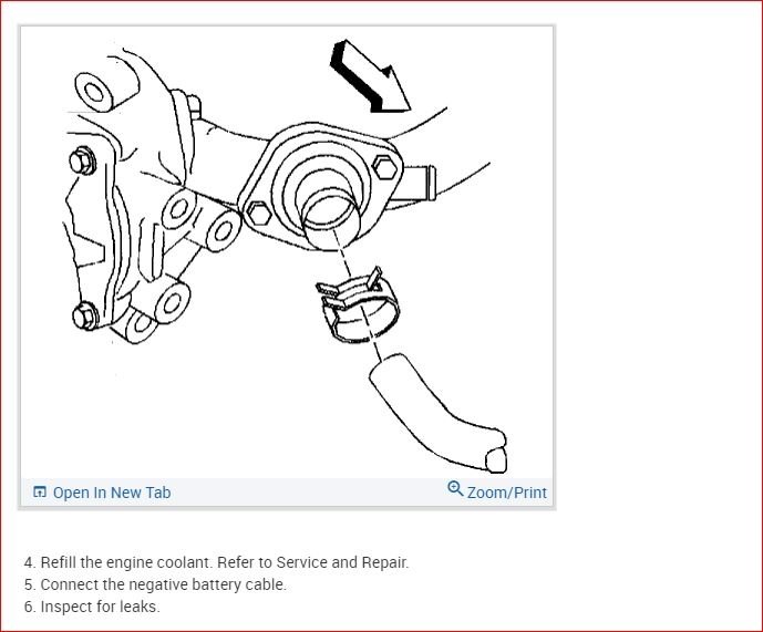

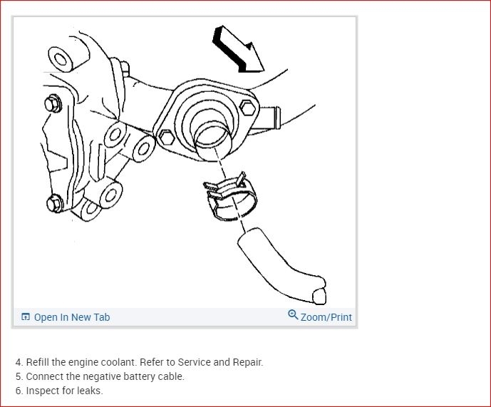

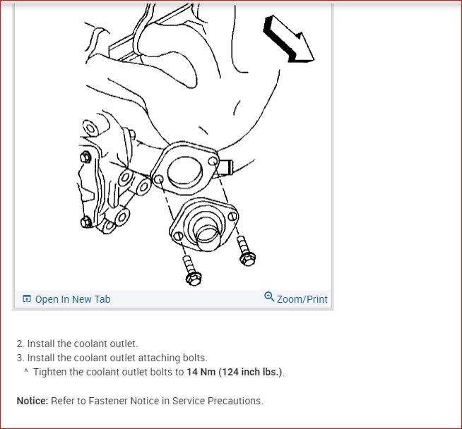

Where do you change the thermostat?
Tuesday, May 21st, 2019 AT 6:39 PM
MECHANIC
18,907 POSTS
Hi Victoria,
Here is the procedure depending on the engine you have. 2.4L or 2.2L. Both are provided below so please refer to the proper one.
Please let me know if you need more information. Thanks
