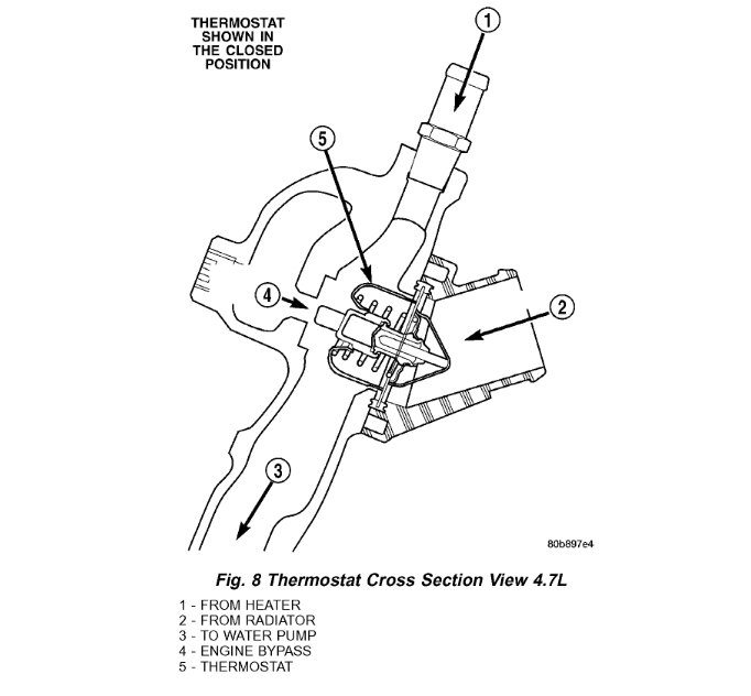

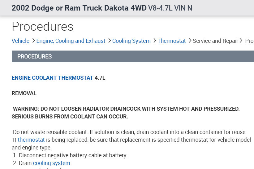

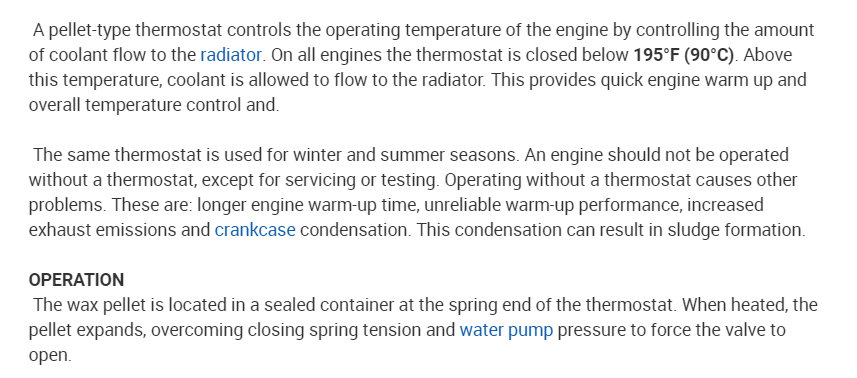

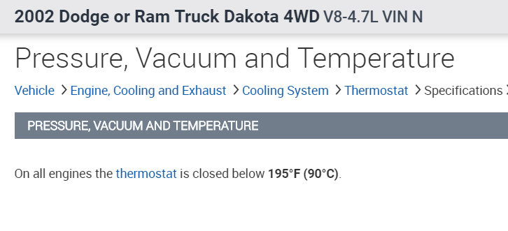

This sounds like your vehicle's thermostat might be starting to stick. The thermostat is what allows the coolant to flow. When it's closed, the coolant doesn't flow, when it's open, it does. The problem is when the thermostat gets stuck closed. The coolant doesn't flow and your vehicle's engine overheats. In the diagrams down below I have included a description, Original Equipment Manufacturer (OEM) part number, specs, and the instructions for the removal and installation of your vehicle's thermostat. Please go through these guides and get back to us with what you are able to find out.

A stuck thermostat is a possibility but a small one. A leaking cylinder head gasket is more common. Combustion gases can pool under the thermostat causing it to not open. Thermostats open in response to hot liquid, not hot air. You should see coolant going into the reservoir faster than normal too.
To get you home you can remove the thermostat. If it's sticking or a head gasket is leaking it will stop overheating and won't get up to normal temperature. Once the coolant is circulating freely a chemical test can be done at the radiator to verify a head gasket is leaking. If it is not, replace the thermostat and hope that's all it is.
