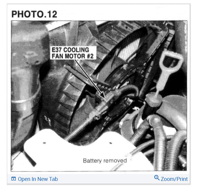

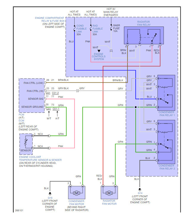

When starting the A/C system engine gets hot! When I stop everything goes well.

If the fan is not coming on check the Rad fusible link 30 amp and the SENSR fuse under the hood, if there are okay start the engine and turn the A/C on to check for power at the fan motor, if there is power the fan motor is probably bad and needs replacement. here is how to check it and how to change the fan motor out in the images below.
This generic guide will help walk you through the steps:
https://www.2carpros.com/articles/replace-electric-fan-motor

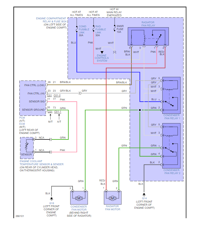

Also, here are the cooling fan wiring diagrams so you can see how the system works.
