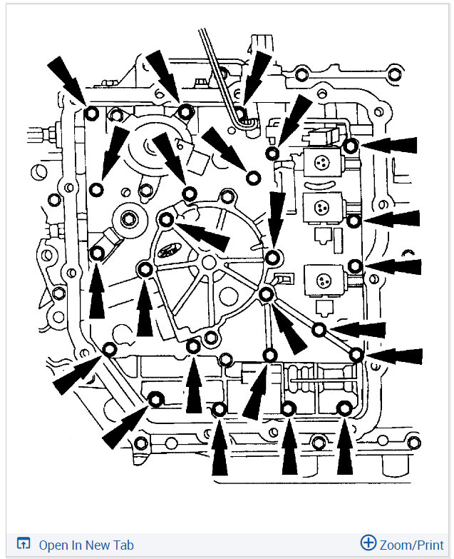

I just bought this van from a dealer, 6 months ago. Only replaced the battery. Then suddenly the engine shuts off when I shift into any drive gear. Doormen for when shifting to neutral. ATF is at the proper levels I'm not having any other lights or OBD codes. Internet searches are producing, easy and cheap 2$ part to buy a new transmission $2,500. How can I attempt to fix this without having to go broke?

The engine needs to relearn the idle pattern when the battery is replaced BTW. Here is a guide that explains what to do to fix it:
https://www.2carpros.com/articles/engine-stalls-idles-too-high-low-after-dead-or-replaced-battery

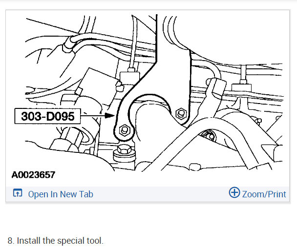

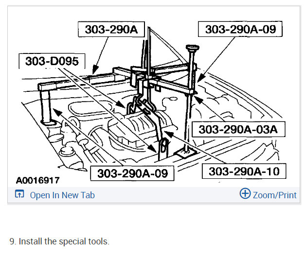

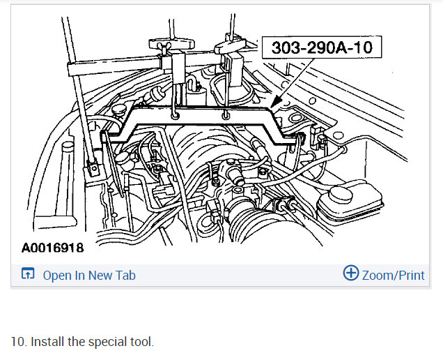

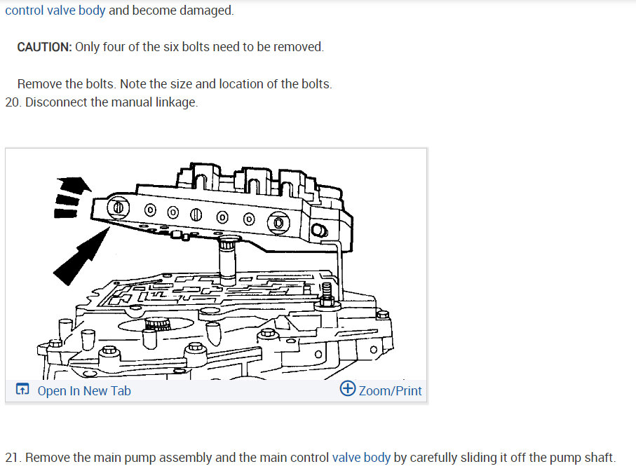

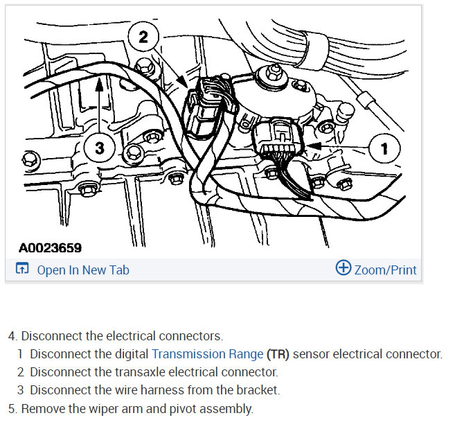

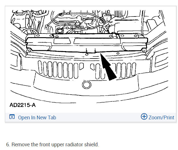

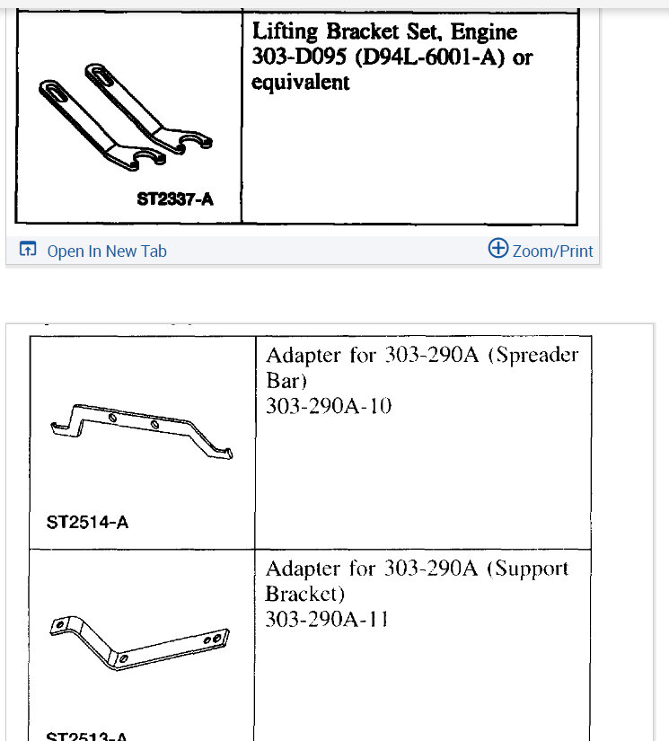

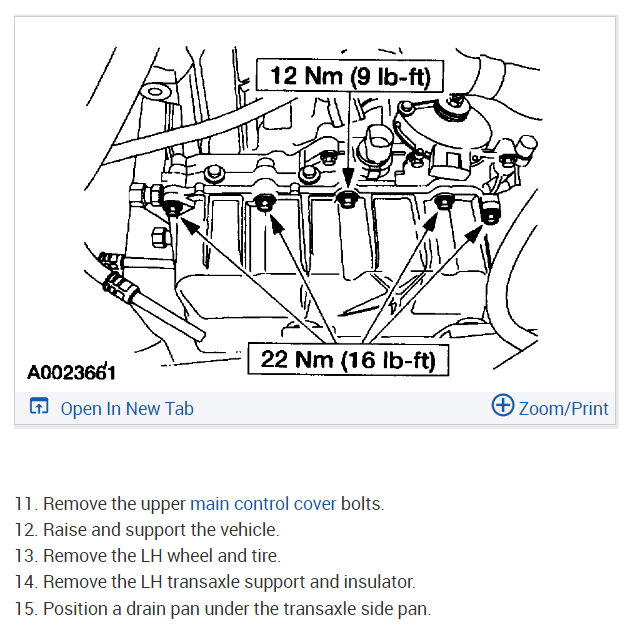

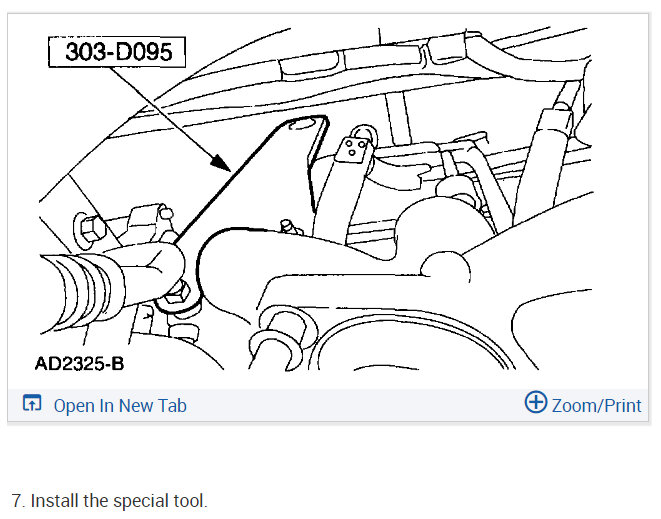

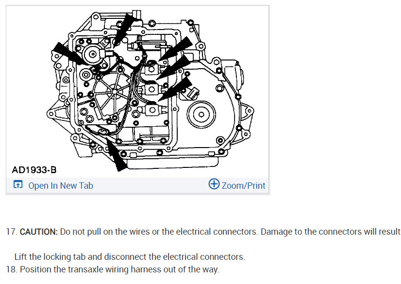

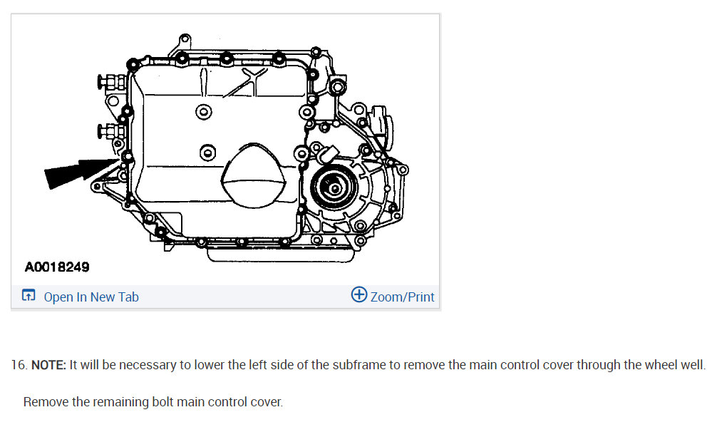

If the engine stalls abruptly then you have a torque converter that has fallen apart or the TCC solenoid is stuck on. You will need to remove the transmission pan to check the solenoid to see if it is working. If you put power and ground to it, it should click. Also, with no power you should not be able to blow air through it. The solenoid you want to check has the red/lt blue wires going to it. Check out the images (below). Please upload pictures or videos in your response of any problems so we can see what to help you with.

It sounds like the front pump went out and there is no fluid pressure, this is typically how they act when this kind of problem is happening. Please go over these guides and get back to us.
