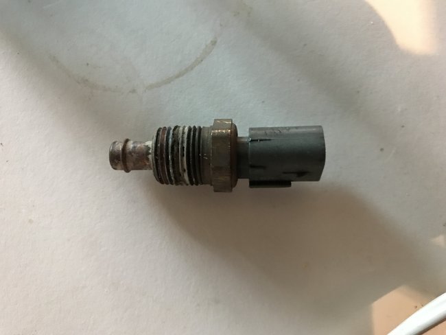

Just got done changing out the the coolant valve sensor P0128. Check engine light was still on and after connecting scan tool again came up P0197. Tried to erase the code, said erase successful, but came up with reading of P0197 again and check engine light still on. Can you please help!

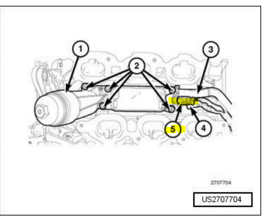

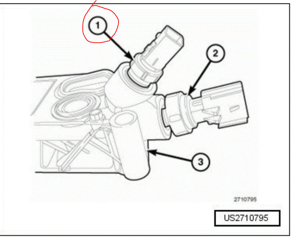

The oil temperature sensor is located on the oil filter housing. See the attached pic for location.

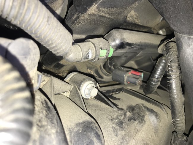

I’m looking at the area that your referring to from the diagram, and I can’t seem to find the right one. Here are some pics. Let me know if it could possibly be one of these.

It's really hard to tell what I am looking at in the pic. The sensor is under the intake at the rear side of the oil filter housing.

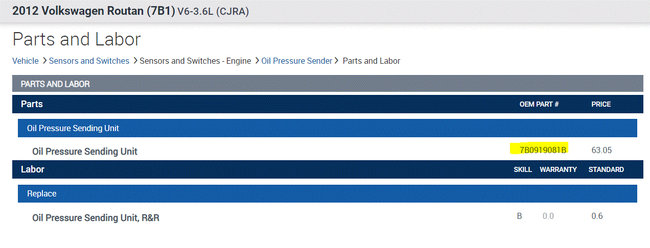

I was told that the same part is used for both sensor. Can you confirm?

I have the part number for the oil pressure switch, but there isn't a listing for the oil temperature sensor. I attached the part number for the oil pressure switch. In all honesty, I would think they function differently, so I question if they are the same part.
