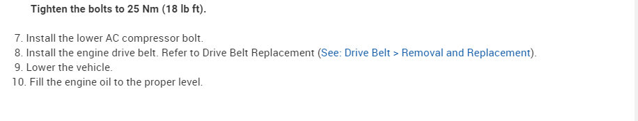

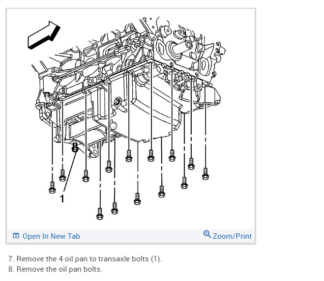

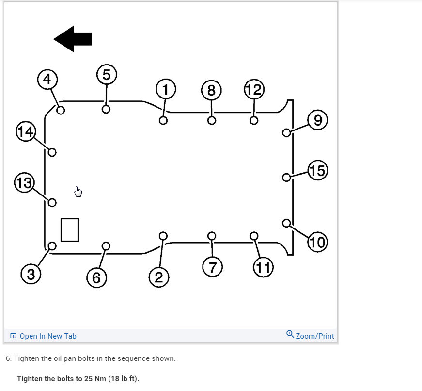

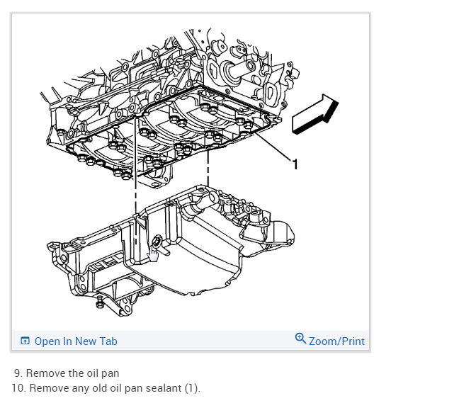

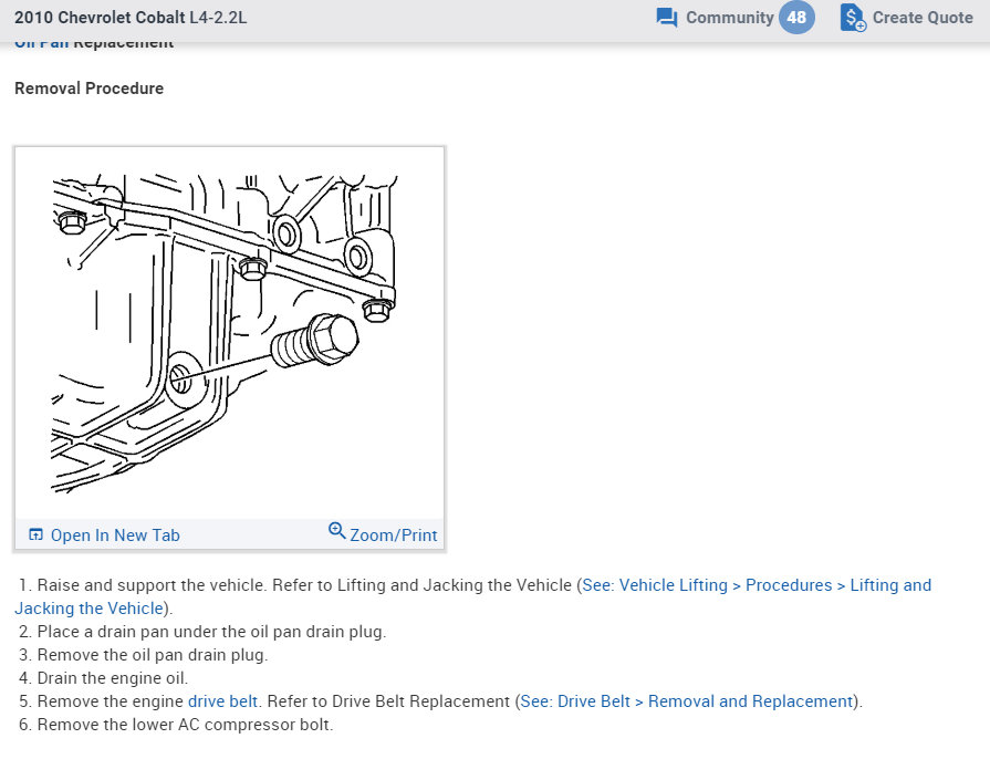

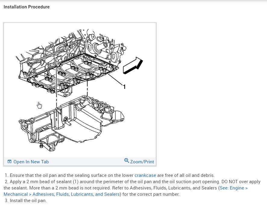

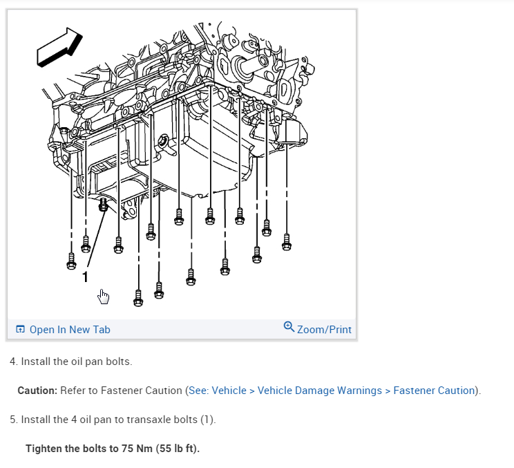

How do your remove and replace an oil pan on the car listed above? Can you remove all the bolts and just pull it off?
Jul 3, 2019 at 12:27 PM
Hi Duwhop31,
Here is the process for removing and installing the pan. Let me know if you need anything else. Thanks
Jul 3, 2019 at 12:46 PM
DUWHOP31
  • 153 POSTS
So you only have to take off the drive belt besides taking off the bolts of the oil pan?
Jul 3, 2019 at 3:19 PM
It also says the lower AC compressor bolt but I think this is just for clearance so I would play that by hear. Other than that, it looks like that is it according to the service manual.
