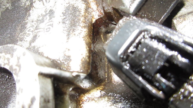

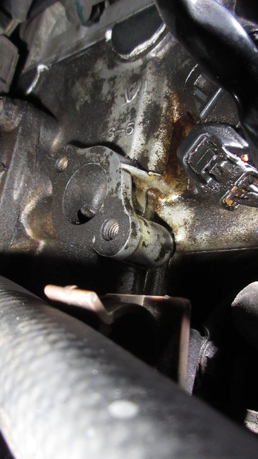

My car has an m13a engine. today i saw a engine oil leakage from the point shown in picture attached with this. please help me. i want to know what is this point and how i can solve this?

It looks like the sensor is leaking which is common just get a new sensor and O ring and replace them, this should fix the problem. It is difficult to see what you are talking about since there were no oil drips but that's what it looks like, if I am wrong please take more pics for me to look at.
Please let us know what you find so it will help others.
