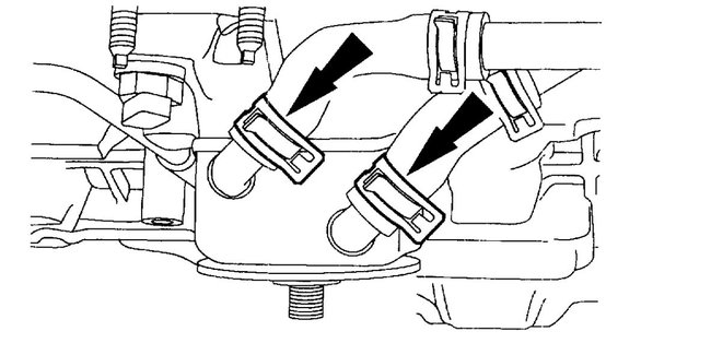

Engine oil in coolant overflow tank
2002 MAZDA TRIBUTE
200,000 MILES • 3.0L • V6 • 4WD • AUTOMATIC
VICMUN100
There is quite a lot of engine oil in the coolant overflow tank. However there is no water seen in the engine oil on the dipstick. Car can start nicely without any white smoke. There is a bit of fresh green coolant on the flow everytime I crank the engine.
Aug 7, 2018 at 8:58 PM
Good morning.
The most common failure for this issue is the oil cooler. It is attached to the oil filter adapter. It leaks internally.

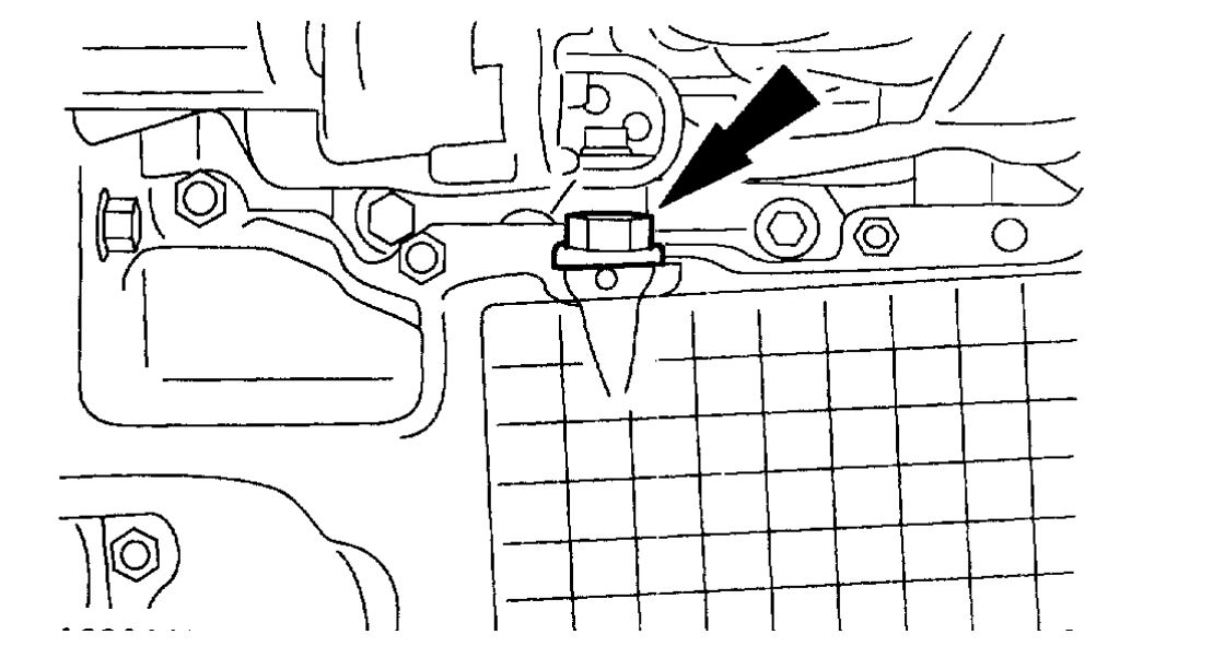

2. Remove the oil pan drain bolt and drain engine oil.
imageZoom/Print

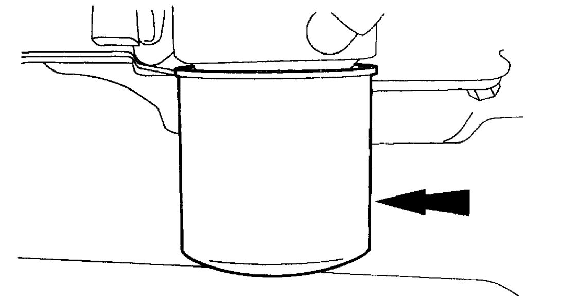

3. Remove the oil filter.
imageZoom/Print

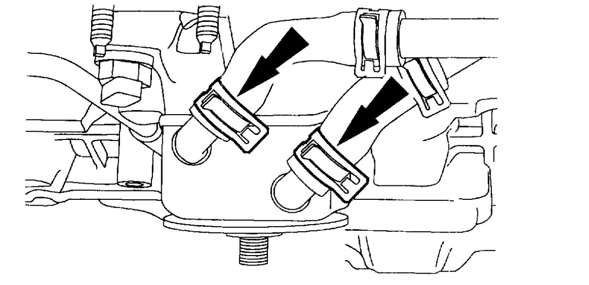

4. Disconnect the coolant hoses at the cooler.
imageZoom/Print

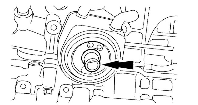

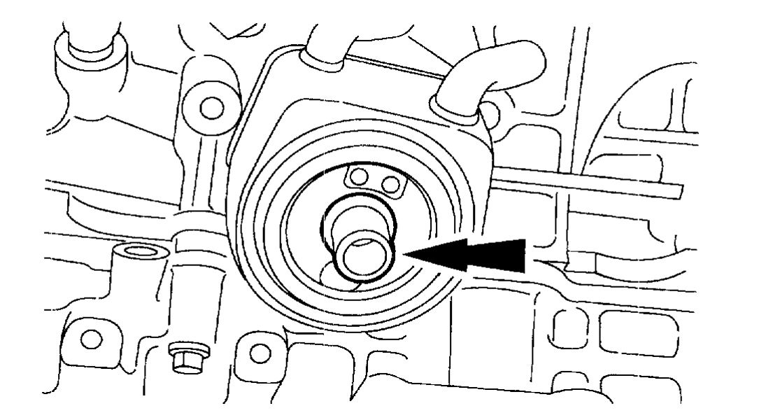

5. Remove the oil cooler.
6. To install, reverse the removal procedure.
