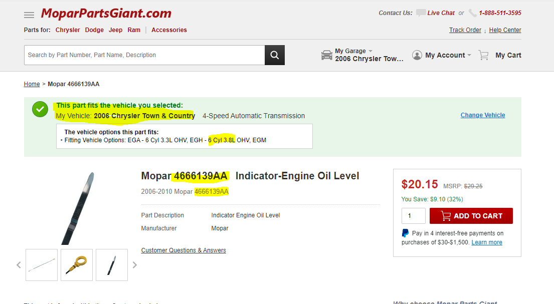

The OEM engine oil dipstick broke and the only replacement I can locate (Dorman # 917-320) is too long at a length of 24.19 inches. Apparently, two engine oil dipsticks were used on the 3.8L V6 in 2006. I need to know where I can buy a shorter length for this engine which hopefully will be the correct length.

The OEM part number is 4666139AA. They are available. Also, there were two engines that were offered in this vehicle, a 3.3L and a 3.8L. Both engines use the same part so I'm not sure what you received.
Take a look below. I attached a pic of what is needed. I highlighted the part number, engine size, and that it is a confirmed fit.
Let me know if this helps. Also, with the part number, see if you can find a better price.
See pic below.
