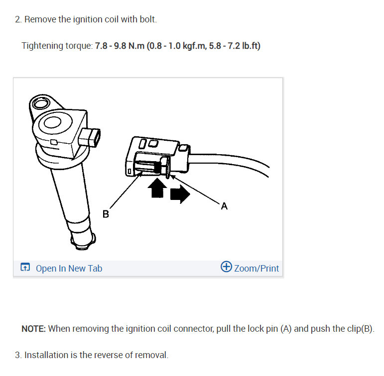

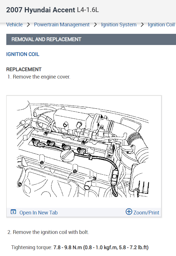

No, this is not normal, 1,000 is about 621 miles, so it sounds like something is wrong like you have a broken oil control piston ring. I would remove the spark plugs for inspection to see which cylinder is having the issue, this guide can help:
https://www.2carpros.com/articles/how-to-change-spark-plugs

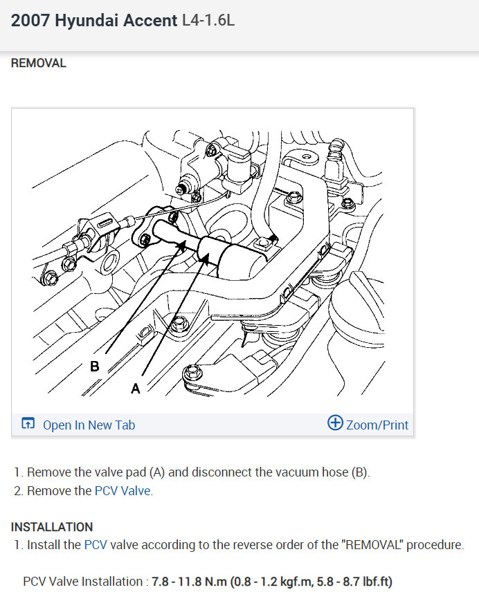

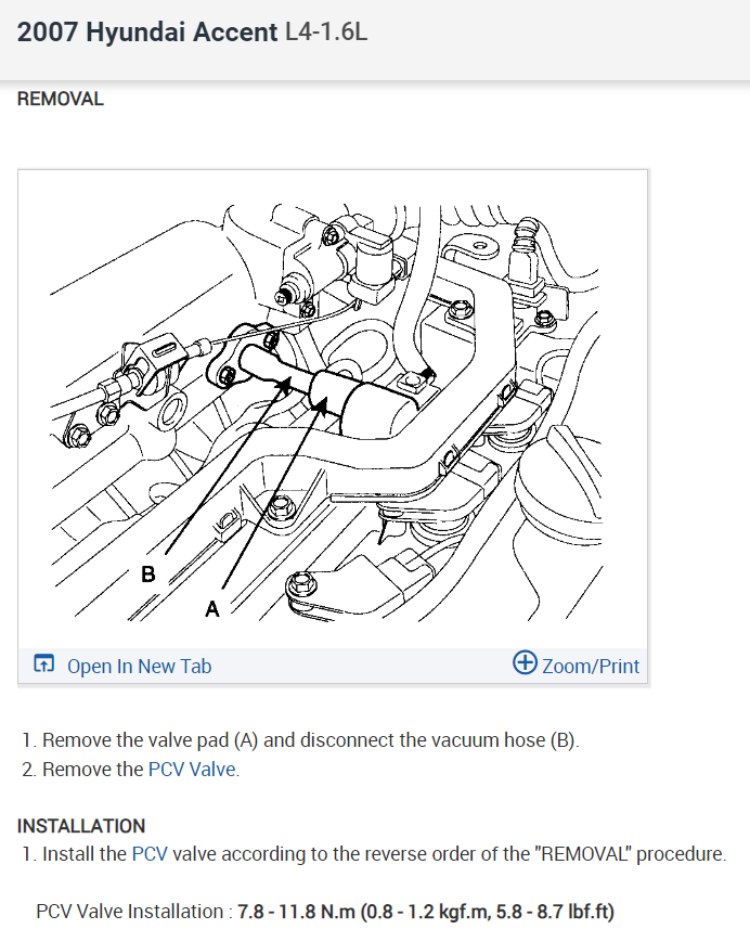

Also, it could be the valve stem seals or the PCV system. Here is the location of the PCV so you can change it out which is what I would do as well because this is a normal service item. Also, can I ask if the engine is burning oil? Please go over this guide:
https://www.2carpros.com/articles/blue-smoke-from-engines-exhaust
Spark Plugs
Type
NGK .................... BKR5ES-11
CHAMPION .................... RC10YC4
Check out the images (below). Please upload pictures or videos in your response to the problem so we can see what's going on.
