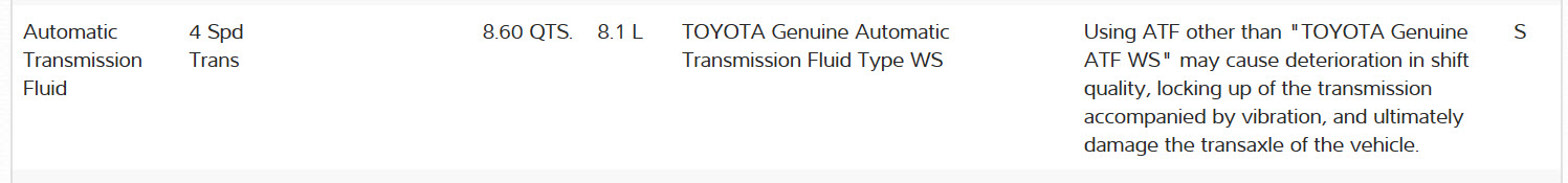

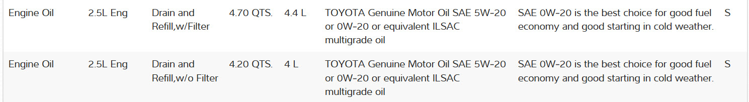

How often must be replaced the oil and filter? What type of oil should I use? Blend Synthetic or Fully Synthetic? How often must be replaced the ATF Automatic Transmission Fluid? Note: I would appreciate it the right answers for my car. Thank you very much for your desire answer these questions. The Lord bless you.

recommended service changes are in your owners manual.synthetic oil is best and semi synthetic is 25% synthetic oil. synthetic can use longer oil changes like 10,000 miles if you switch to synthetic there will be some oil usage at start. information i am sending is also in your owners manual.
