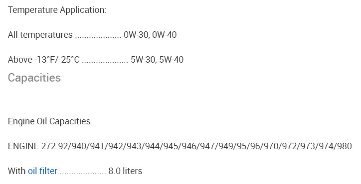

What weight oil should I use?
May 1, 2020 at 12:33 AM
DANNY L
Experienced Mechanic
5,648 POSTS
Hello, I'm Danny.
I have attached the information you requested below.The weight oil to use is determined by the climate in your area,see below.Hope this helps and thanks for using 2CarPros.
