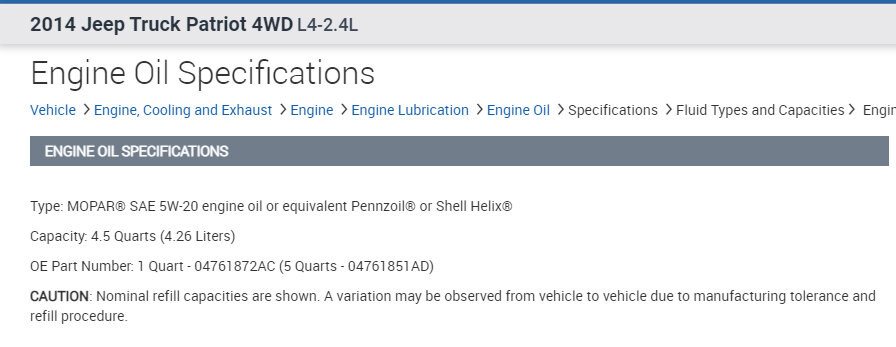

This is a dumb question but what kind of engine oil does my vehicle listed above use?
I bought it and don’t know what kind oil is in there, what if I get wrong brand or kind?
Mar 3, 2023 at 10:23 AM
  • 110,194 POSTS
This isn't a dumb question at all. However, the brand you use doesn't matter. The vehicle requires 5w20 oil. You can get this in a conventional oil, semi-synthetic, or a full synthetic type.
Because of the mileage, I would recommend getting a semi-synthetic.
See pic below.
