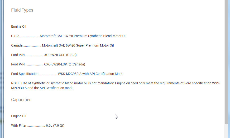

How many liters of engine oil can fit the engine ?
May 21, 2021 at 10:31 PM
This engine requires 6.6L (7 quarts) if you are changing the oil and filter.
Here is a guide that will help with this if you need it:
https://www.2carpros.com/articles/how-to-change-engine-oil-and-filter
Below is the full document from the manual that includes part numbers if you need that as well.
