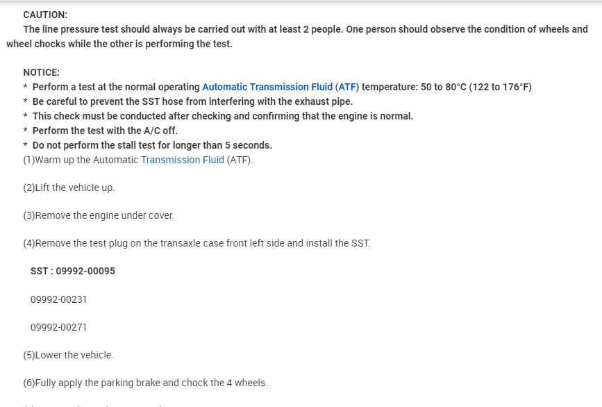

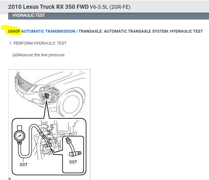

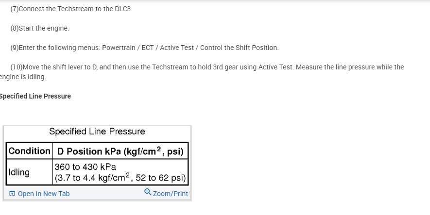

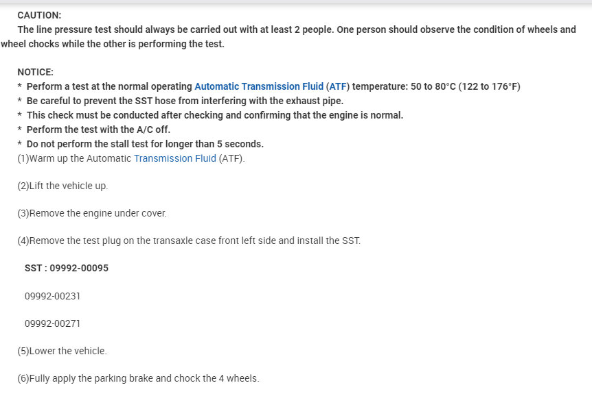

  • 110,248 POSTS
The converter would need to be replaced.

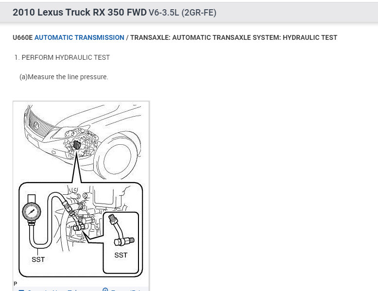

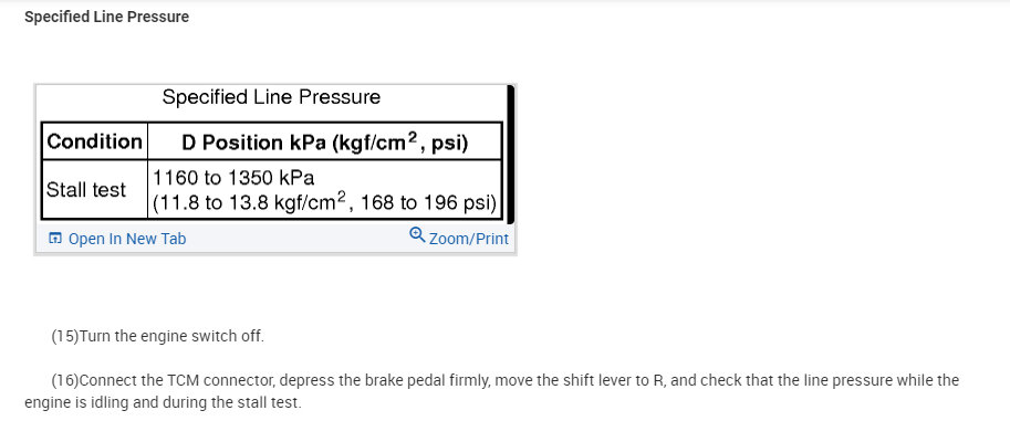

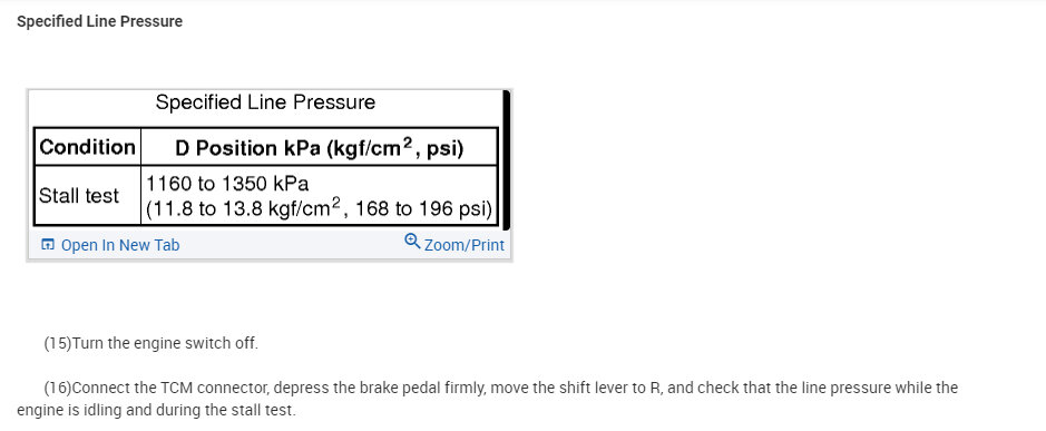

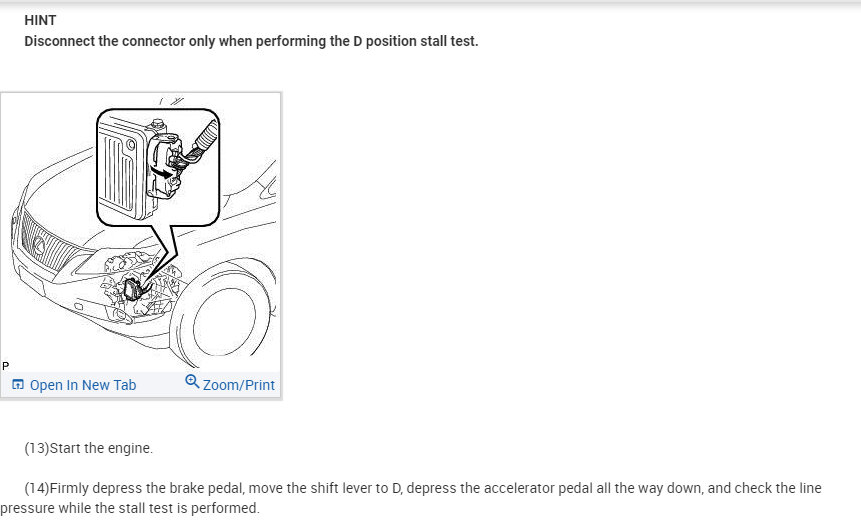

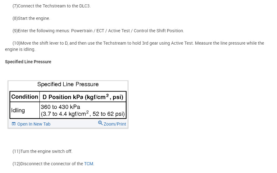

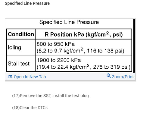

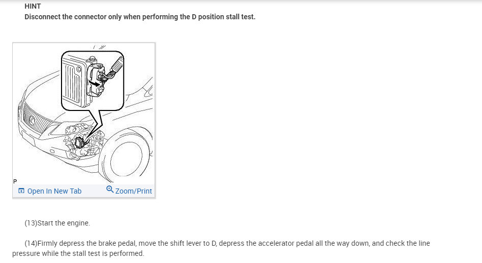

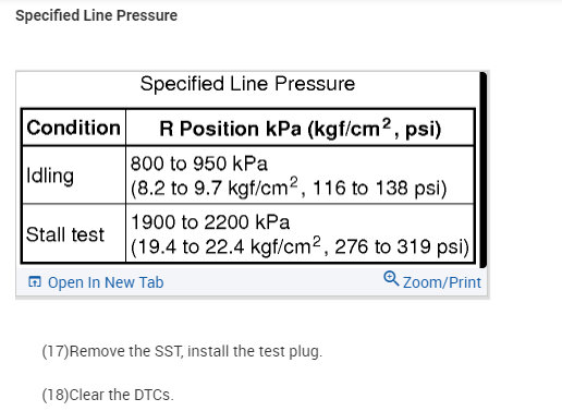

There are two different transmissions for this vehicle. I attached the directions for testing line pressure below.
The first 7 pics are for the U660E transmission, and the remaining are for the U660F.
I hope this helps.
Oct 19, 2022 at 10:42 AM

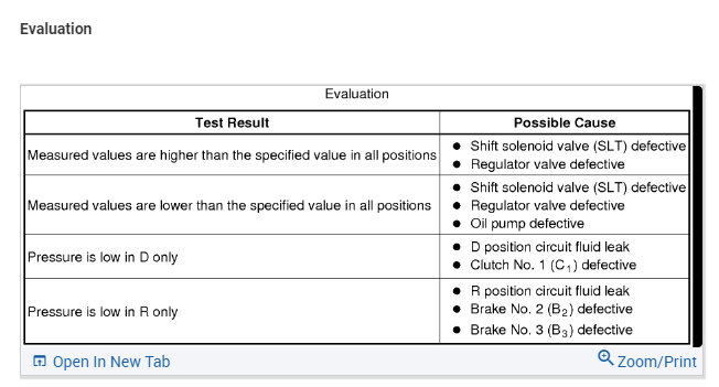

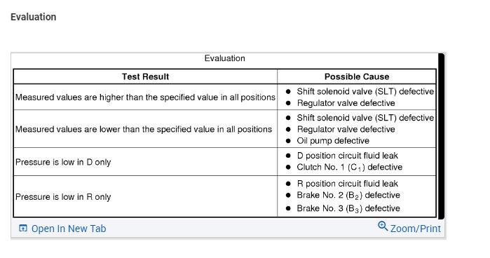

BLESSING EWOBOR
  • 753 POSTS
Good evening sir,

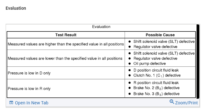

sir, concerning the test result of the one of the images sent (last image).
1. "D position circuit fluid leak" does it mean the circuit leak in the valve body or the transmission?
2. "clutch no. 1 (C1) defective"
does it mean that there is hole in the clutch or burnt clutch plate to have low pressure?
Oct 21, 2022 at 9:20 AM
  • 110,248 POSTS
The leak would likely be internal (valve body). As far as the clutch being defective, that could indicate a few things. Something could be preventing it from engaging, clutches have failed, but I don't think a hole is likely.
