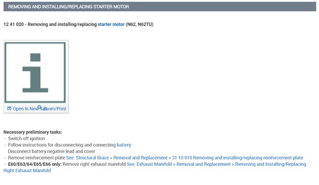

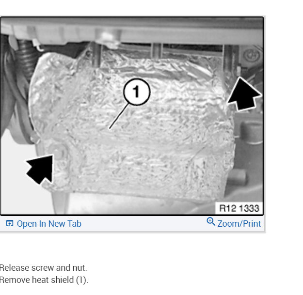

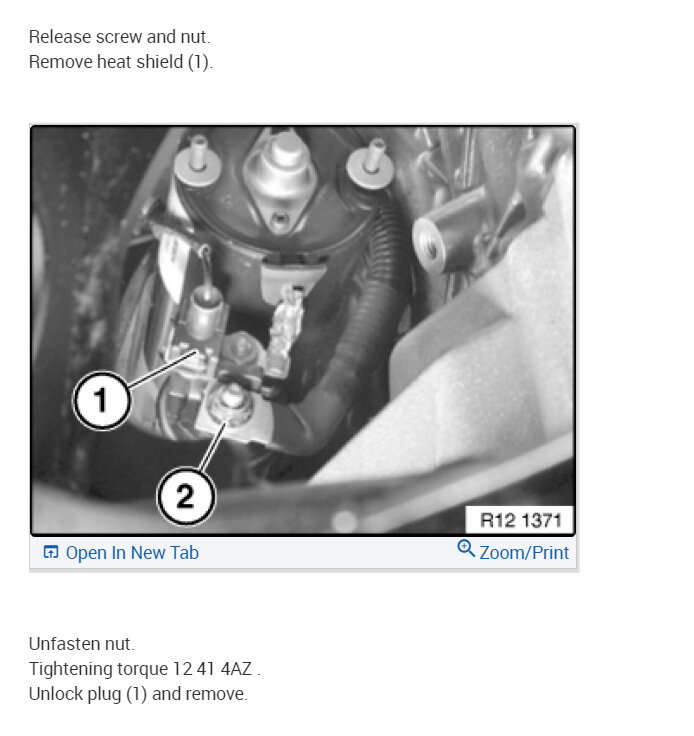

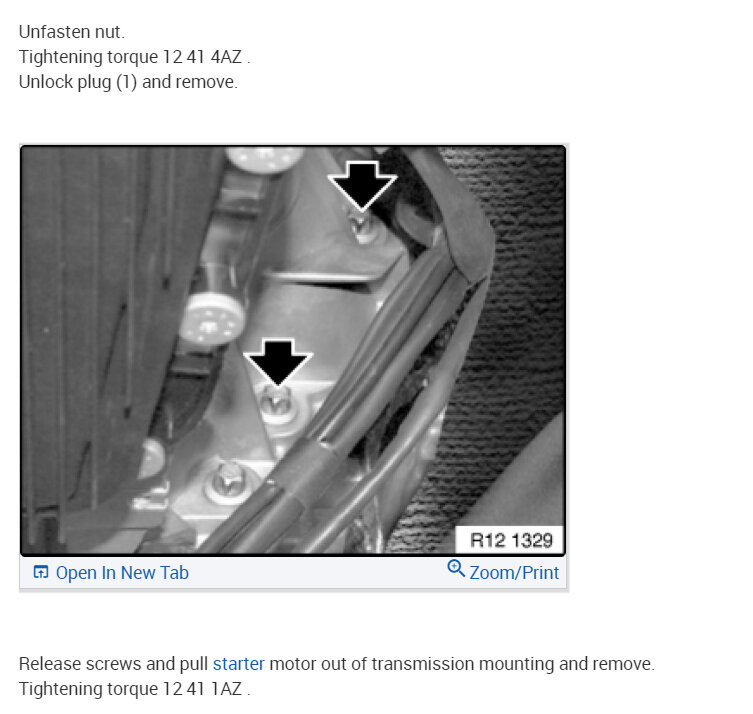

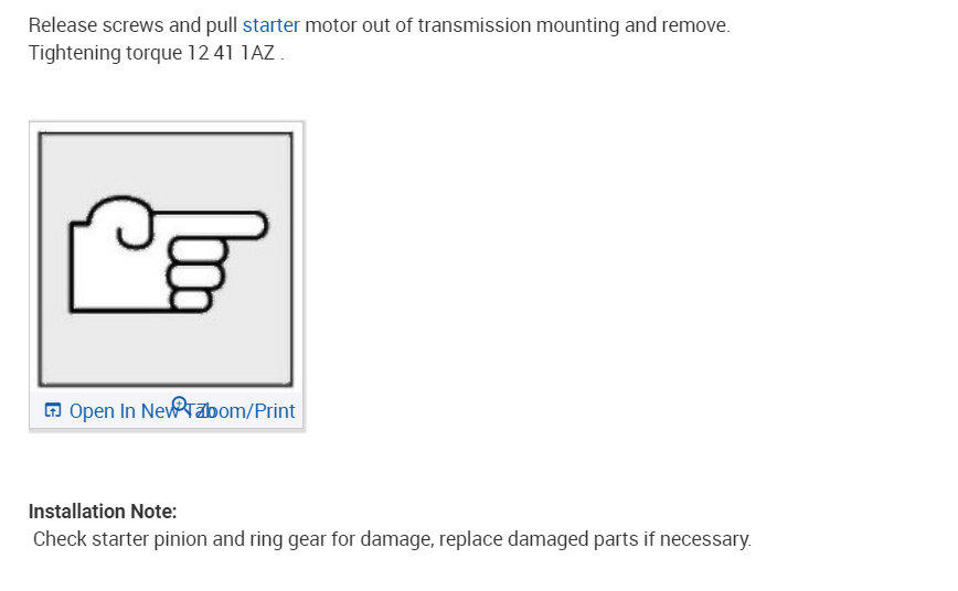

It does sound like the starter is going out or you have a bad connection at the battery. These two guides can help, and I have included how to change out the starter in the images below.
and
