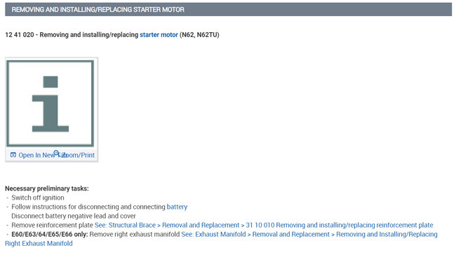

I drive my car for a while, park it, and then come back to it, the key would turn all the way, all the electricity in the car would come on, but the engine wouldn't crank over. I noticed the past few times if i waited 10-15 minutes i could get it to crank and I'll be on my way, or if i was lucky enough i turn the key all the way and hold it and then it would crank. The keys are old, I notice i have to get close to the car to even unlock it, so maybe it's the key, I'm not too sure. Haven't checked the starter yet but will very soon. Please help me.
Jul 9, 2023 at 12:14 PM
  • 55,219 POSTS

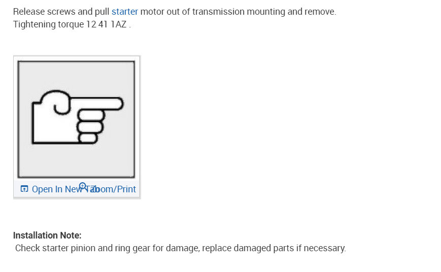

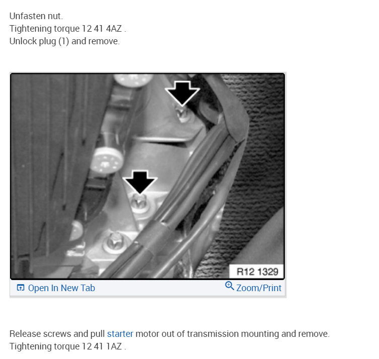

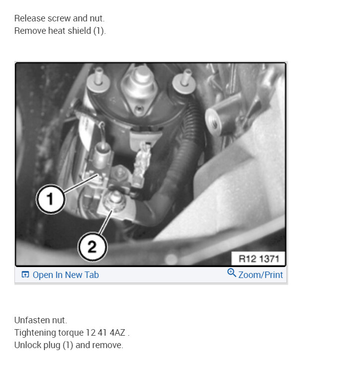

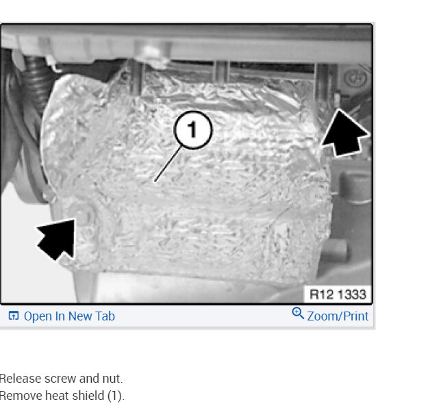

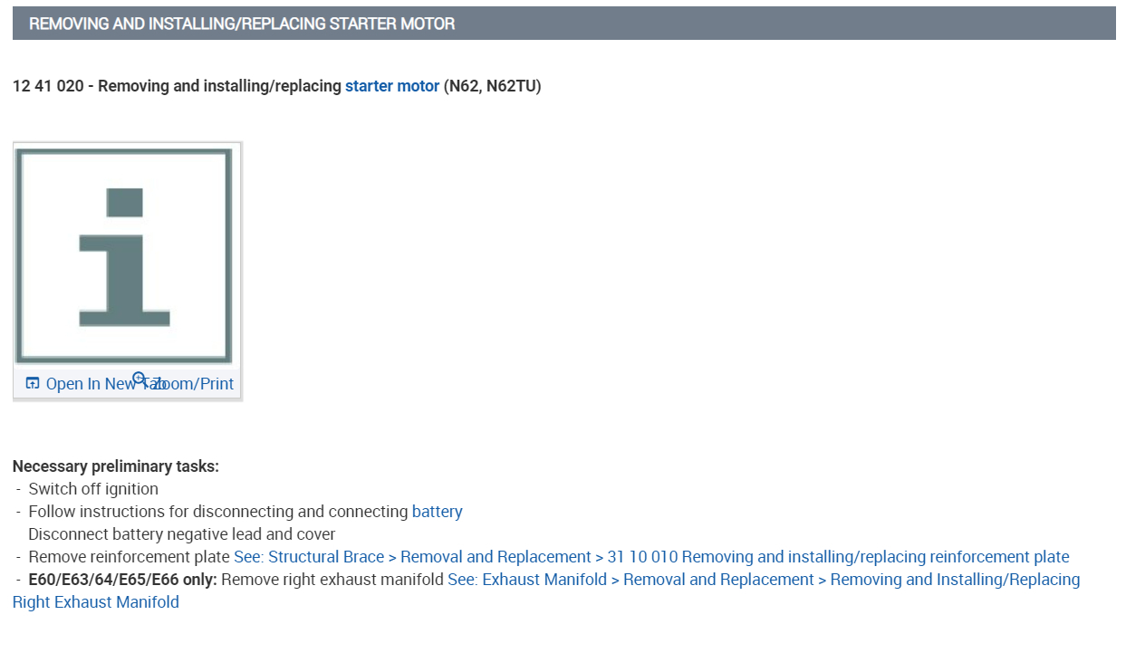

It does sound like the starter is going out or you have a bad connection at the battery. These two guides can help, and I have included how to change out the starter in the images below.
