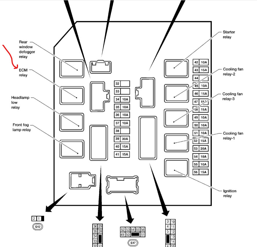

engine cranking but not starting. I would like to know the location of the ECM relay and color.

Sure, here is the location of the PCM relay and I have included a guide to help test it if needed.
Check out the images (below). Let us know if you need anything else.

my IPDM has only 4 relays and fuses.

Hmm, can you please upload an image of it?
