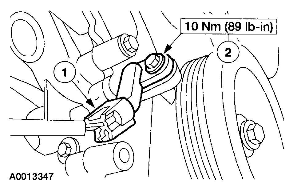

Where is my crankshaft sensor located? I think is bad?

This sounds like a fuel pump or the crankshaft angle sensor has gone out. When you turn the key to the on position without cranking the engine over can you hear the fuel pump run in the tank for 5 seconds?
It located on the left of the crankshaft pulley at the front of the engine. Here are the directions for replacement. The attached pic correlates with the directions.

2001 Ford Truck F 150 4WD Pickup V8-5.4L SOHC VIN L
Procedures
Vehicle Powertrain Management Sensors and Switches - Powertrain Management Sensors and Switches - Computers and Control Systems Crankshaft Position Sensor Service and Repair Procedures
PROCEDURES
REMOVAL
1. Remove the A/C compressor.
pic 1
2. Remove the Crankshaft Position (CKP) sensor.
1 Disconnect the electrical connector.
2 Remove the bolt and the sensor.
INSTALLATION
1. To install, reverse the removal procedure.
