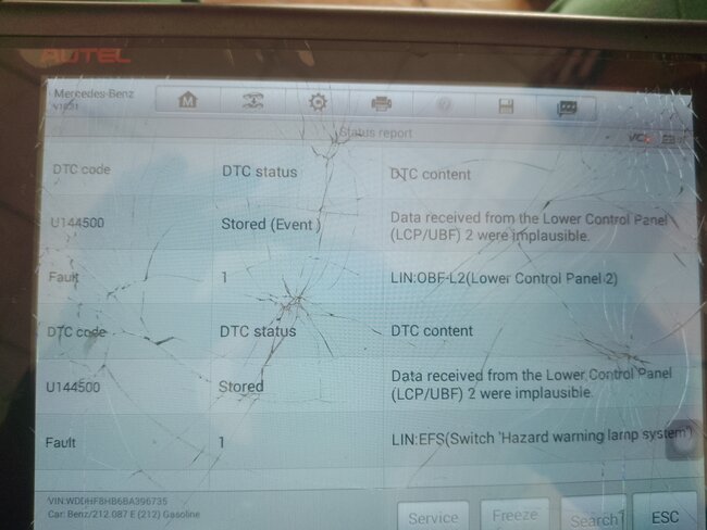

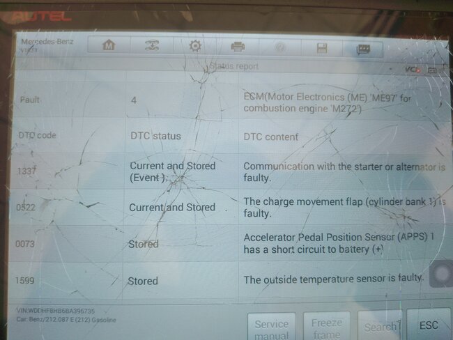

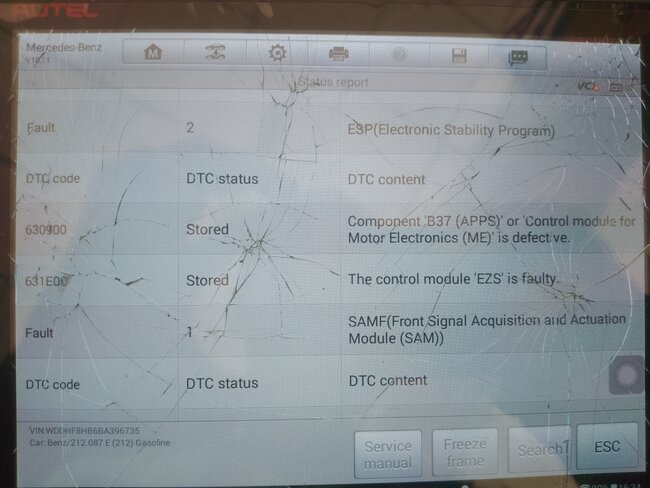

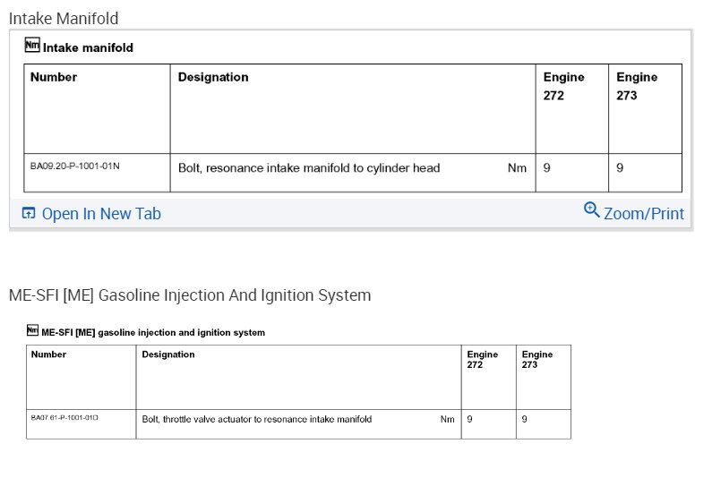

The vehicle's engine is working very fine but sometimes it goes into limp mode, at this point the engine will not rev even though the gas pedal is pressed. The battery voltage is 14.02V whenever the engine is working.
Below are the scanned results.
What could be the cause?
Nov 10, 2023 at 12:29 AM
  • 55,381 POSTS

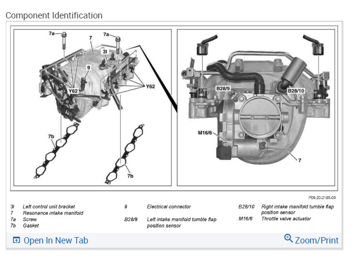

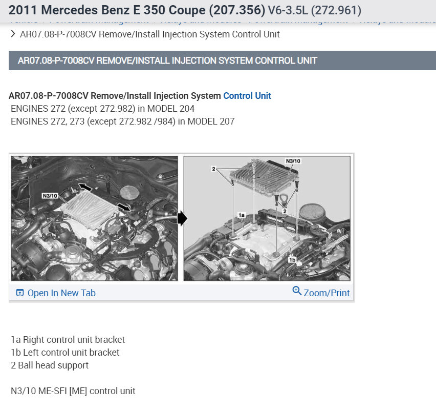

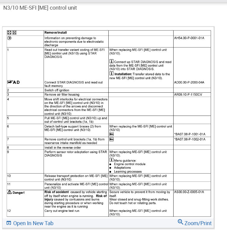

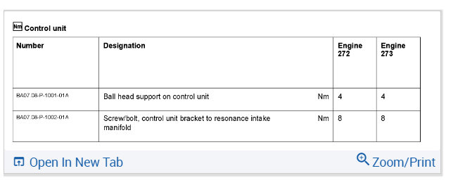

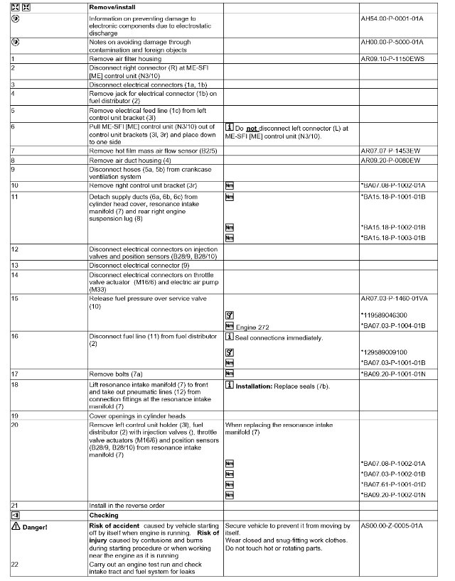

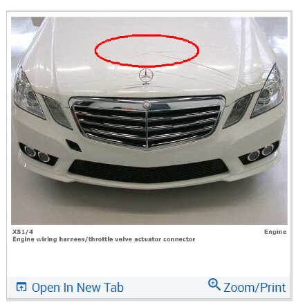

The code # 630900 tells us the engine control module is no good, here is the location and how to change it out. You can get a preprogrammed unit by searching Google or Ebay. Once the unit is replaced clear all codes in the CAN before you try starting the engine. Check out the images below. Let us know how it goes.

The code is stored not current, could it still has effect. Thank you sir.

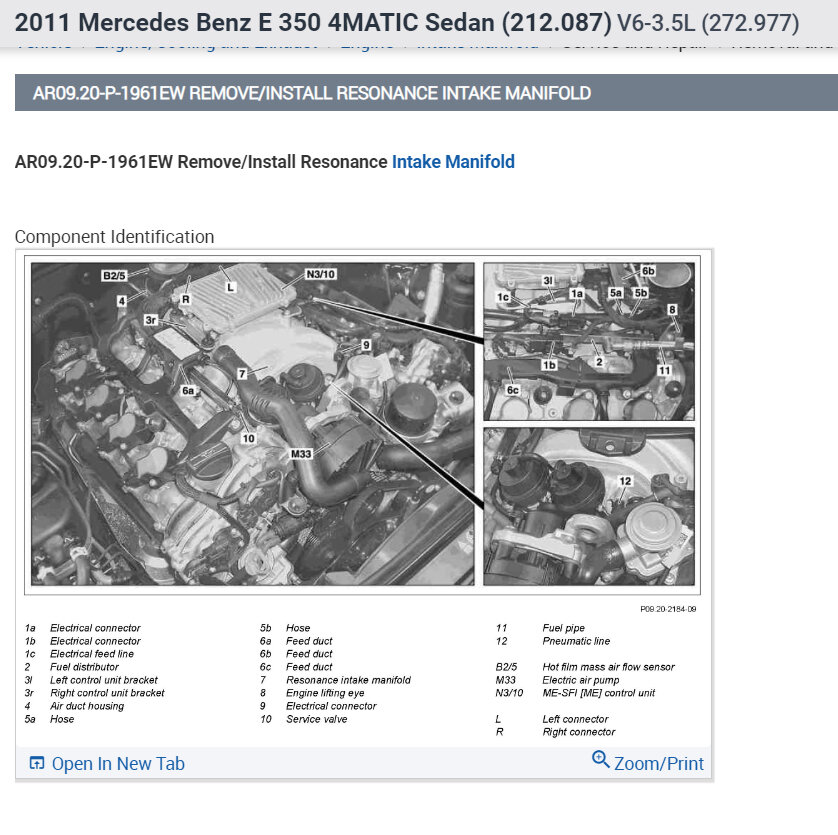

Can you clear the codes and try to start the engine to see if it comes back? You may need to try and drive it, also I have seen a dirty through bore cause this problem as well if the code doesn't come back.
Here are two guides to help us fix it:
and
https://www.2carpros.com/articles/reduced-power-limp-mode

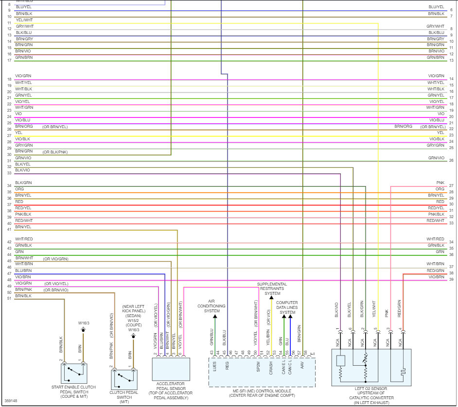

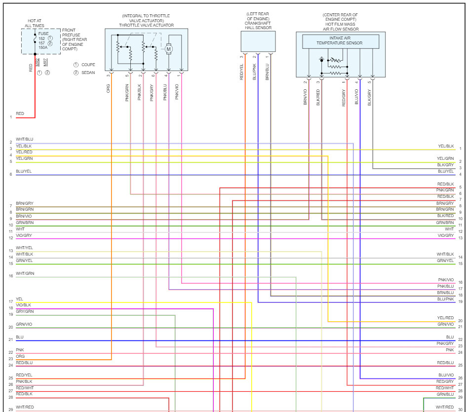

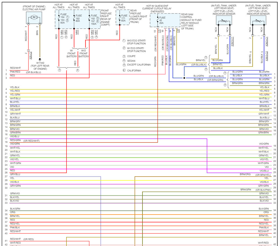

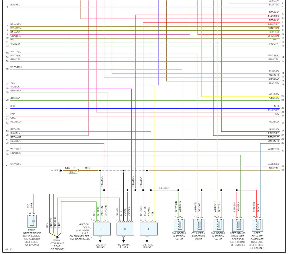

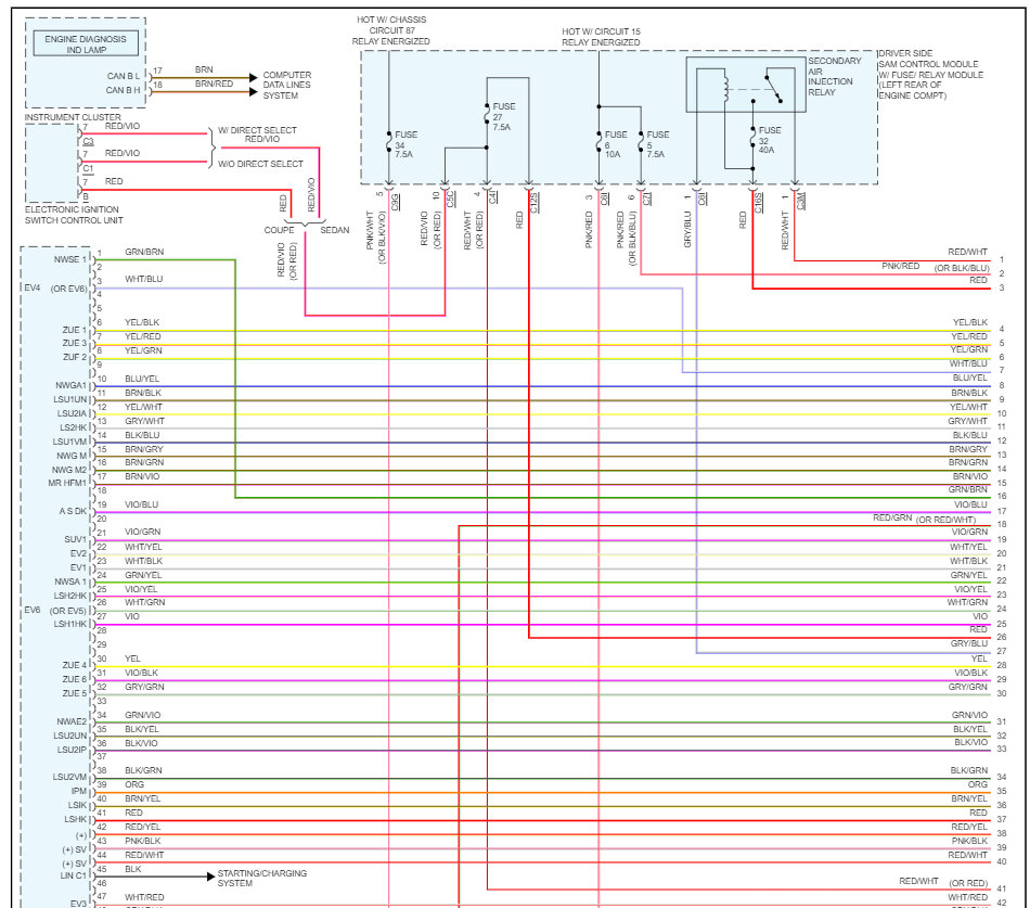

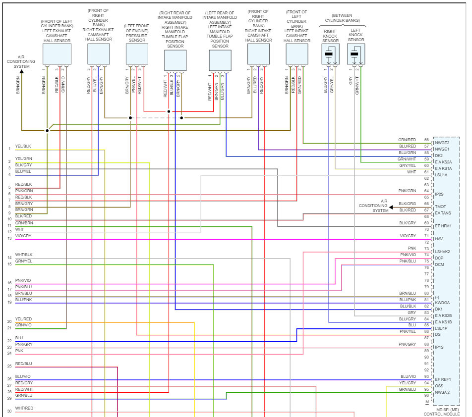

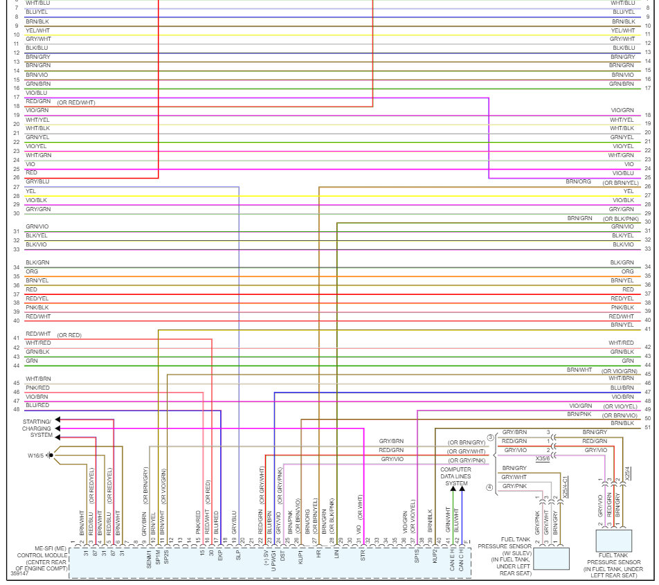

Good evening,

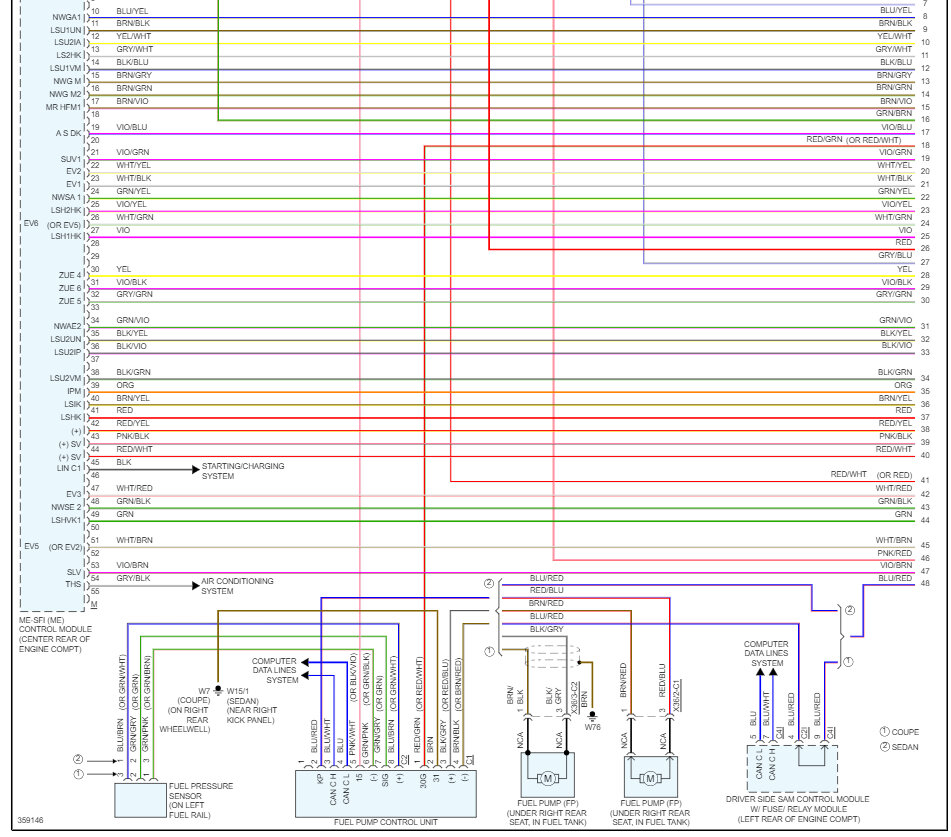

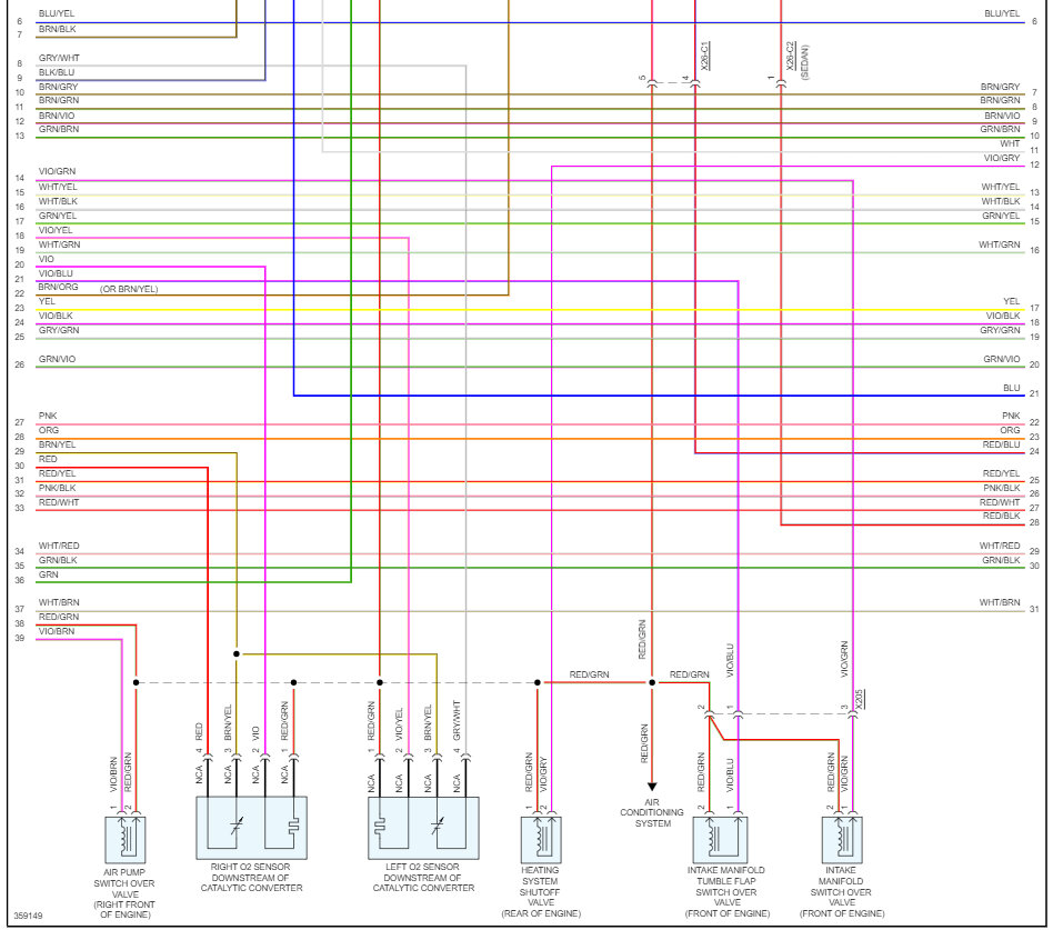

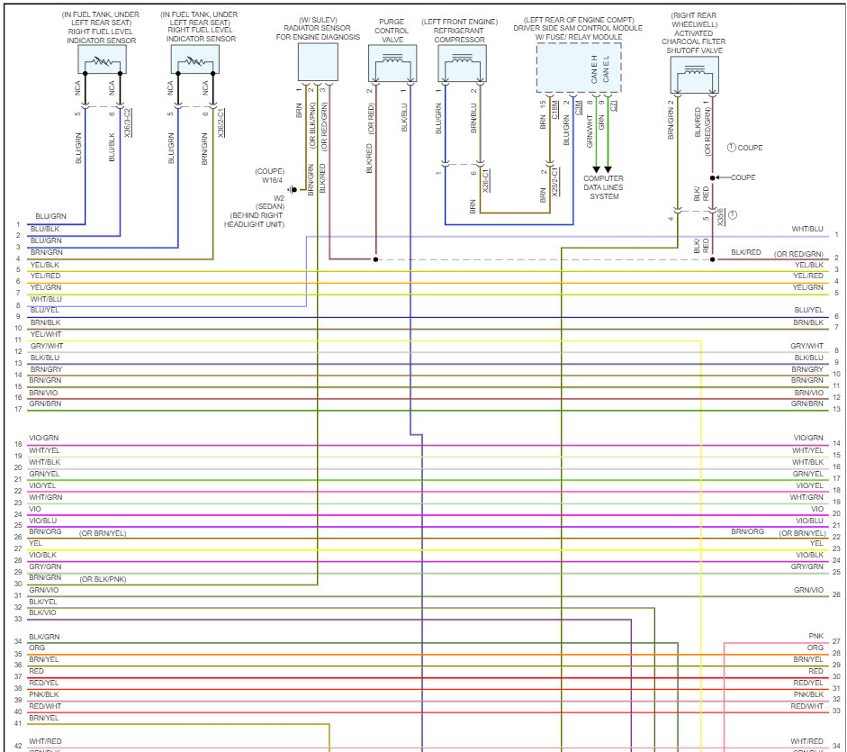

Please could you help me with wire diagram showing the grounds with the locations?
Thank you
Nov 13, 2023 at 12:48 AM

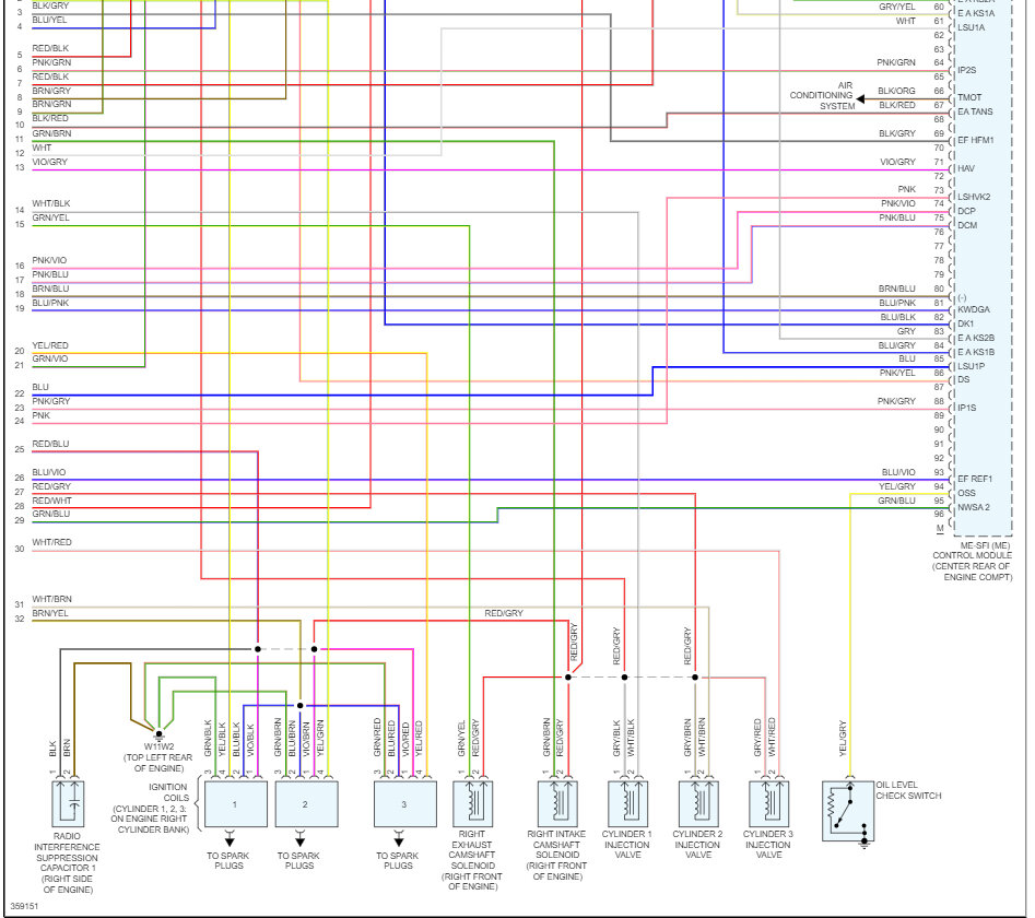

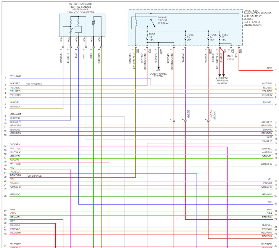

  • 55,381 POSTS

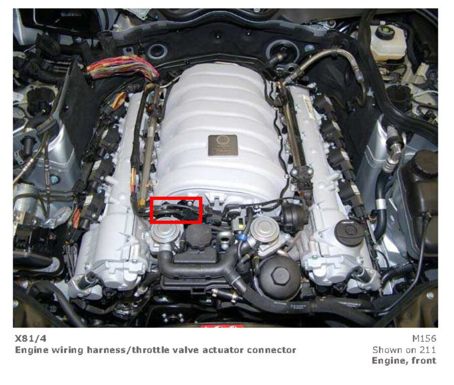

Engine grounds? Engine wiring diagrams? If so, here are the engine wiring diagrams and a guide to help with the testing which shows the ground locations:
Nov 13, 2023 at 2:14 AM
