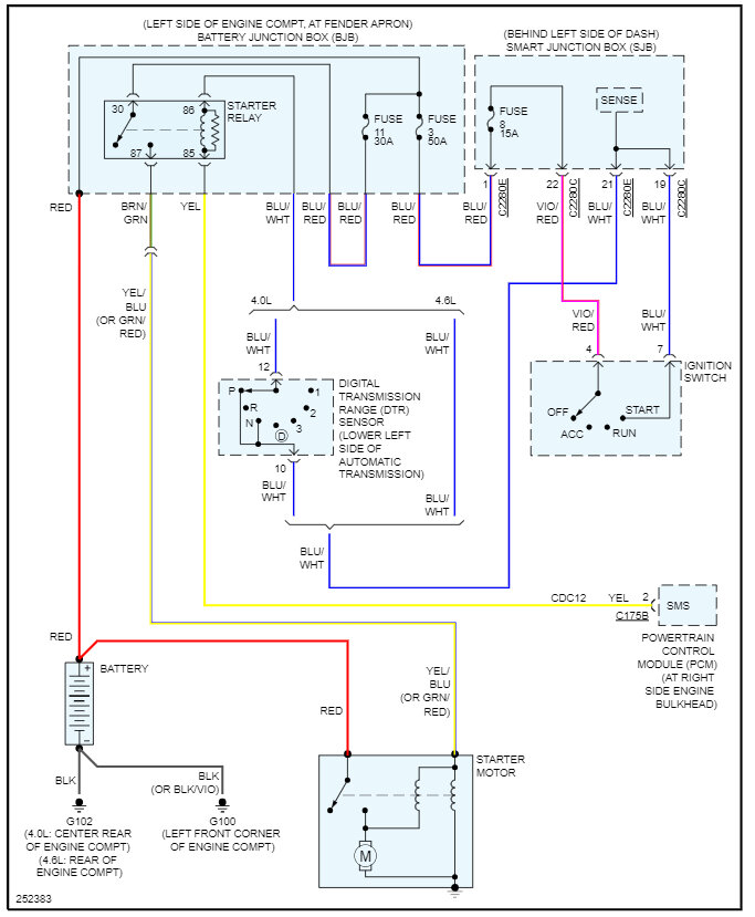

I am sorry to hear about your mom, it is never easy to lose a parent. It sounds like the starter relay needs to be replaced. here is the location so you can swap it out. Also please go over this guide:
Here is the starter wiring diagrams so you can see how the system works. Check out the images (below). Please let us know how it goes

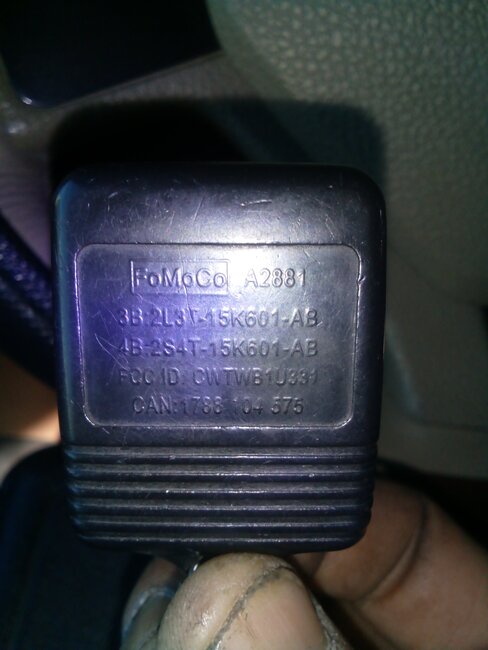

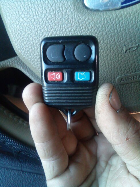

Please upload images of the remote both front and back so I can see if it is factory or not?
Jul 24, 2023 at 4:20 AM
MANUELD1977
  • 41 POSTS
It's factory key fob for truck it says FoMoCo on top of alarm fob in rear of it also.
Jul 24, 2023 at 11:08 AM
MANUELD1977
  • 41 POSTS

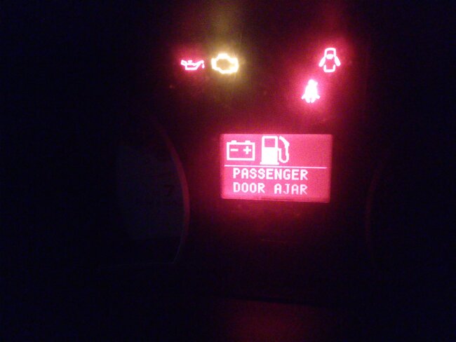

As you can see it's. Factory alarm system dash cluster doesn't have no security system light on dash or no security sign on dash cluster when put key in and turn it only light for alarm is a blinking red one on top of dash in middle where windshield and dash would come together at and meet. Send another picture of that to you but once truck is started up alarm light doesn't blink just when I set alarm on t to u cc k is when it blinks. When gets little cooler and darker will make video for you showing you exactly everything telling you and what and how I get truck to start up every time I want or have to go anywhere.
Jul 24, 2023 at 11:17 AM
MANUELD1977
  • 41 POSTS

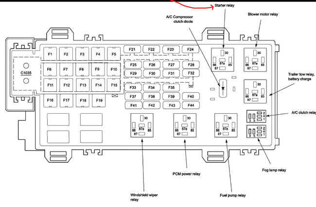

That's what the dashboard cluster in my truck looks like when I put key in the on position. As you see there's no security sign or word security anywhere on dashboard cluster. In the next picture I send it's going to be of the red blinking light in middle of dashboard by the middle of windshield it's on alarm light on truck. Also, I came across an image of my power distribution panel that is in my truck according to their diagram it's saying that slot 56 B is where my starter relay is located at. Can you verify if that's correct? Can't send picture of just yet but will shortly when tablet is charged up.
Jul 24, 2023 at 3:06 PM
  • 55,402 POSTS
Okay yes, please send images, they don't tell us slot number can you upload an image of the fuse panel and where the relay is missing?

So, sorry for the super late response and update about my engine not cranking with key turn to start position. So, to update you gentlemen over at 2CarPros on the results of issue and fix for it. After the process of elimination of possibilities and replacing few well needed replacing parts and few hundred dollars later the issue was what I was suspecting it was but was fooled by few other points still in operating condition. If you recall I was able, get full power and control of all lighting and gauges of truck when turned key just wasn't getting engine cranking over. Comes out to be whole time problem was ignition switch just the one individual prong in switch that made contact and gave signal to relay to send signal to starter to crank was burned out rest of switch prongs was good except the one prong that signaled relay and starter to crank was dead. Replaced ignition switch and issue free since. I just really wanted to respond and give update in case anyone else is ordoexrun into same situation. Thank you gentlemen for all advice and direction to look into as possibilities.
