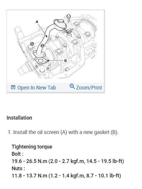

The oil light comes on when only turning and I've noticed a rattling/humming noise from the engine and engine seems to lose pressure when accelerating from a turn or stop. Oil level is fine and has been taken to a mechanic shop, but they only replaced the wheel bearings which was not a fix to this noise. I don't want to destroy the engine. What could this possibly be?
Aug 19, 2022 at 5:24 AM
  • 55,712 POSTS

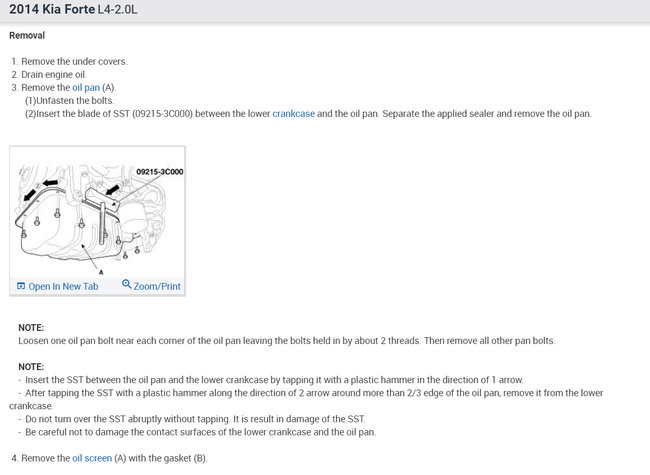

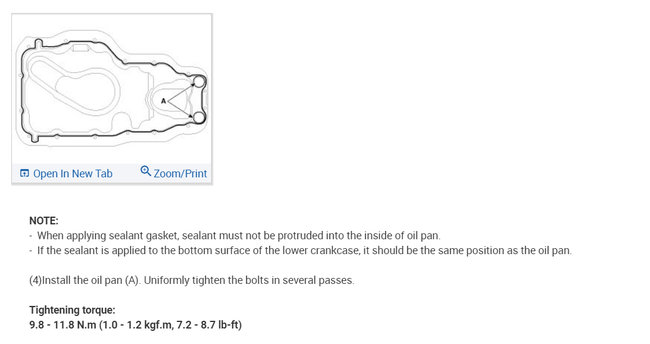

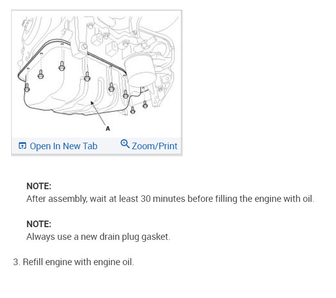

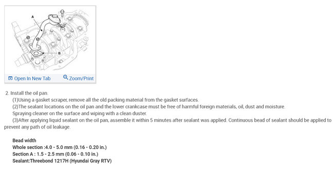

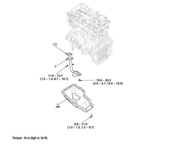

What happens is the if the oil changes have not been kept up is that sludge will develop inside the engine and plug up the oil pump intake. I would drop the oil pan and clean it. here is how the job is done. Make sure to roll on a new oil filter as well.
