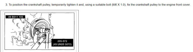

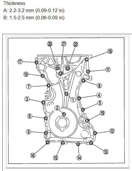

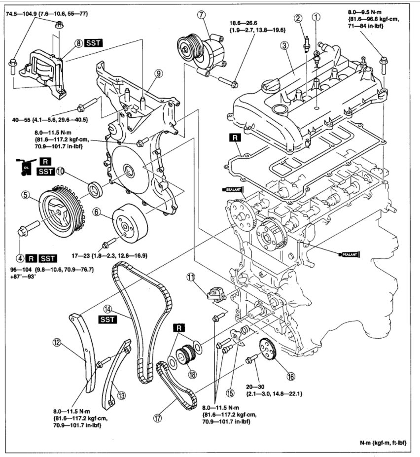

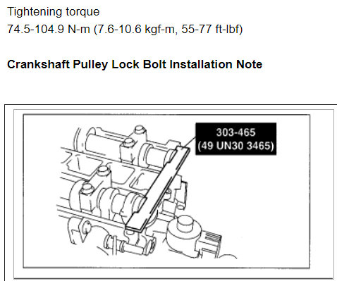

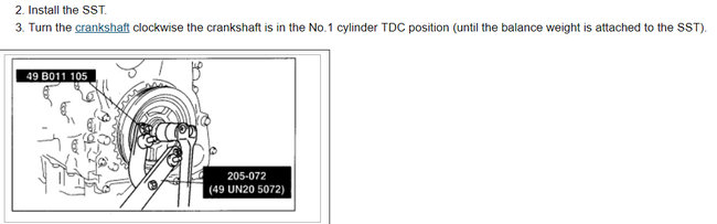

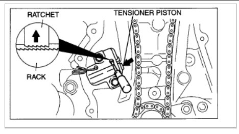

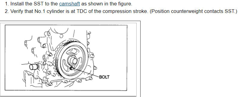

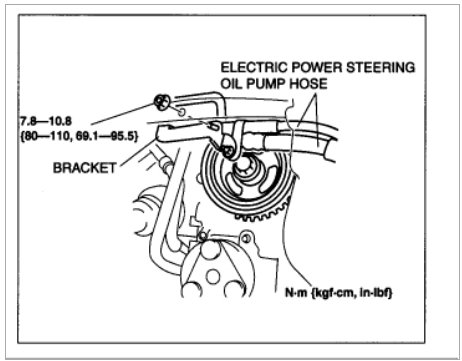

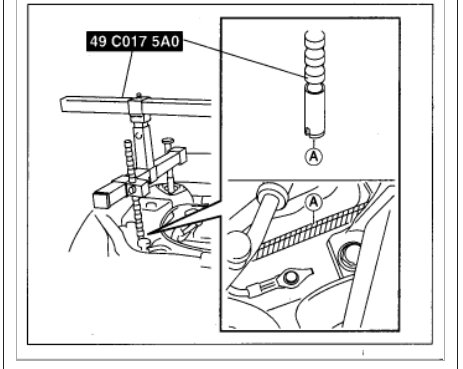

Thanks for the video, it makes my job way easier. It looks like you lost the timing chain guide. I assume it has more then 31,000 miles on it?
You will need to pull the front balancer to get started.
https://www.2carpros.com/articles/how-a-harmonic-balancer-works
Then remove the front cover and check for damage, I would replace the chain and all guides while you are in there. If you have the job done it should run about $1,100.00.
