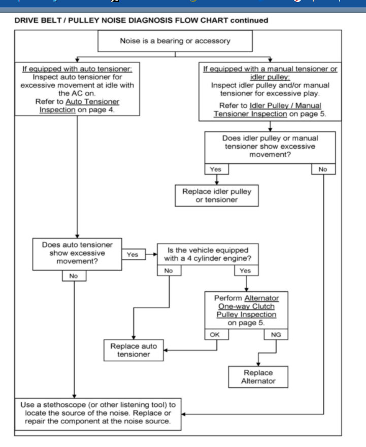

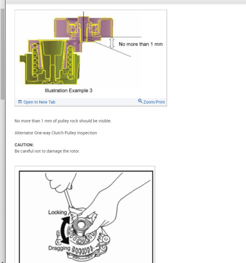

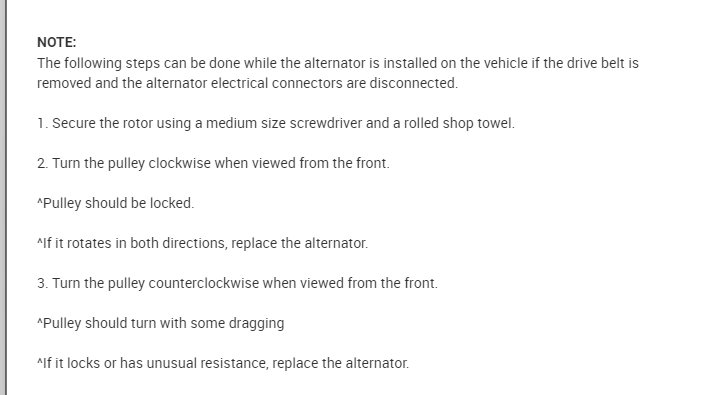

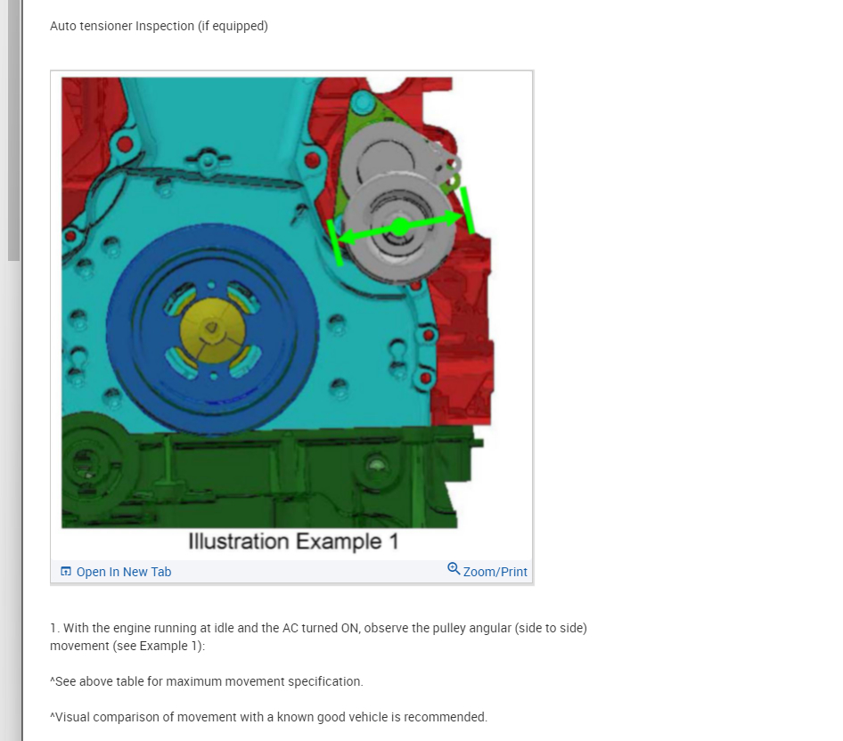

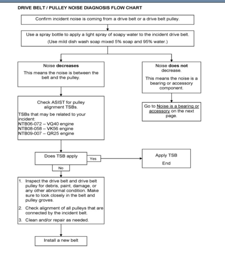

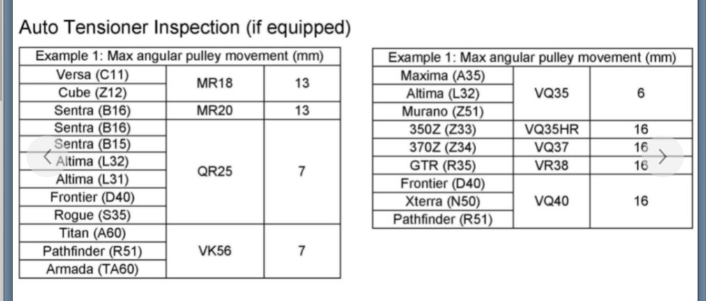

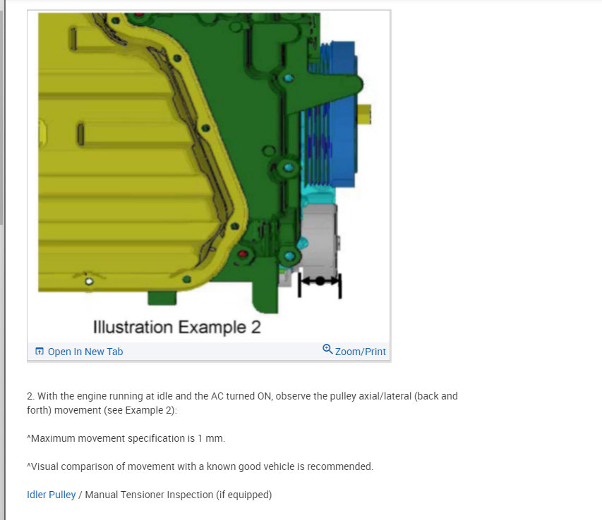

Can you get a recording of this noise? This sounds like a possible compressor issue, but we need to confirm this because they can make a rattle noise at times.
Basically, when the clutch engages and disengages it creates a wear pattern and this can create a rattling noise when the compressor is engaged.
So, hearing this noise, we will have a better idea what the issue could be, but I would suggest removing the belt and find out if the noise stops. That will confirm this is a drive belt issue.
I am also attaching a TSB that will help diagnose possible belt related issues so let's start with this and go from there. Thanks

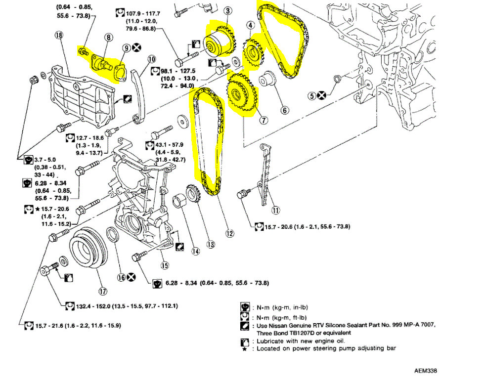

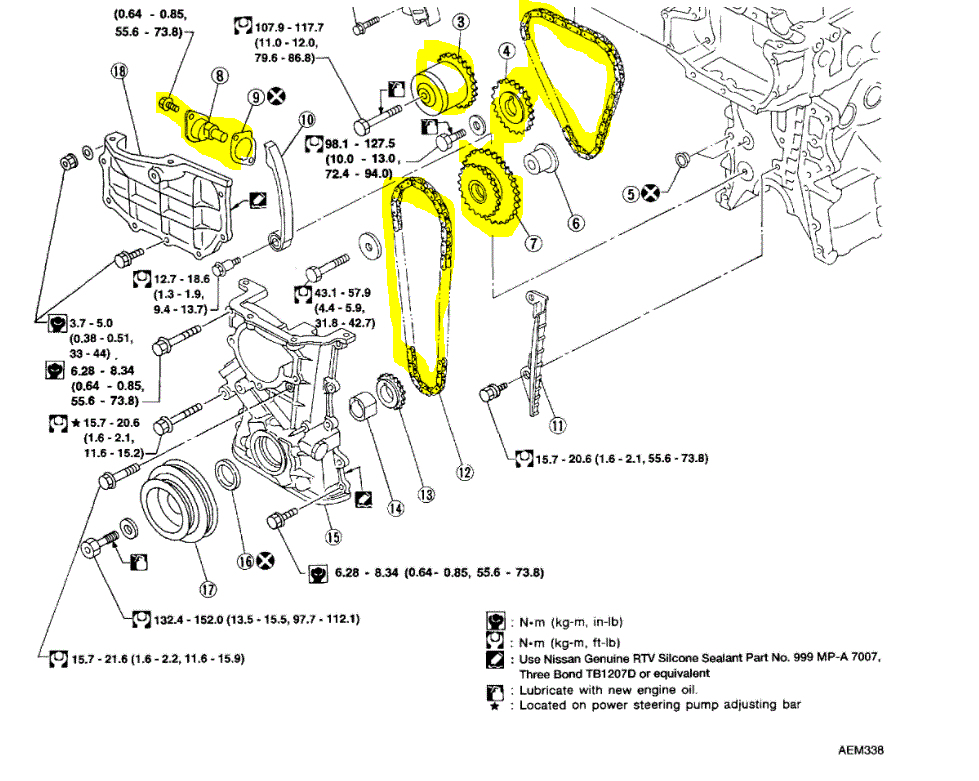

As far as the timing chain is concerned, there are two, an upper and a lower. I attached an exploded view of the chains. I highlighted the sprockets and chain tensioner for your reference. You can remove the cover to see if there is excessive play in either of the chains. Or, if possible, record it and upload it for me to hear and see how it's running (if running).
Also, if you haven't already, remove the accessory drive belts and check for excessive play, drag, or movement in any of the belt-driven pullies.
Let me know your thoughts and what you would like to try first.
