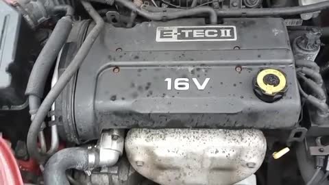

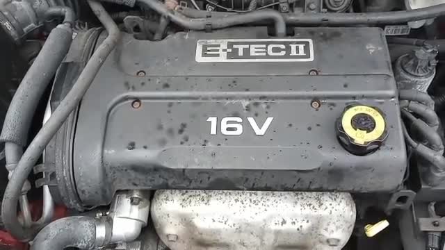

I have attached a video of the vehicle running with the noise from the valve cover. I appreciate your help.

If the oil light is on, don't drive it. Listening to the video, it sounds like the top end (cams/lifters) is getting little to no oil.

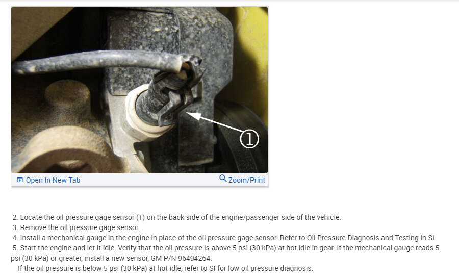

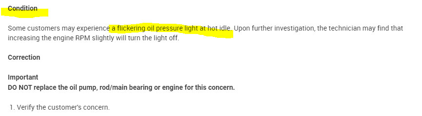

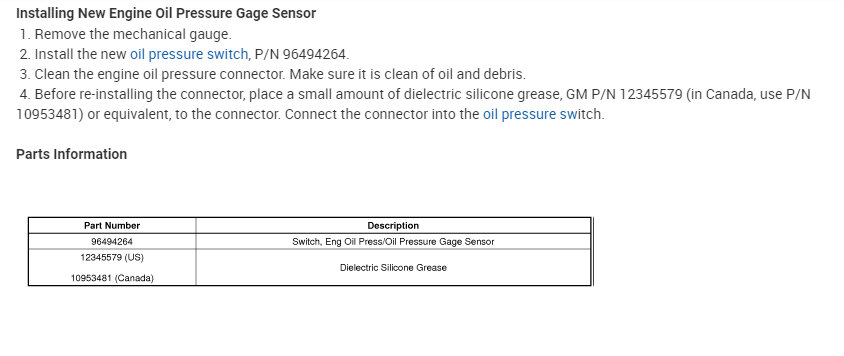

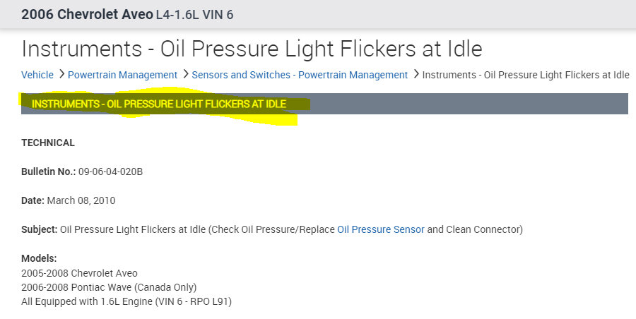

I mention that because they can develop a leak that will actually come through the electrical connector. That causes a pressure loss at the sensor itself and can be enough to turn the light on when you are at low RPMs.
Interestingly, I checked for the sensor location and found a service bulletin related to what you are experiencing. The recommendation is to replace the sensor/switch.
I attached the bulletin below for you to review. The location is described in the bulletin.
Let me know your thoughts.
See pics below. Note: They recommend testing pressure. I'm suggesting a replacement of the sensor. It is inexpensive and easy to replace. It is worth a try on this one.
