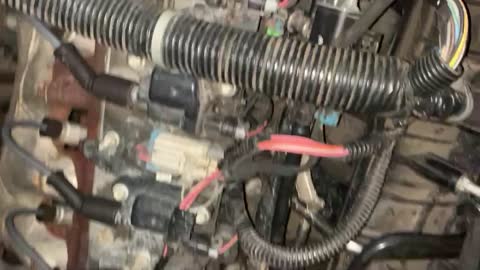

My oil pressure sensor went out so I removed the intake and changed it. after putting everything back together I started the vehicle and now it Idles rough and I have a ticking noise coming from my engine. Also a new code p0307 it has a misfire in 7. I took it back apart and cleaned my injector it’s running rough. any ideas what I could do next?

So I have fixed the problem it ended up being a misfire on all 8 cylinders and my fuel injectors was still dirty, but now I’m just left with a tick that came from nowhere. any ideas what that could be? I started driving it and the tick stops after I hit the speed limit but starts back up when I come to a stop again.

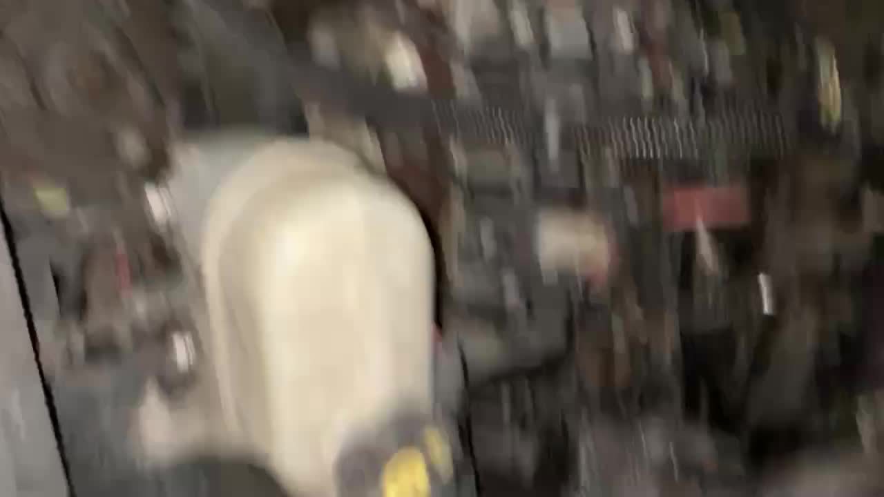

WILLIE HENSON
This is what I have:
Feb 21, 2021 at 10:43 AM
WILLIE HENSON
As you can hear from the video the tick stops once I get so far up on the RPMs then comes back as the RPMs goes back down.
Feb 21, 2021 at 10:45 AM
  • 110,248 POSTS
I hear it. Do me a favor. Take a long-handled screwdriver or even a piece of 2x4 and place it on one valve cover at a time to see if you can tell which side it is coming from. I am thinking it is a loose rocker arm.
