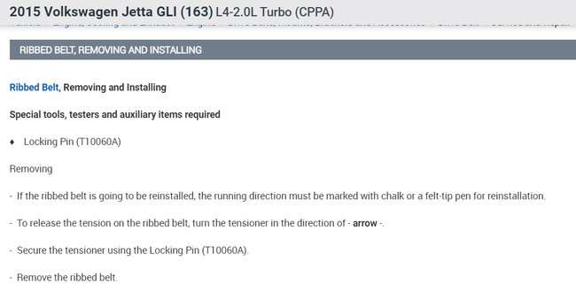

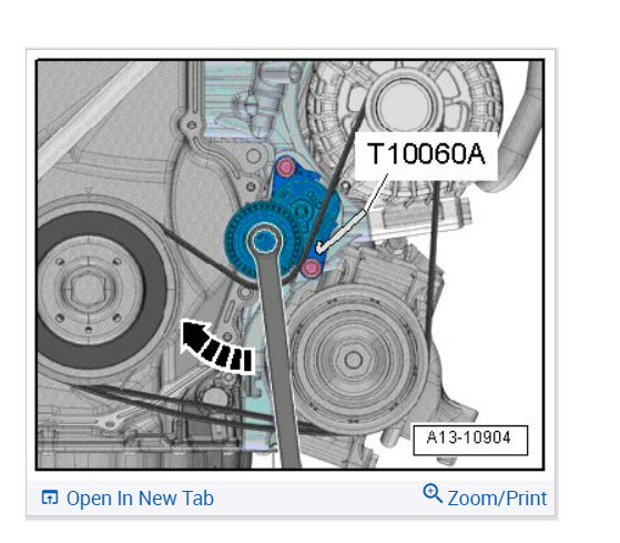

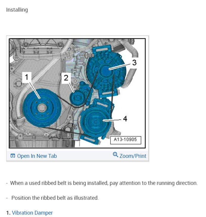

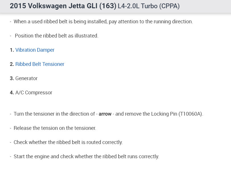

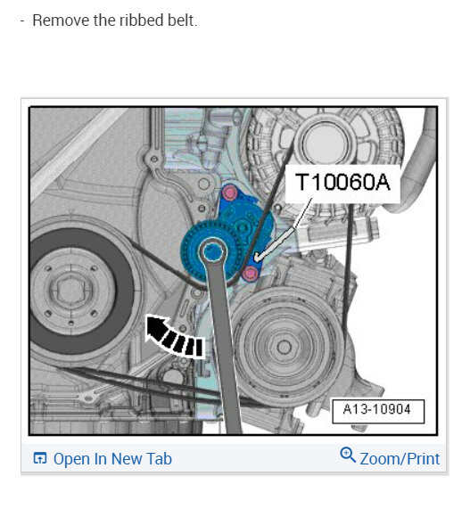

Thanks for the videos, they help. It sounds like one of the engine front accessories or idle pulley bearing has failed, but to help narrow the problem down, let's remove the serpentine belt and they start the engine for a second to see if the noise is gone. This will help us determine if the noise is external or internal to the engine. If the noise goes away spin the pulleys to see if one makes the noise. Check out the images (below). Please let us know what happens.
