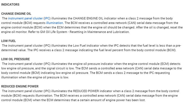

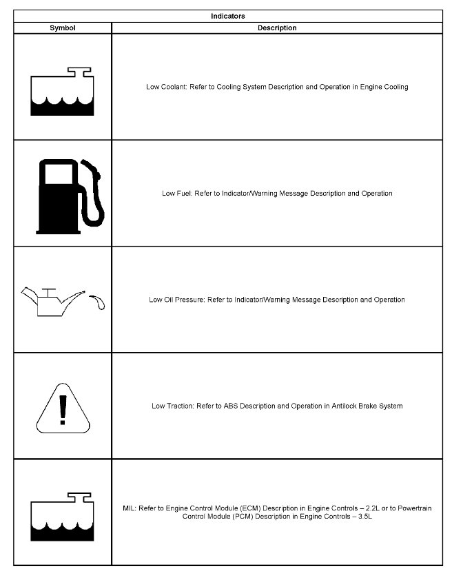

SCGRANTURISMO
  • 4,897 POSTS
Hello, this could be an equipment lubrication problem. I have included a list of the indicator lamps on your vehicle down below in the diagrams. If you could please go through them and let me know which one is illuminated, we can go from there. Also is your Malfunction Indicator Light (MIL) AKA "check engine" light illuminated? If so can you read the code(s) for me. If you are unsure on how to do that here is a link that describes how to do it:
Thanks,
Alex
2CarPros

TTHOMASON2419
It is the engine oil pressure light.
Feb 16, 2019 at 11:06 AM
TTHOMASON2419
The service engine light is not illuminated.

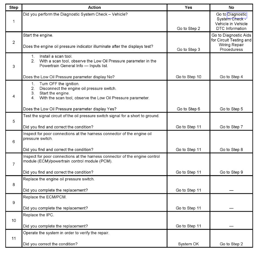

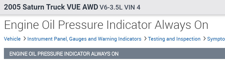

SCGRANTURISMO
  • 4,897 POSTS
Hello again,
I have included for you in the diagrams below a troubleshooting flowchart for you to go through. It should definitively find your vehicles problem. Let us know what you find out.
Thanks,
Alex
2CarPros
